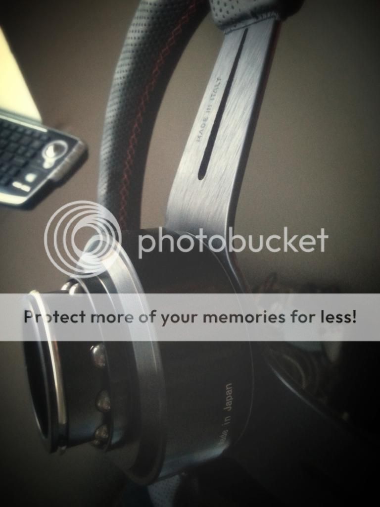

If it's like mine was, you literally have to force the horn retaining spring in, poke in the two 'sharp' ends of the spring into the boss, then using a small flathead screwdriver you lever and push the rounded part of the spring in. you have to be quite firm with the pressure to make it pop in. Scared me a bit as I thought I might damage it but I read up on it and that's the only way around it.
Cheers Parky, yeah I left it in the end and did some research I think I'm ok now. I've got the Work Bell Rapfix so you get loads of bits I wasn't sure about. There is a horn ring you have to leave out of you are using a Nardi.

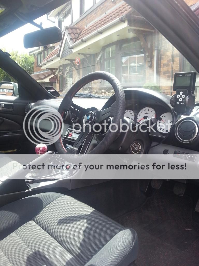

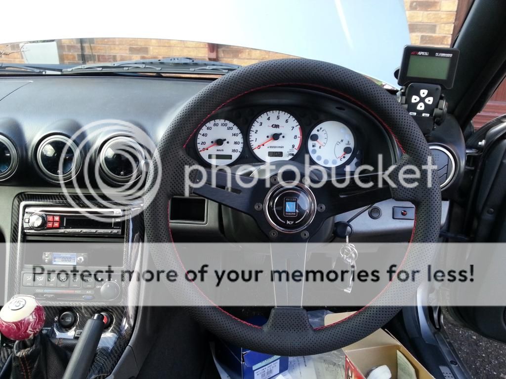

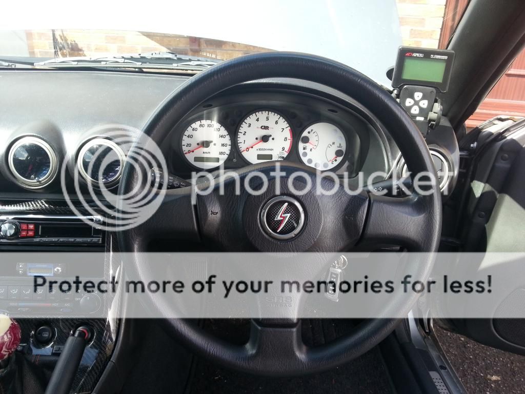

Finally fitted my Nardi and Works Bell Rapfix snap off hub. I don't normally work on my cars as I tend to break stuff when I do, so this was a moral victory for me as I fitted it without any issues.
Old wheel
Nardi

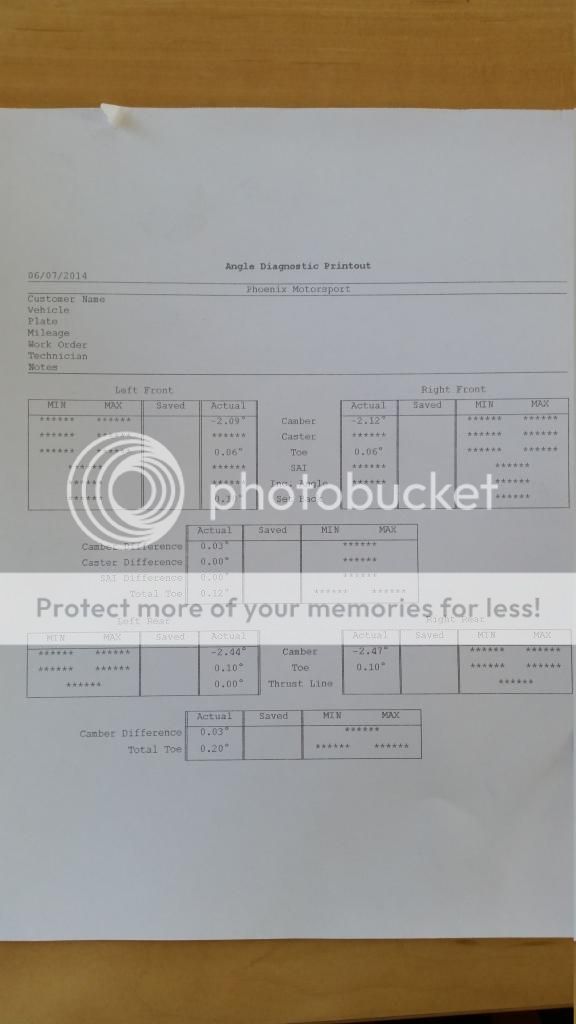

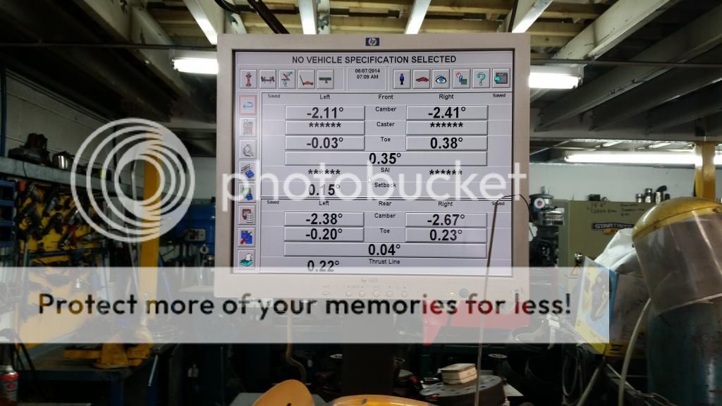

Going out on track at the weekend, so get my alignment checked and setup again. Haven't had it done for a few years so was worth it, as it was out on the rears.
How it started
All done
Ollie at Phoenix Motorsport is a great guy, really knows his stuff and has been setting up race cars for years, so he knows his stuff. :thumbs:

How come there's no front caster measurement mate? Atleast it is nice and straight now!
Humm not sure mate, I haven't got a clue really I just put it on the ramp and let him do his thing.

I really want that steering wheel!
