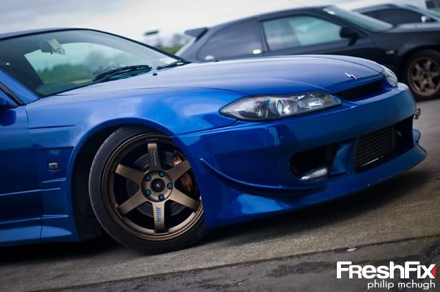

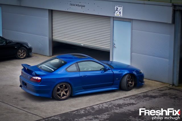

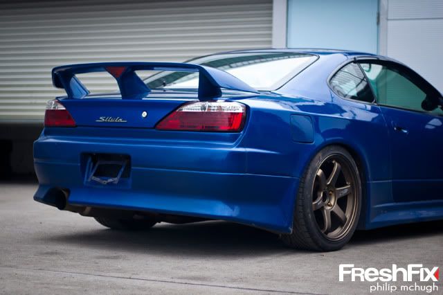

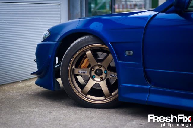

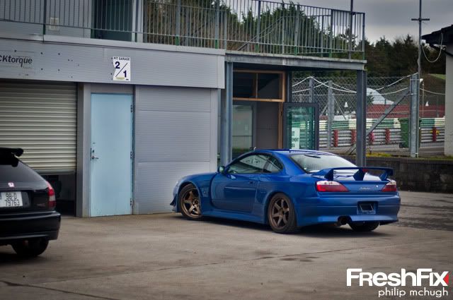

So clean! Love this thing!
What did you use to clean it up looks spotless?... hope you are well mate :)
Hey mate. Im very well over here.
Snow foamed it with demon wash, gave it a quick polish with Maguires next tech wax 2.0
The front light started to haze abit so gave it a quick polish too with the maguires too. It got rid of the haze :)
