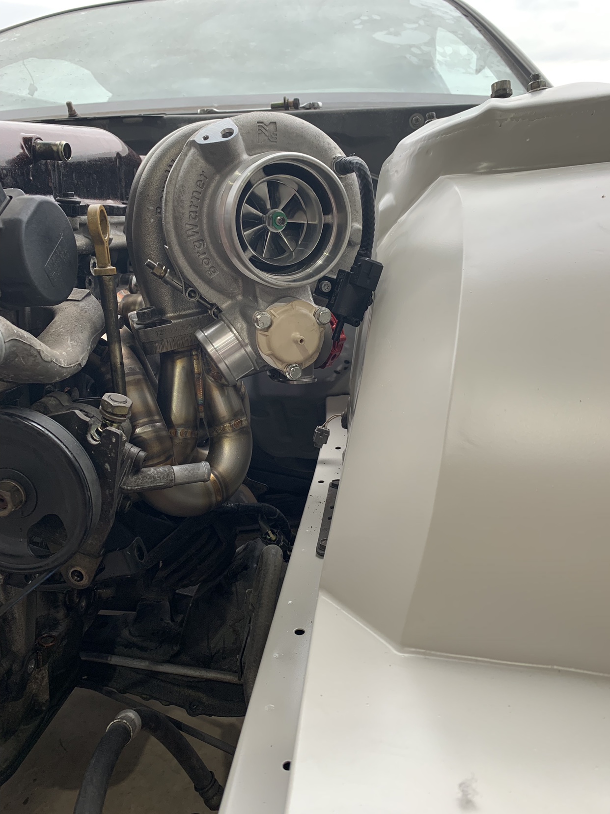

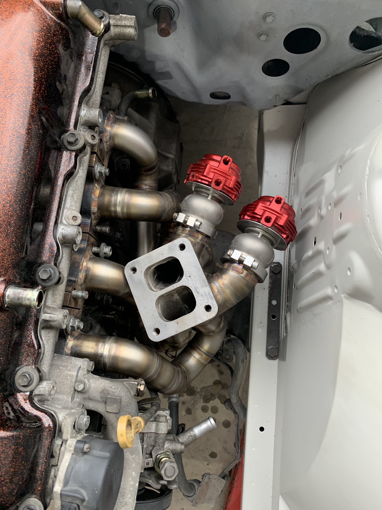

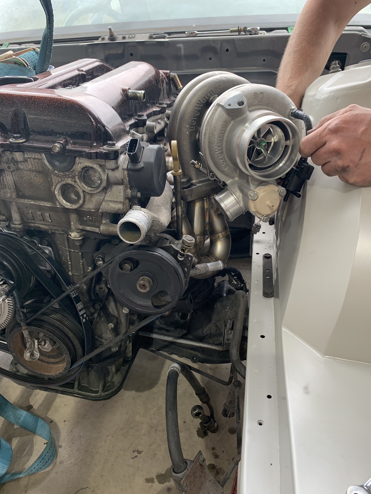

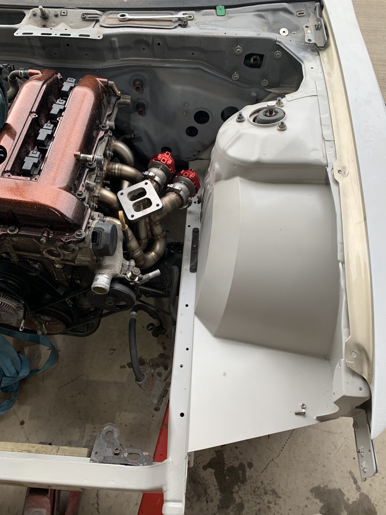

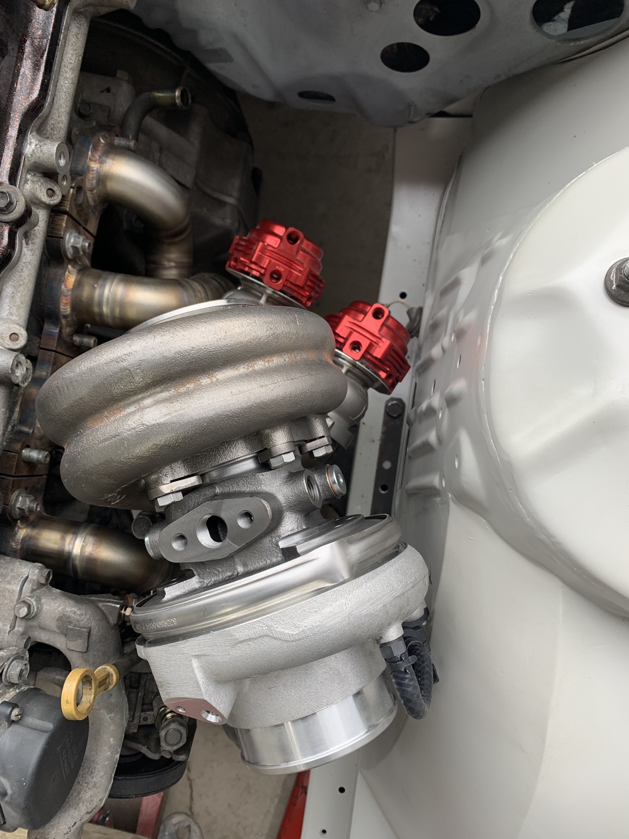

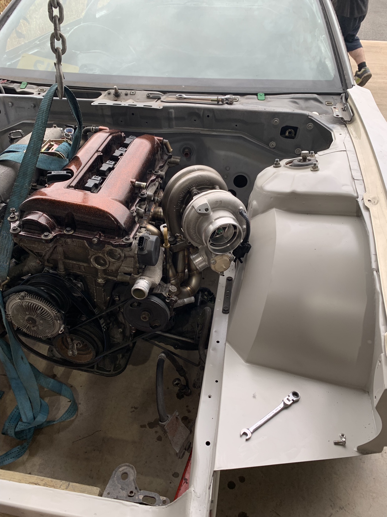

We had an sr at work this week after removing one to paint a bay , so we took the opportunity to test fit my turbo set up !
As I expected it takes up a lot of room and to get the inlet at the angle I want it looks like the tub will need notching to gain more clearance .

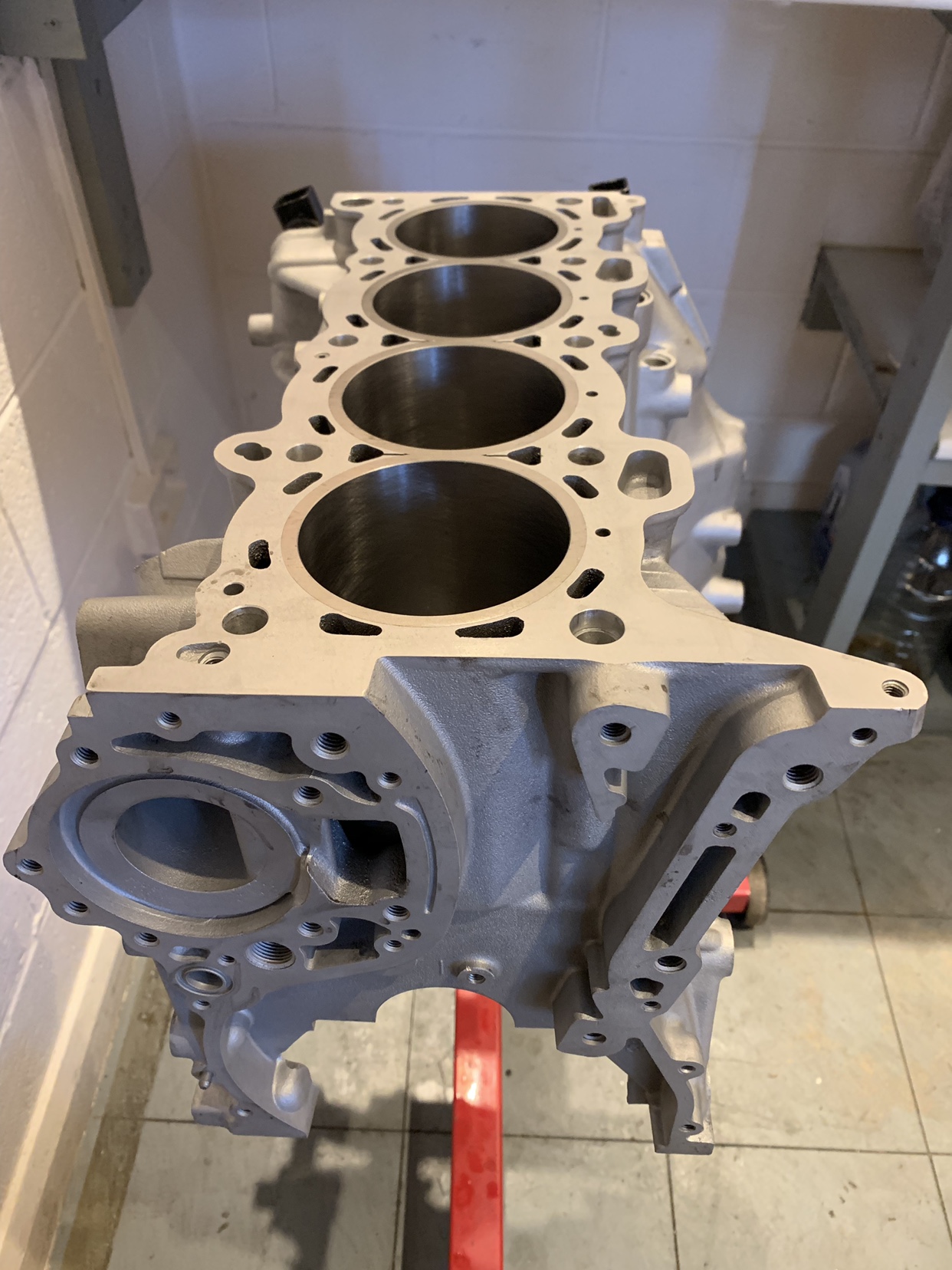

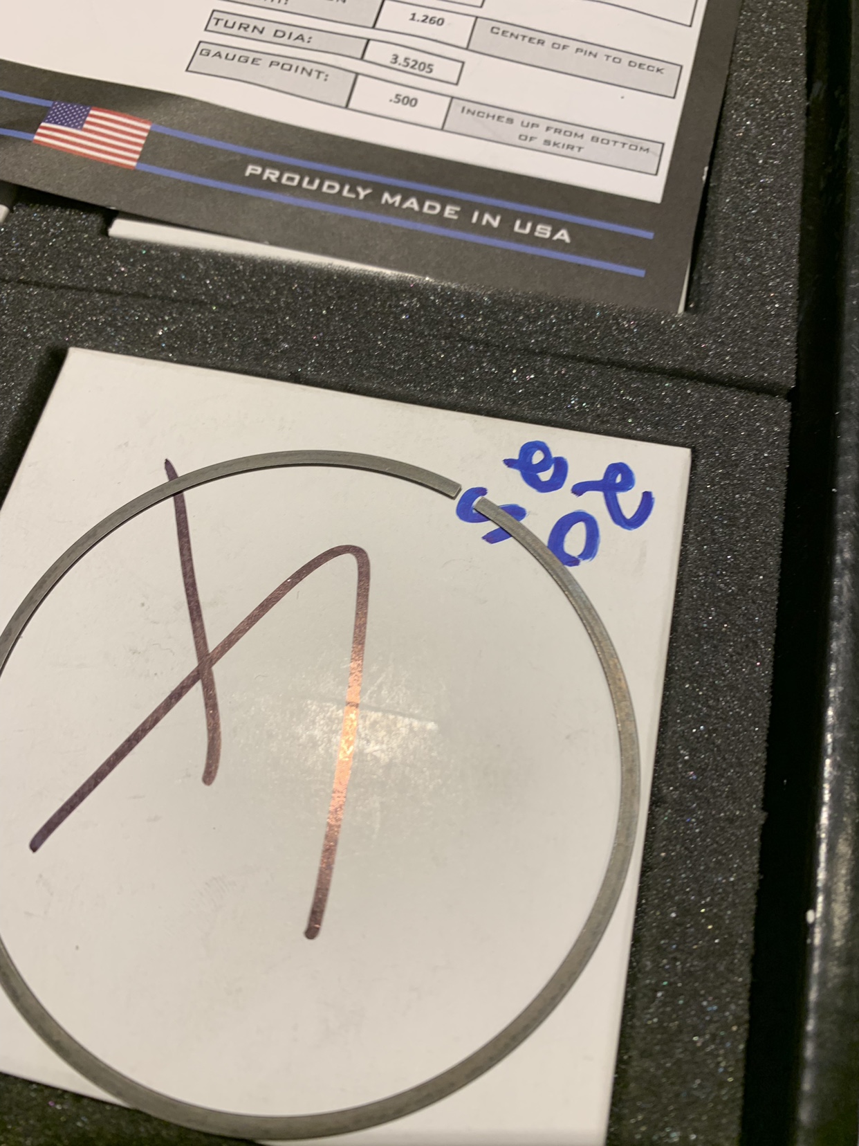

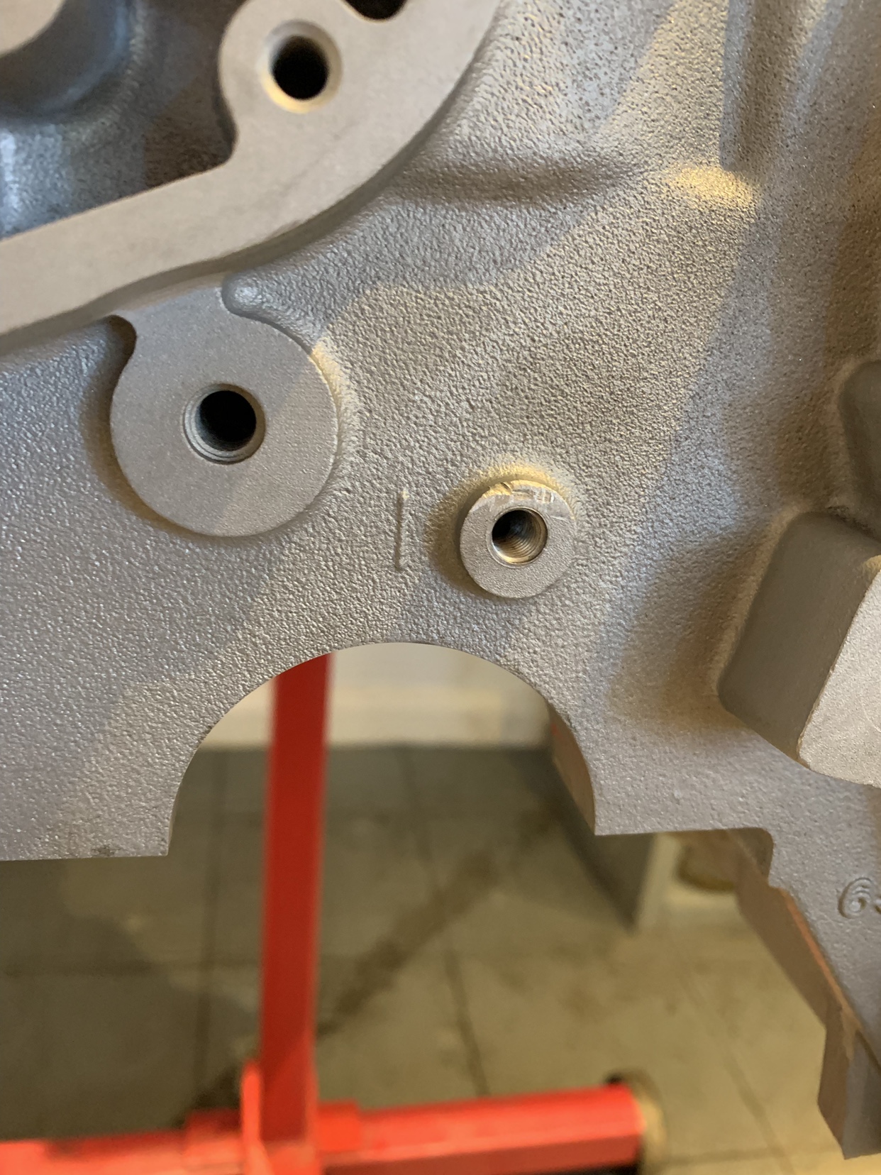

Finally been down to see my engine

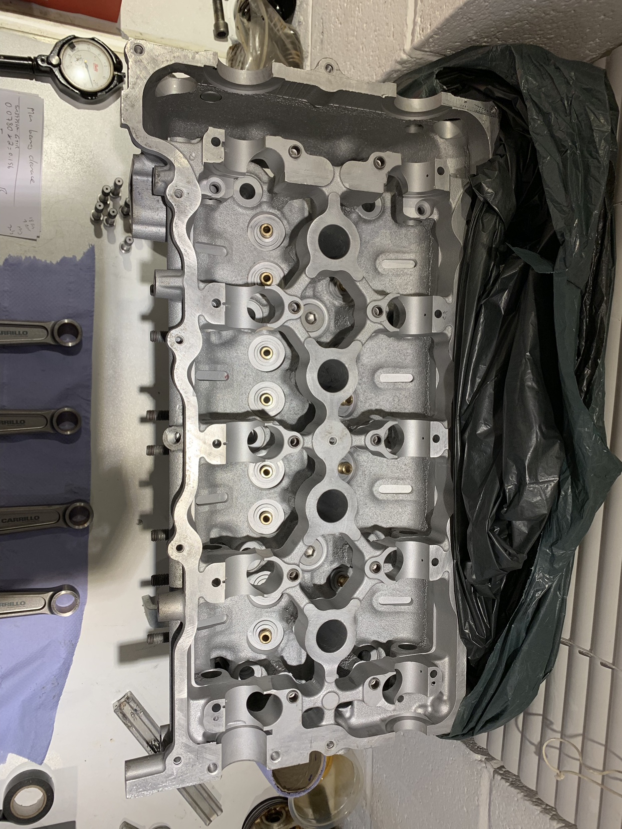

Not long now ! They have been sent the wrong carrs bolts twice now and one of the piston rings was damaged so they are just waiting on these parts now then can do final assembly at last !

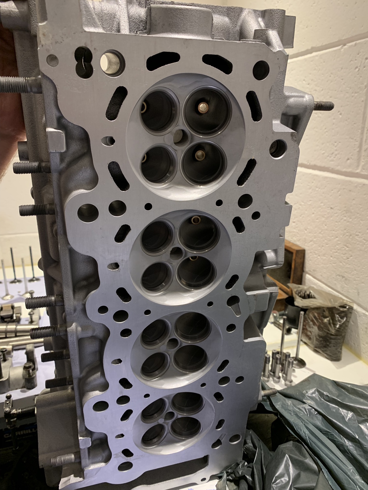

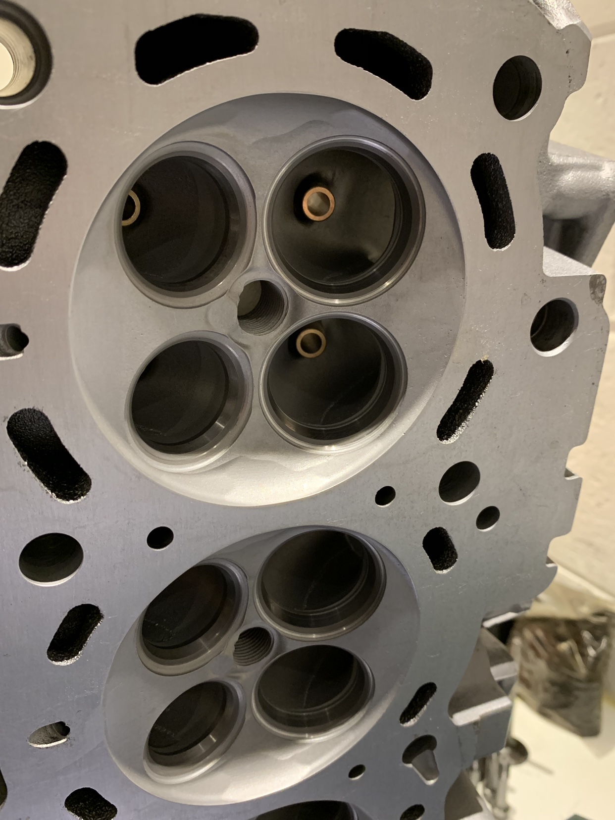

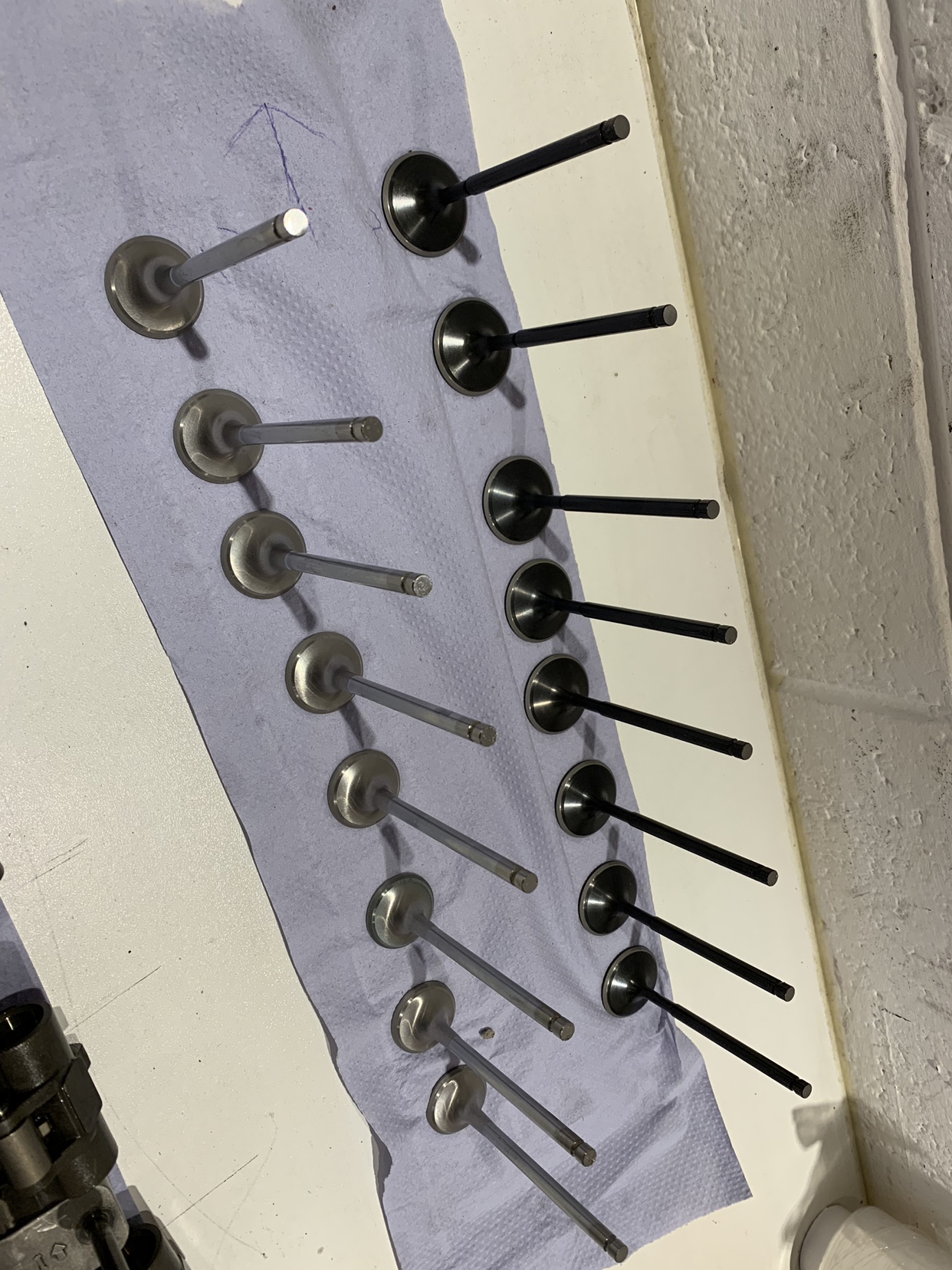

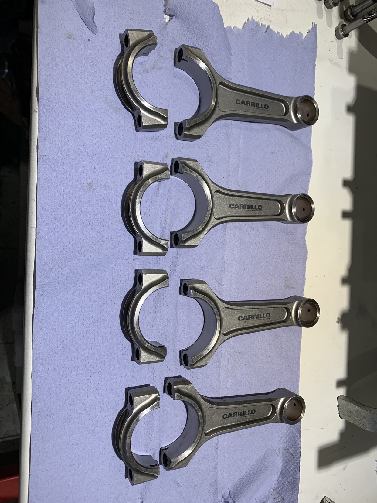

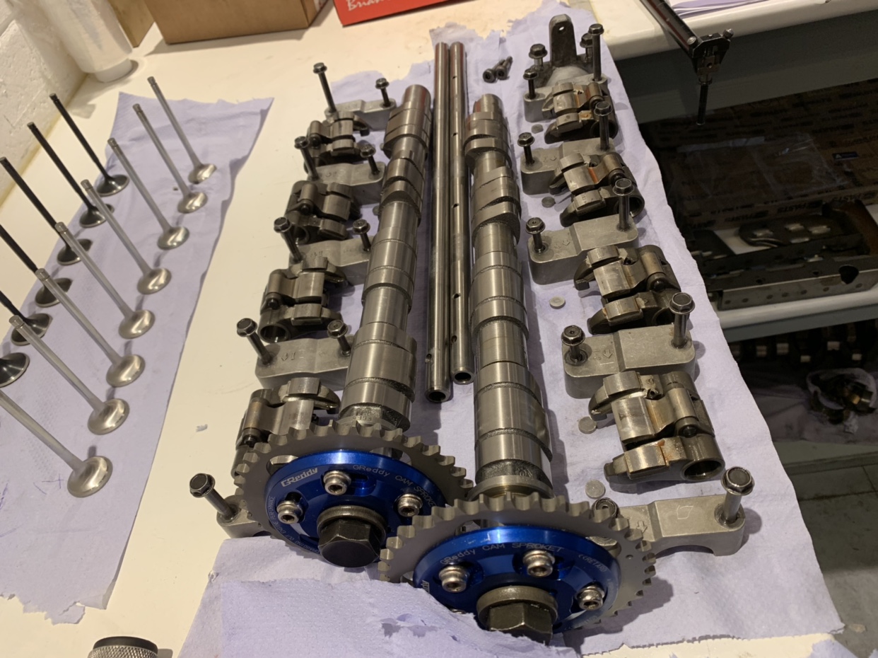

Some nice touches on this like cnc combustion chamber to remove the squish areas , threaded the front hole for the billet oil squirter . Larger bearings and crank ( believe they are using gtir but will confirm ) lots of other nice little touches I will do a full report once I collect the engine
Can see all the other parts too custom cams with greddy pulleys , supertech valves , guides and seals, Carrillo pro-super a roads , it’s going to be sweet

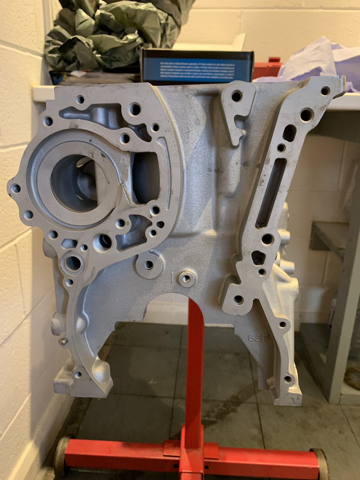

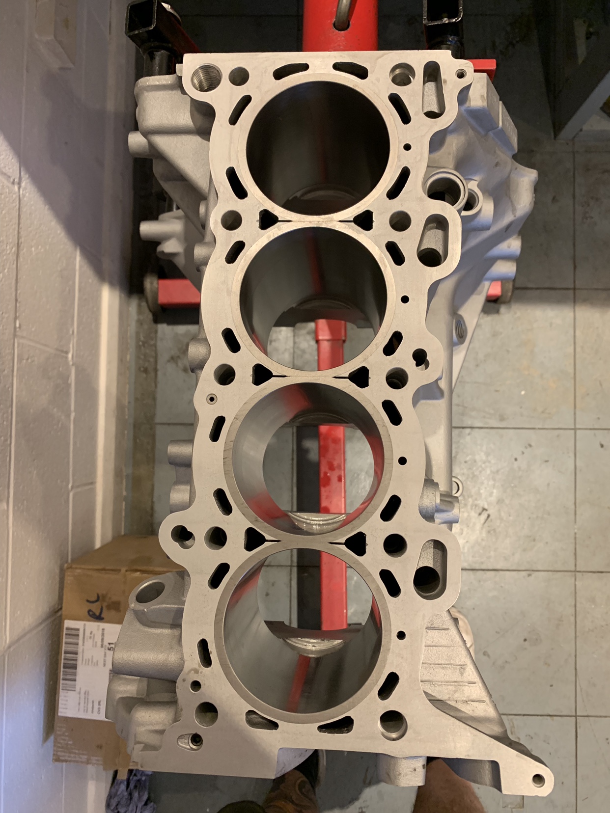

More pics of the engine . Waiting to get the ve oil pump back from the machine shop and I believe the engines pretty much done !

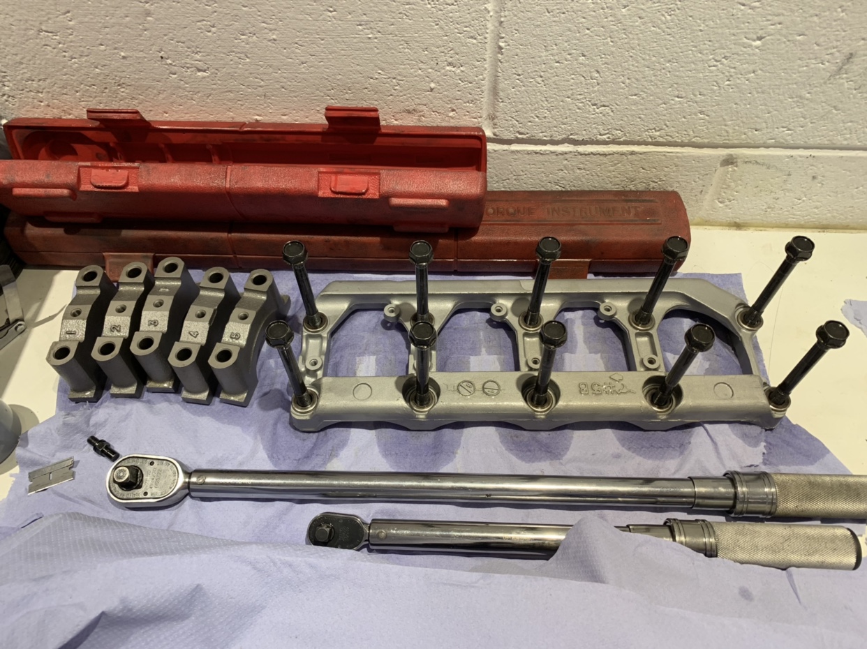

Well the engine is almost ready for collection ! Waiting on the cam cover gasket atm other than that just need to bolt the clutch and flywheel up and I can take it home at long last
