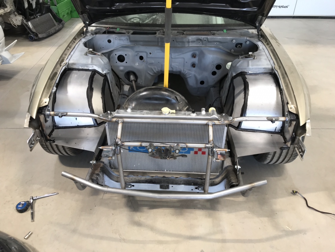

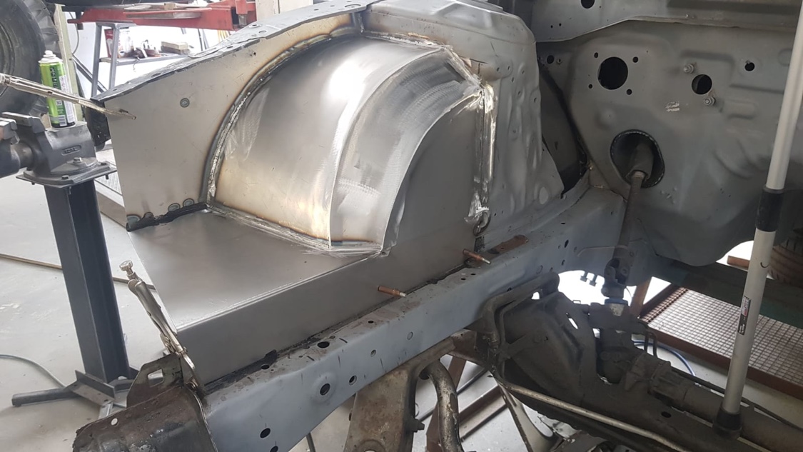

Been a while but finally have some updates on the front end .
Tubs are basically finished so it’s just the tube part left to do now .
I think it looks pretty sweet . Just hoping there’s enough clearance for my turbo
4,640
Almost there now , just need the frame tig welded and I will be getting the car back

Thats some nice work! are you going to fit a cover infant of the radiator to the bumper? or make one possibly? Either way still shaping up to be an immense car!
4,640
Cheers buddy .
The idea is to make a full slam panel that will have laser cut out logos for my business and for absolute customs , who did the metal work.

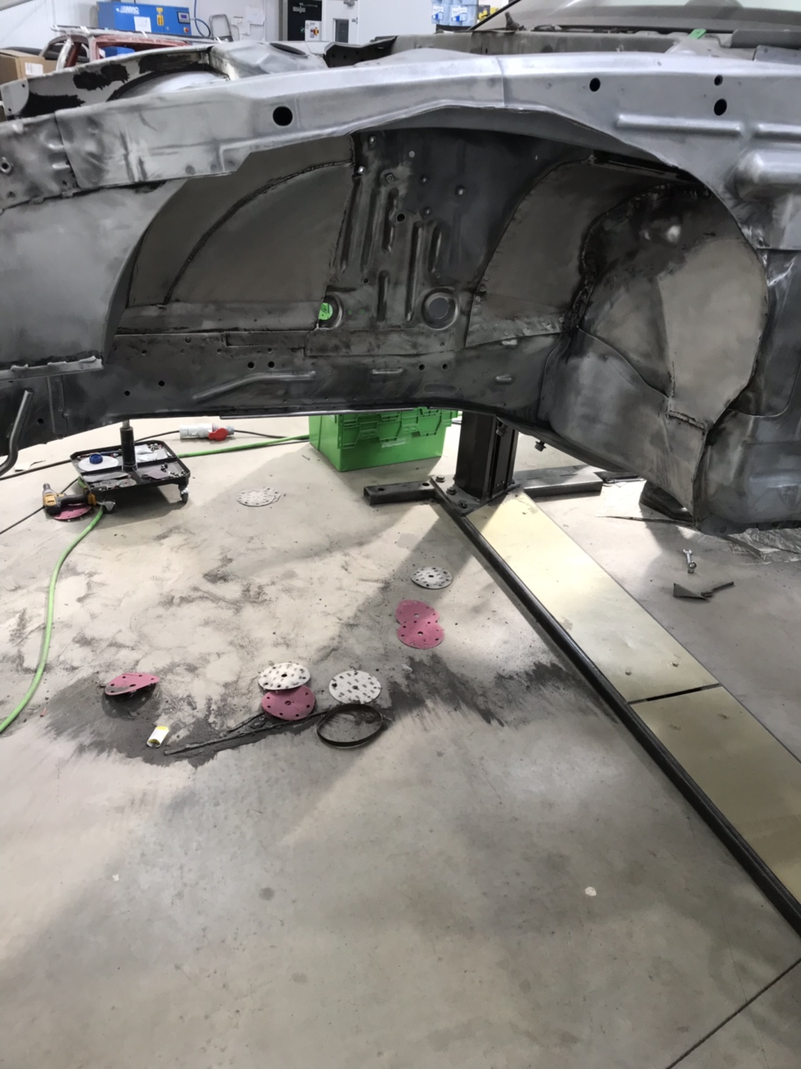

So now there are 3 of us I have changed my working hours to Monday-Friday so that I can spend Saturday on my own car .
This begun yesterday and as such we got a fair whack done on the car !
One of my lads came and helped me for the day , we cut out both rear arches for max clearance ( set with the car on bump stops ) decided to make the vertex rear fenders 10-15mm wider too so they will be 60-65mm now rather than 50 so that I can run less camber and or bigger rear tyres than the 275 I’m currently on ( need as much clearance as possible running 19x11 in the rear ) then welded up the new rear tub on the driver side .
I spent the day cleaning up all the metal in the front inner arches and engine bay getting ready to epoxy the metal so we can start filler work
There was some rust around the front radiator support so I removed this , treat all the rust and then seam welded it back on . While it was off we also removed the lip on the top of it and welded that flush so as to give more clearance for the intercooler.
Hopefully shouldn’t take more than a couple of months to get ready for paint if we crack on like this .
How it sits maxed out without the extra 10mm
And how we are planning to run , plenty more clearance , when it’s bonded will remove the inner lip
We boxed in the inner rear brace and then tied it back into the new tub to keep the strength and rigidity in the shell
Front end tidied up pretty nice
