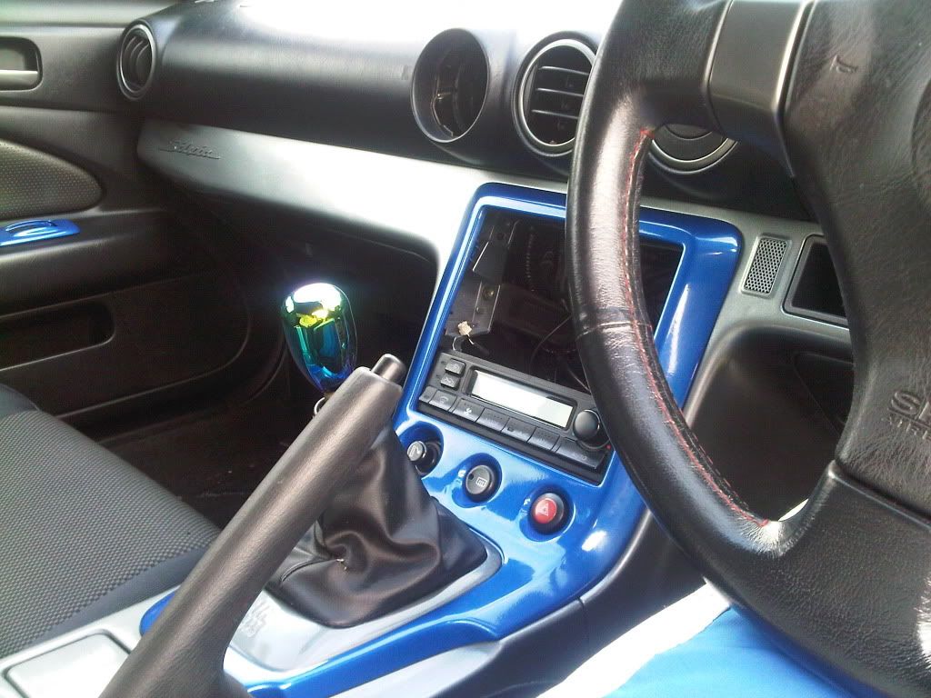

Yeah looks nice , the bulb I had as a fog in the reverse was so faded I have just left it in there as a reverse bulb lol there are some pics in this thread somewhere but am sure I can dig a pic out for you just need to get on the CPU to upload some stuff
4,643
pics as promised
Also lengthened the cable on my turbo timer and moved it as i didnt like it being on top of the steering column,looked crap imo so just shifted it underneath the dash as its an auto timer i dont really need to mess around with it anyways
and for luke,here is how my dash used to look ,was body colour grey with bayside blue

jesus i struggled to see the fog at first i really like it really effective and doesn't ruin the look and iam loving the blue thanks for the pictures mate, the car looks mint as with all the mods really nice mate, umm iam starting to think the first picture of the dash in pink i would like mine like that in the blue and maybe black stereo surround

cheers man,that's why i chose this fog as it's subtle and fits in with the back end nicely,just need to get my smooth boot painted and back on then i will be happy.
I think the blue dash would look nice mate.......

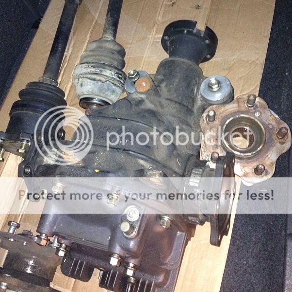

not very good pics but am very busy atm plus i think i broke something on my way home the other day
nice loud snap/clang/cracking bang lmao i am hoping its just a shaft as i have replacements ha ha ha will be getting the subframe soon then can crack on,
As you ca see is one hefty ass diff! even stronger shafts/hubcarriers so hopefully no more broken diffs !!!! also being 1.5 way i should get some awesome grip now

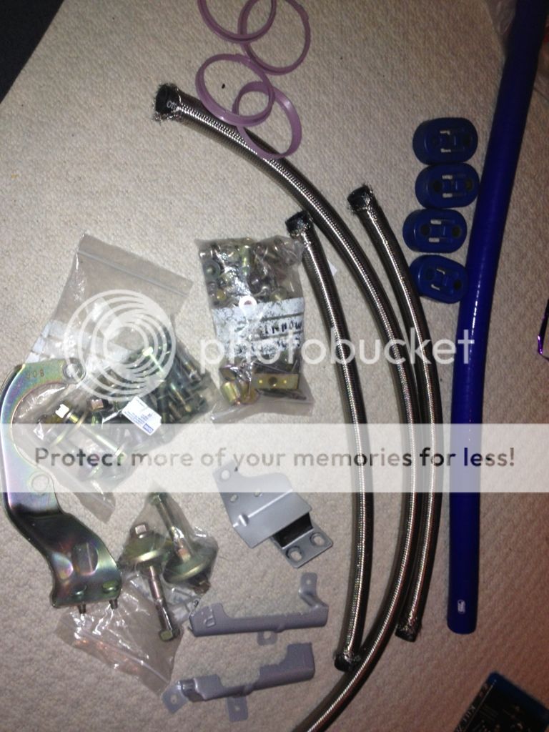

courtesy of Deans15 zinc treated bolts for all suspension/subframe parts including arb drop links,uprated exhuast hangers and a samco hose for relocating my re circ when my new fmic pipework is on.

Oooooh, shiney! Did you have to take all your bolts off to get shiney-ised or are these replacement ones?

These are replacements mate, deans15 off here had pretty much a full set leftover as he had 2 sets coated just in case ,so I bought them off him may be missing a couple but most are there

Well worth doing mate ;) not really expensive to do either

another driveshaft haha sounds like you have some fun in your car lol, they sound like good mods and its always good fun putting new mods on the car :nod:, sorry to sound dumb but what will the subframe help with and ive thought bout changing my diff before but don't really know what the benefits are

Yeah think this is my 4th diff lmao I drive my car pretty hard, benefits of swapping to this diff is shorter ratio 4.11 so is quicker through the revs and also obviously being a 1.5 way is much more grippy and predictable to handle when it breaks loose. As for the subframe , i will be replacing all the bushes with poly bushes to firm up the rear end and going to have it powdercoated , that along with the zinc coated bolts etc should be pretty well future proofed .

ah very interesting with the diff and see why you want the subframe now it will all help with grip in line with you fitting the diff thanks for the info mate always good to bear in mind for future mods, so even though you smashed the drive shaft could you still drive it home, iam guessing you smashed bearings meaning you could get it home but slowly haha, what sort of power were you putting though the standard drive shaft

I still got home yeah, happened just round the corner they are skyline shafts I am running too which are meant to be stronger than the 15 shafts, guess I have just been unlucky so far, this diff is solid though no slack at all so should be tight as fook lol glad to help If i can :D the subframe will come in handy because I can paint and bush it off the car then in theory i can mount the diff and new rear brake set up to the spare frame and raise it all onto the car in one hit should save me some messing around!
