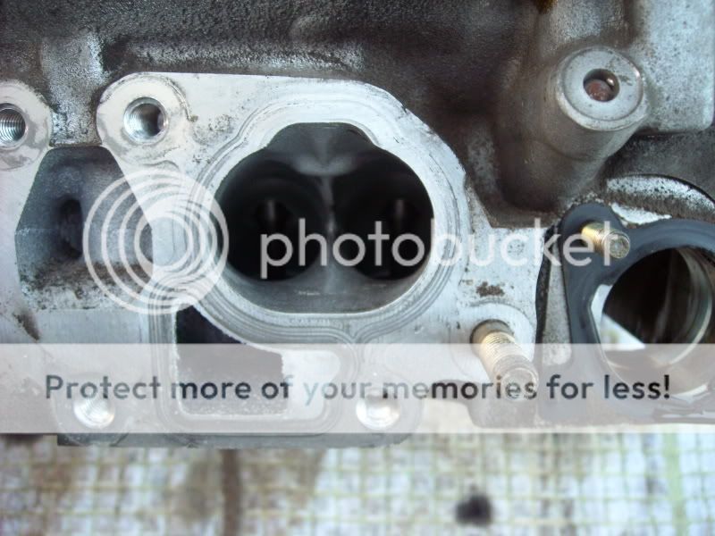

cheers for that ray, confirms mine has definitly had some headwork done, im curious to find out what cams are in it.....
8 May 2006
874
Dublin , Ireland
hahaha let me know too im interested in some head work myself.
your valves look very clean too.mine are very grubby looking.
well if there is head work done you have saved some money there. so the car should be up and running no time.:thumbs:

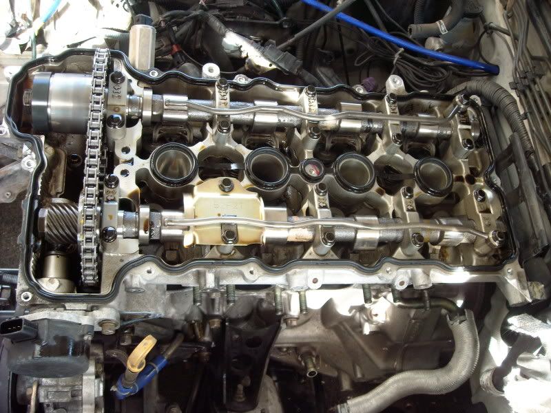

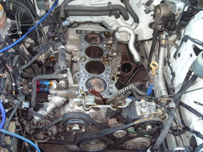

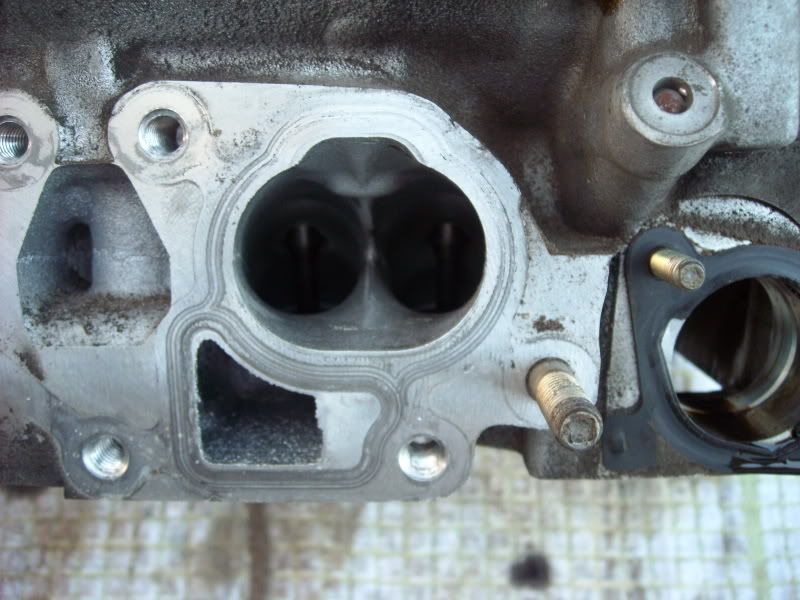

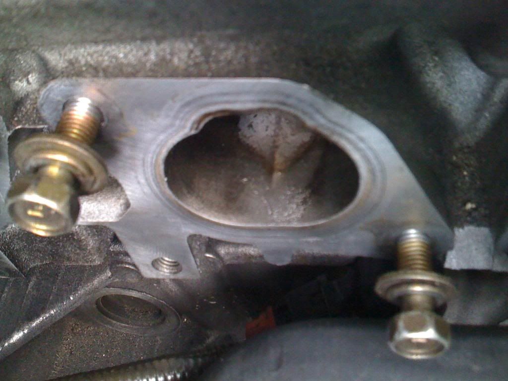

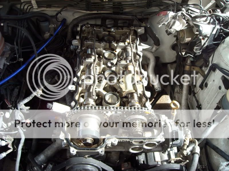

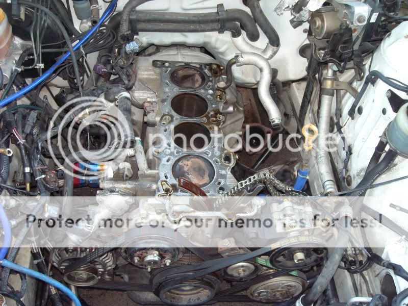

Got the head off, cant believe how clean it is....

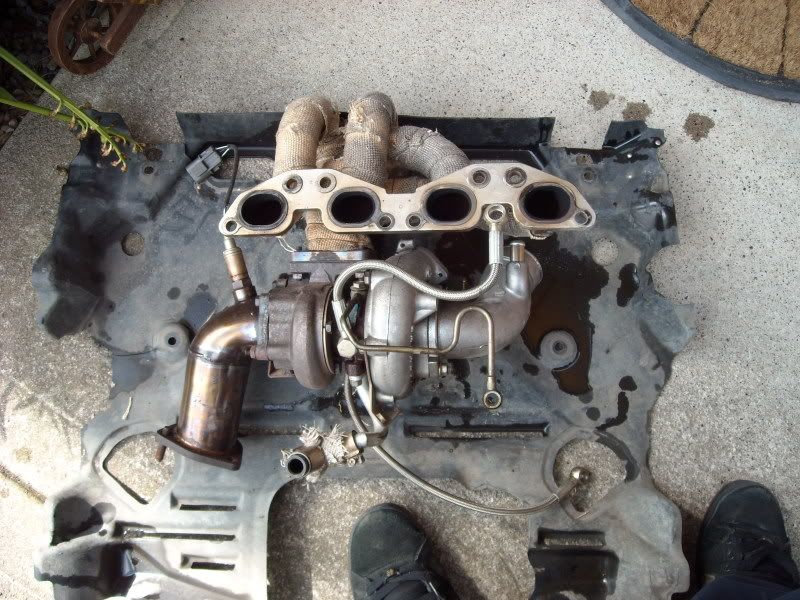

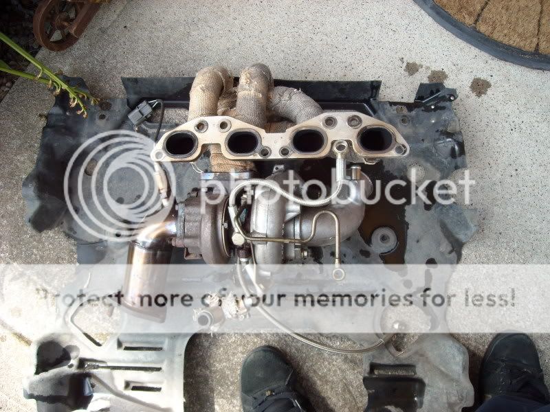

Turbo/mani/elbow

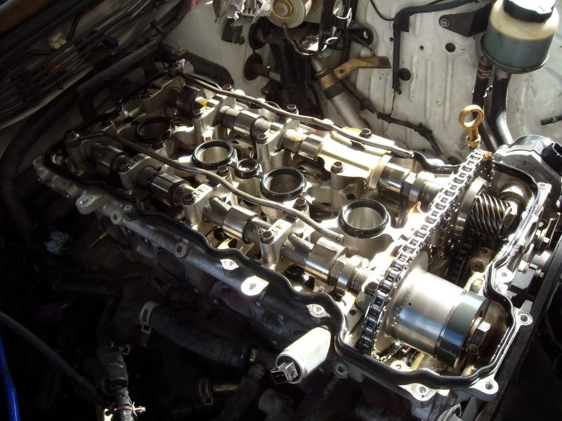

head

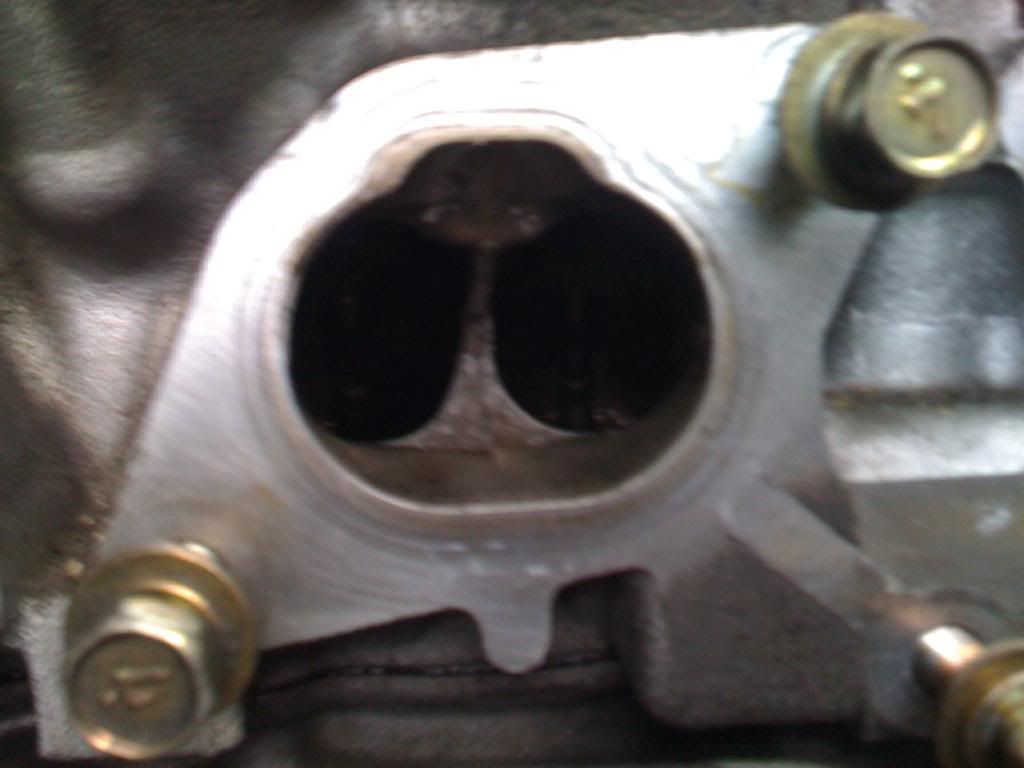

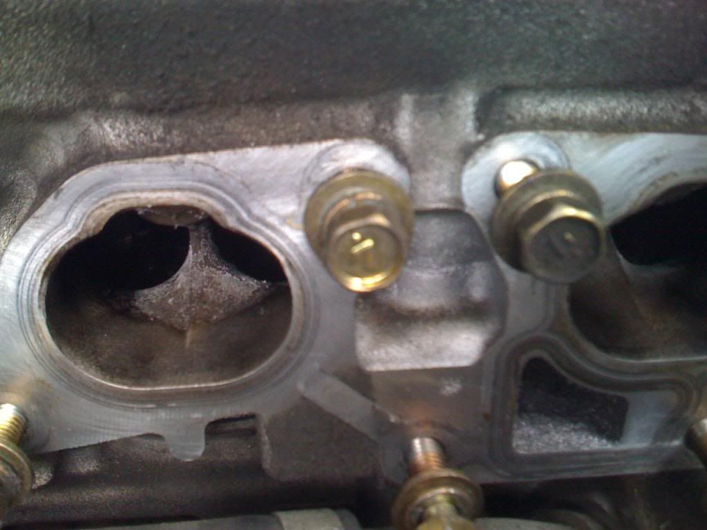

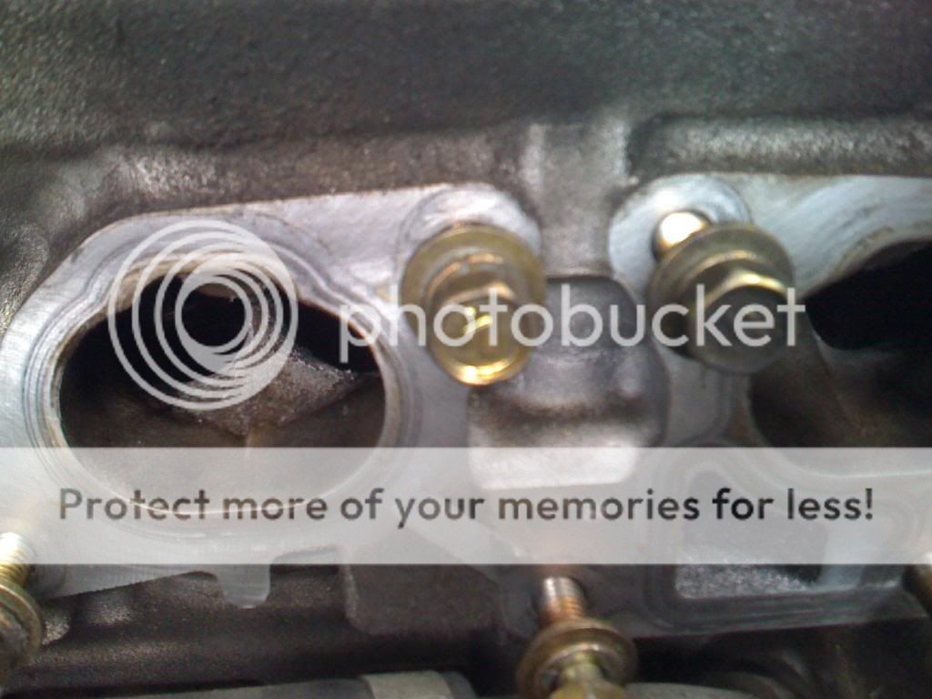

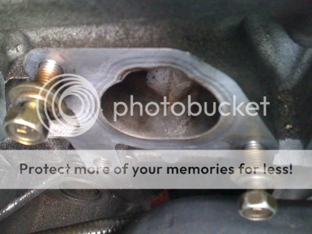

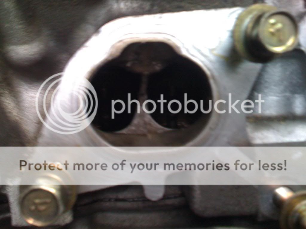

looking at the pic of your intake ports looks like there not ported or polished.
looks very much like a casted finish. but it is incredibly clean.
ported and polish be more like grinding marks.

ye on closer inspection thyre not machined but i do see some tool marks on the inside. Ill find out what martin makes of it during the week :)
