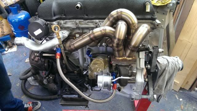

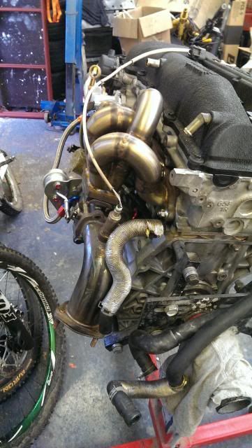

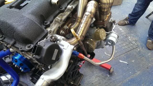

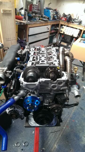

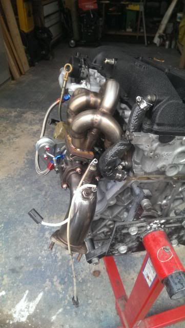

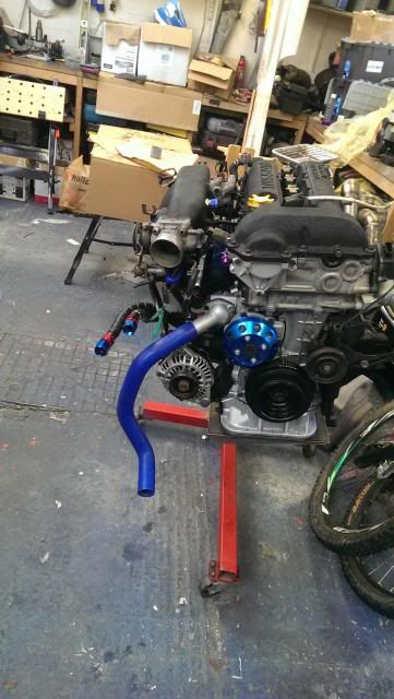

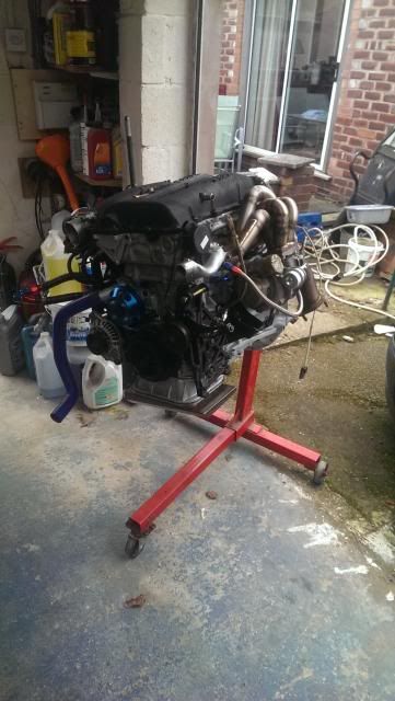

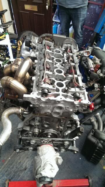

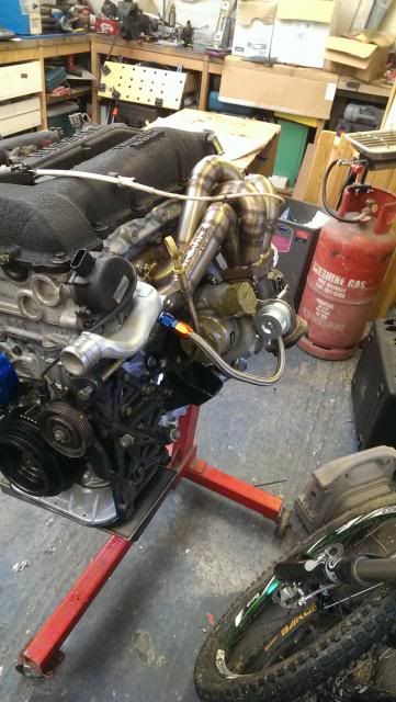

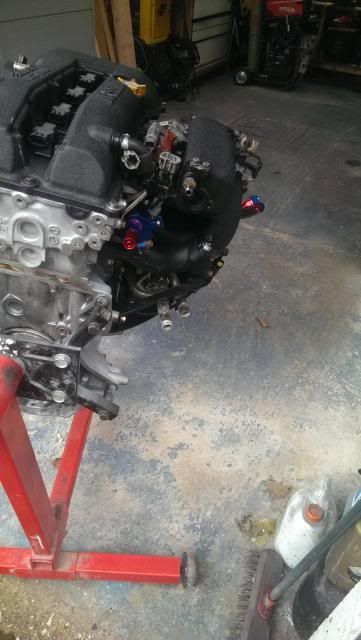

well shes built... managed to get some time on the engine last weekend and got quite a lot done... still need / want to paint a few parts to bring it up to spec but big step forward and can now look into getting it in the car :)
will get some close up pics of the turbo and stuff before I put it in...

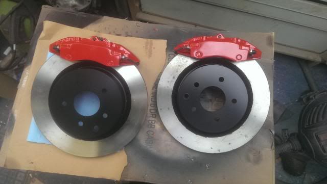

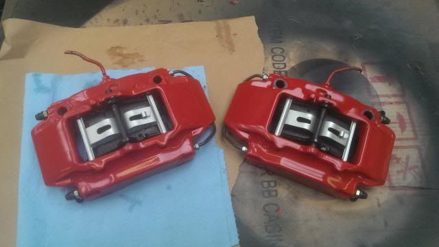

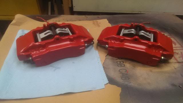

well since the weather hasn't been great this weekend up north I've put off putting my engine but did decide that the rear caliper needed repainting so spent the time doing that:
need to find a dry weekend now to put the engine in

Calipers look sweet! As does that manifold! :nod:

cheers gents need to get them on the car now.. need to get the brackets mocked up for the rear

They look huge for rears man! What are they?
there off the back of Porsche Boxter S and running 350Z discs :) after doing some initial calcs they we will be pretty well matched to the car and the front set up... cant wait to try them now :)

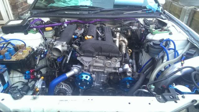

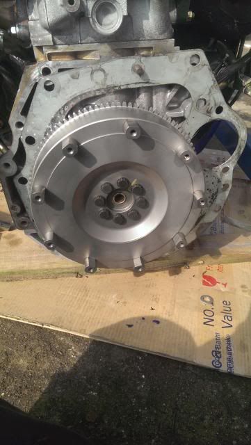

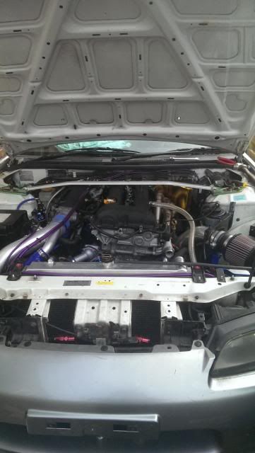

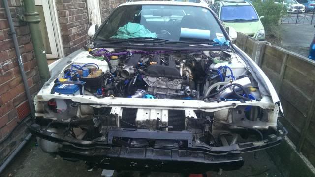

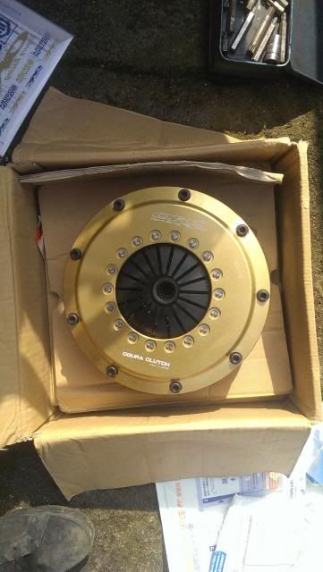

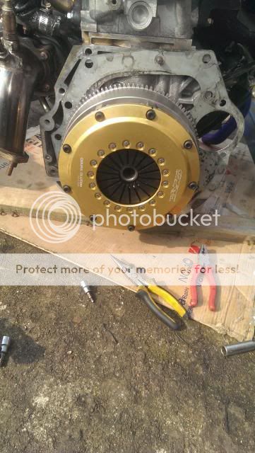

well buddy its been a long weekend but shes in !!!! some pictures of the weekend progress:
before the hard work to get it in:

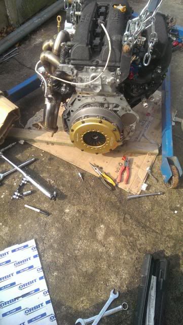

clutch on:

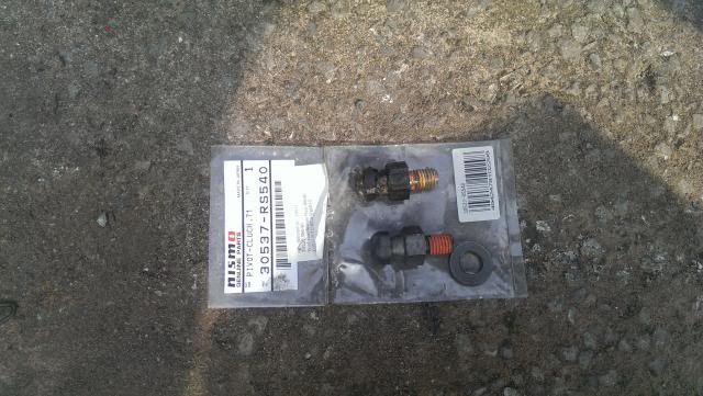

Nismo Pivot in place

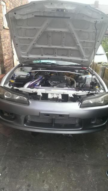

and how it looked at the end of saturday:
and at the end of Sunday
well its a big chunk closer now !
4,640
Nice one mate!!! Looking awesome!

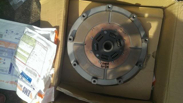

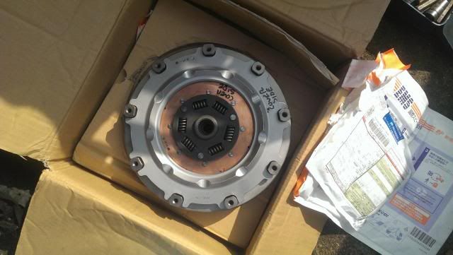

Was looking at those clutches myself yesterday ha ha which did you go for? They have a lot to choose from.
Not a million miles away from first start up then :D and just in time for the nice weather too

cheers mate, i need to get some better pictures up to some point tho.... i went for the 409d with the spring plate but not the one "slient" flywheel... its also got the "copper mix" style clutch disc.by all accounts they drive like stock pretty much just with a little more noise...
yea got a long weekend coming up so hoping i can get it fired up and do some checking .... fun times ahead.. hopefully get it on the road in time for summer !

Ah sweet sounds good mate! I'm weighing up one of these or a nismo dual coppermix atm as it can take 600ft/lb lol just incase I change the goalposts in the future ha ha
