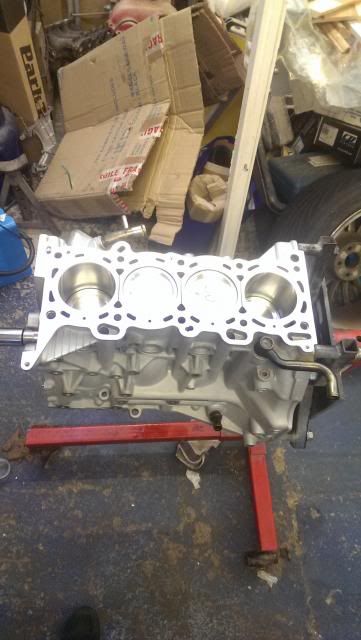

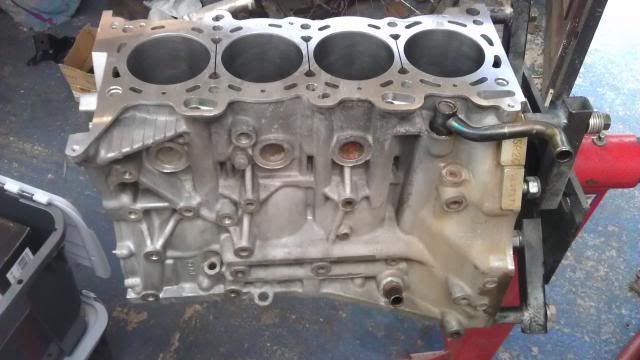

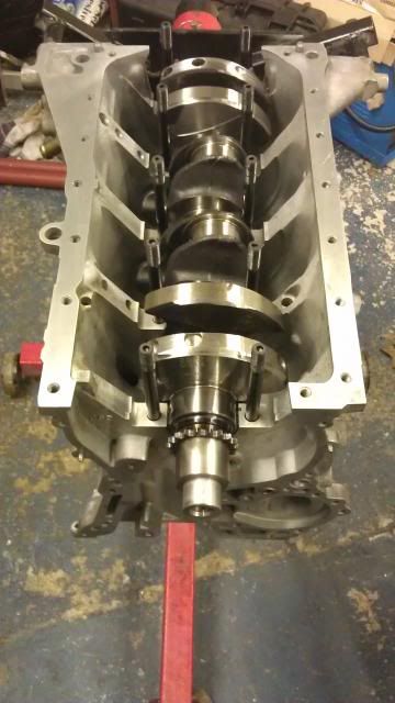

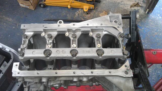

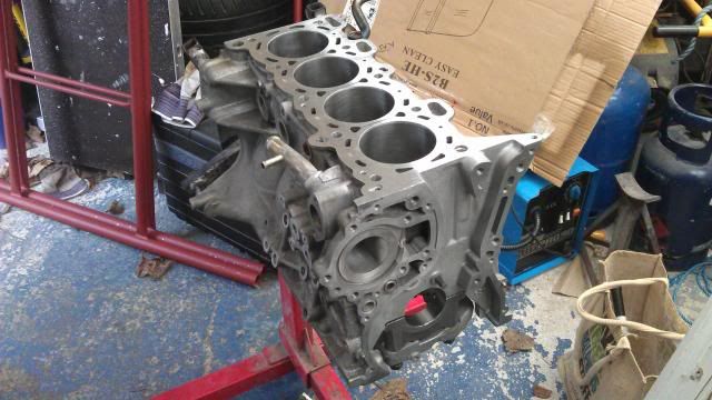

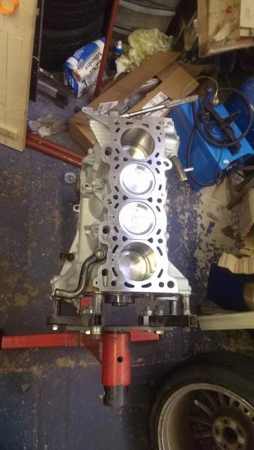

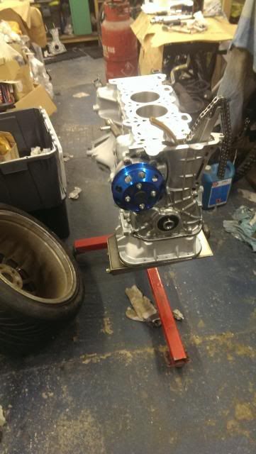

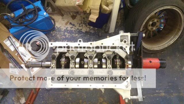

well got my block back from the machine shop on Saturday but then had to leave for the south not long after so couldn't get much done really. got the main studs in and the crank but that's about it.. just some quick snaps... the machine shop has done an excellent job..
not much of an update really

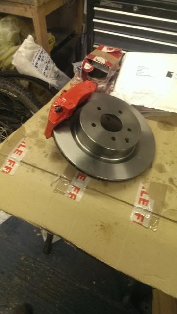

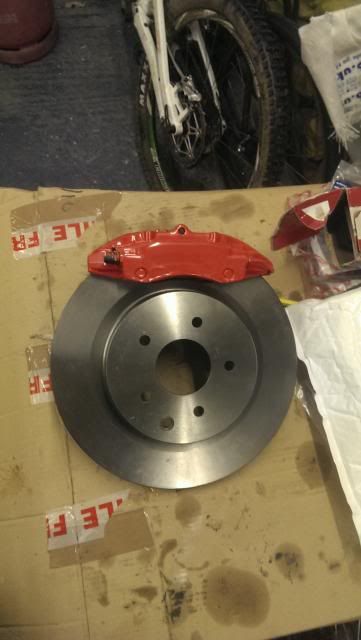

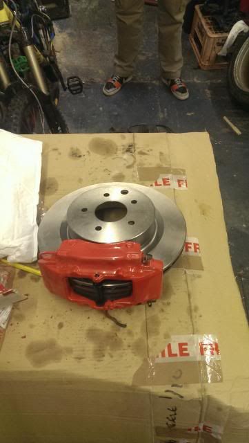

well got back home today and my stuff had turned up so I could see if the rear brakes where going to work with the discs.... so far so good from the looks of it:
should be able to get cracking with the engine this week now so hopefully more updates to follow.

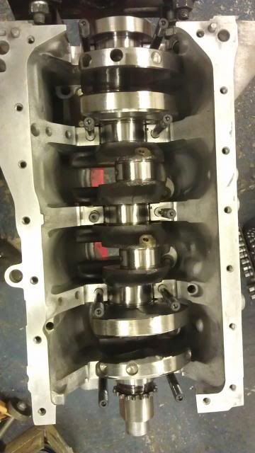

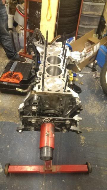

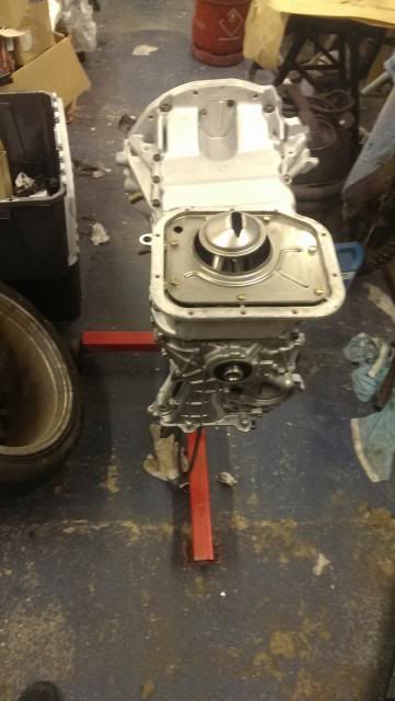

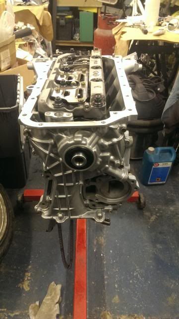

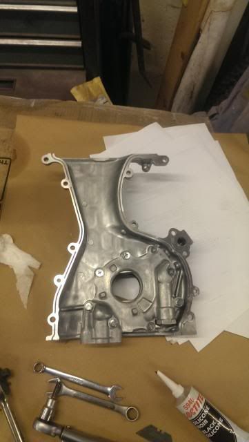

finally got a chance to get some time on the engine today. Got the bottom end built which made me a little happier:

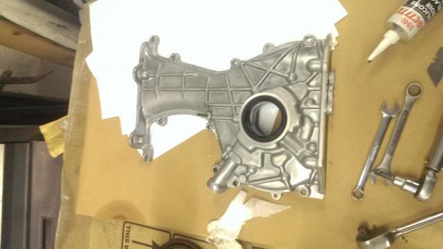

also opted for an orbit oil pump / front cover as they are cheaper than OEM and the pump gears are not made from sintered cheese. really nice bit of kit just like OEM

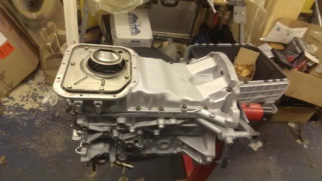

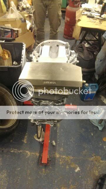

then got the rest built up with the oil pan extra.

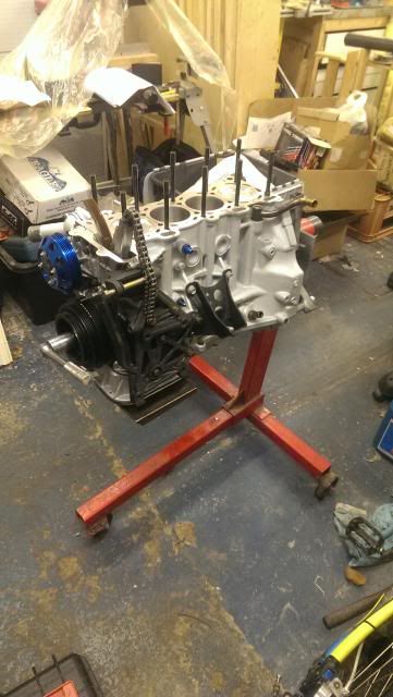

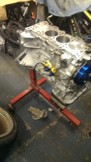

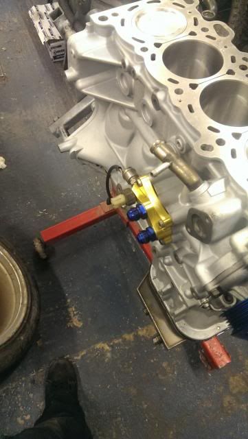

Tomei N2 oil block fitted:

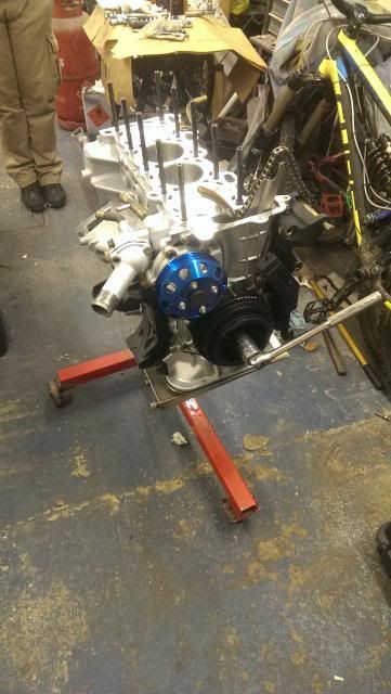

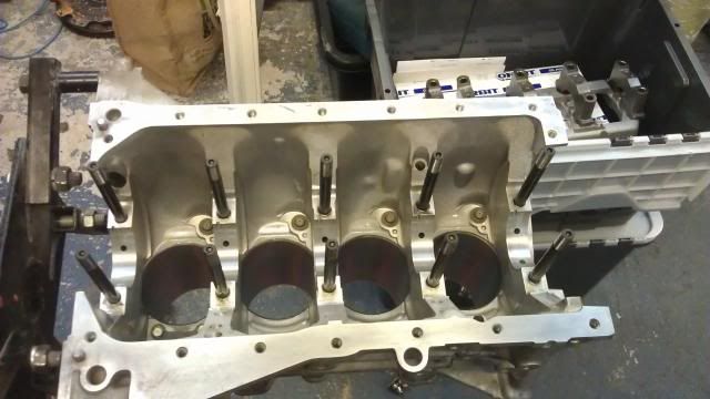

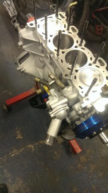

then got the head studs in:

Very nice buddy, coming together !
Is that the oil pump that mazworx sell?
Is a comprehensive build you are doing , defo making me want to go all out on mine now , keep at it :D
