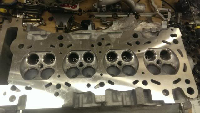

the machine was fairly expensive but i got a lot done, i used these guys who are exceptionally good and have a very good rep http://www.ricwood.com/. i got the following done:
rebore with torque plate
top deck machined flat
full dynamic balance with clutch etc
valve seats re-cut and lapped
NAPREC valve guides fitted
head deck for flatness
full clean
came to just shy of 900£ but the quality of work is second to none.....

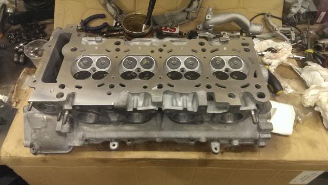

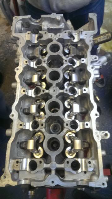

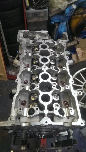

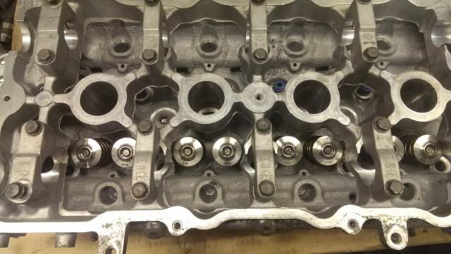

little bit of an update. did some work on the head yesterday:
machine work it top notch ! really chuffed with it at the minute.

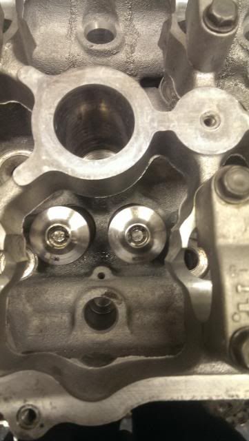

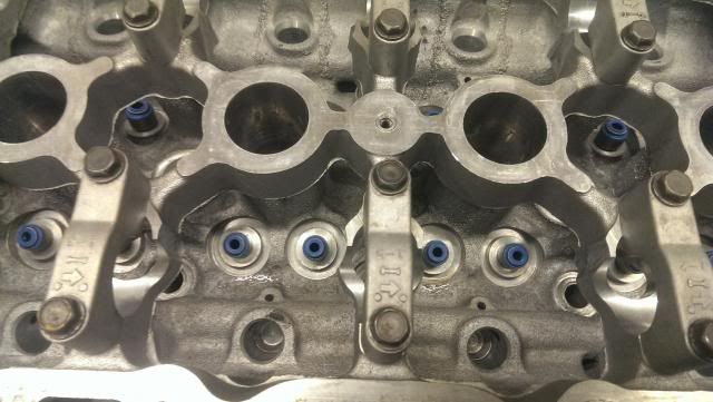

got the cometic stems seals in and BC valve spring with titanium retainers in:

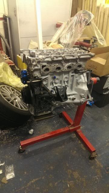

then got it on the block.. its getting there now:
hopefully will be able to get the shimming done today well atleast get it measured.

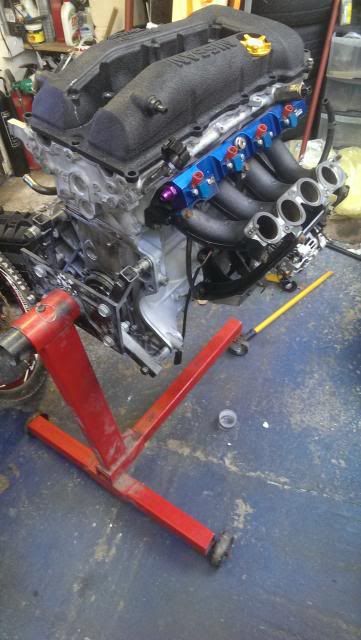

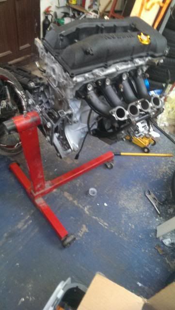

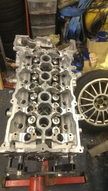

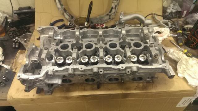

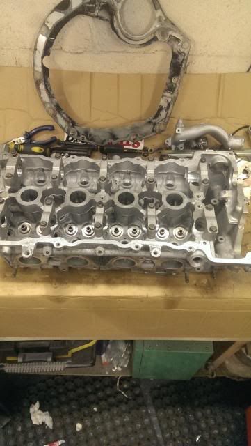

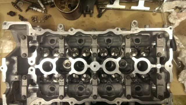

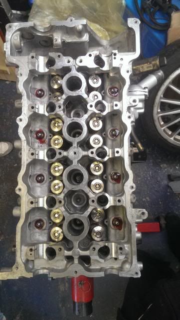

spent a bit more time on the engine over the past couple of days, managed to get the solid lifters in and get the shims measured up:
new rockers arms in:

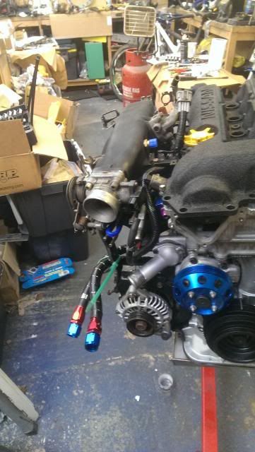

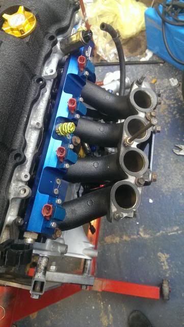

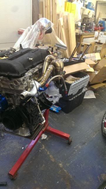

then spent some time getting some external parts on fuel etc etc:
next on the list:
Order Shims
make new injector loom
get hose and fittings for hoses etc

Looks top notch man! Wish I knew how to build an engine, would save a fortune ha ha love the black wrinkle finish too looks class mate

cheers mate ! waiting for a few parts now like shims etc so will be a little quiet for a bit now.. might give me a chance to do something on the car itself now...
building engines is easy :) just a lot of measuring / reading / checking... just need to take your time with them..
yea liking the crackle finish myself. decided that with all the fittings etc it would look odd with a loud rocker cover lol
