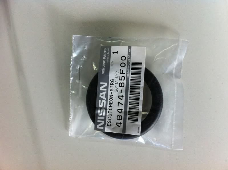

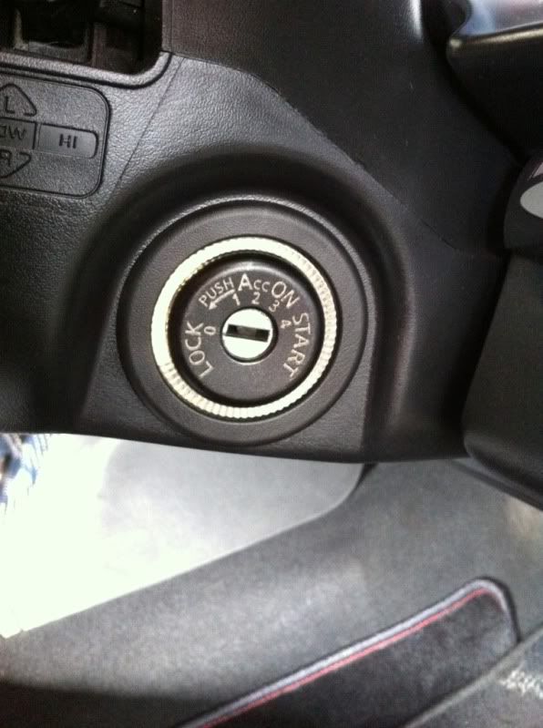

So in recent news... My s15 was always looking a bit bare around the key barrel, some nob must have lost it installing the momo steering wheel my car had on it when i got it. Part number for anyone in the same boat
Aah that helped my ocd

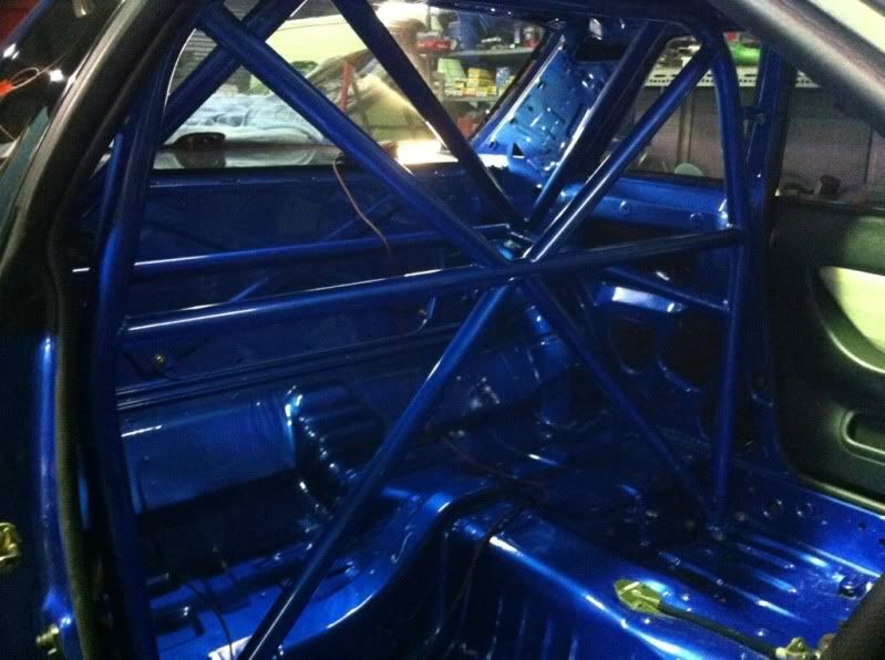

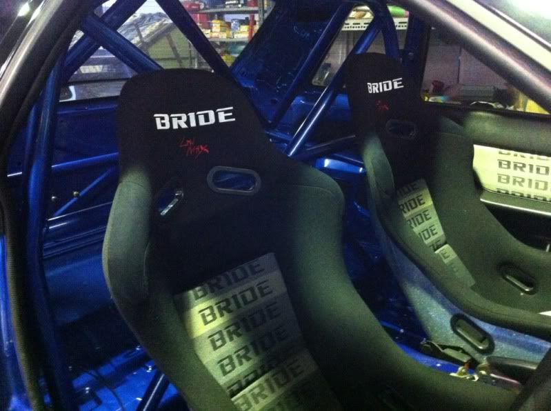

Stayed back a few nights at work and got the cams approved bolt in half cage installed in the r32. Was pretty easy going just have to be careful not to scratch the paint.
Sorry the pics are a bit ****, ill do some proper ones soon.

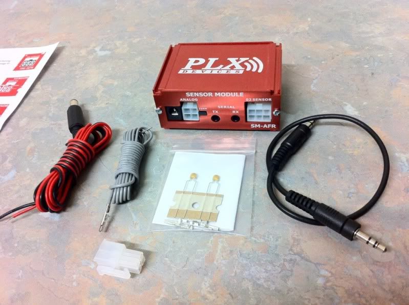

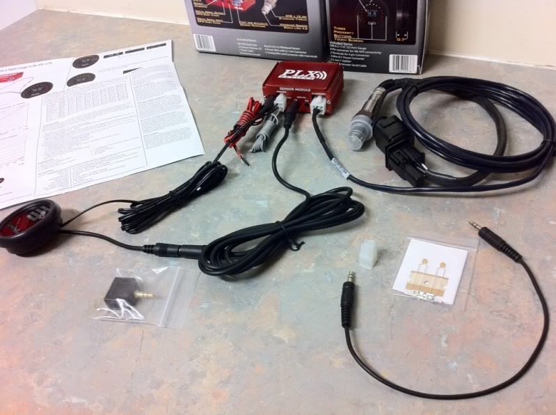

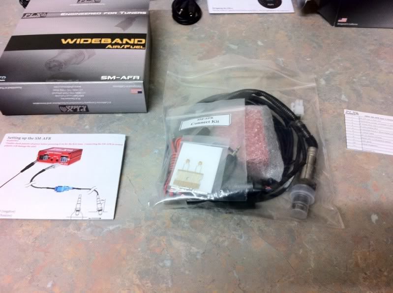

I have placed another order with frsport.com, they guy mike there has been really helpful getting me the plx wideband o2 sensor and Dm-6 multi guage combo.

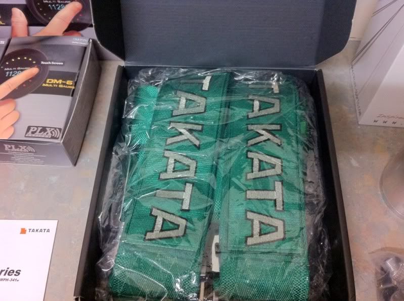

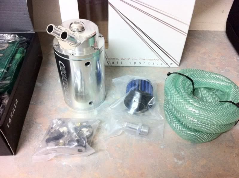

I also added a takata 4 point racing harness for the skyline and a circuit sports 480cc catch can. Not sure which car its going on yet, probably the skyline as i want to use it at the track soon as possible. If its and good and i can make a decent internal baffle for it i will order another for the s15.

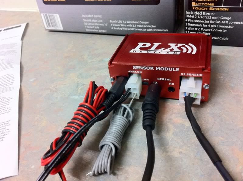

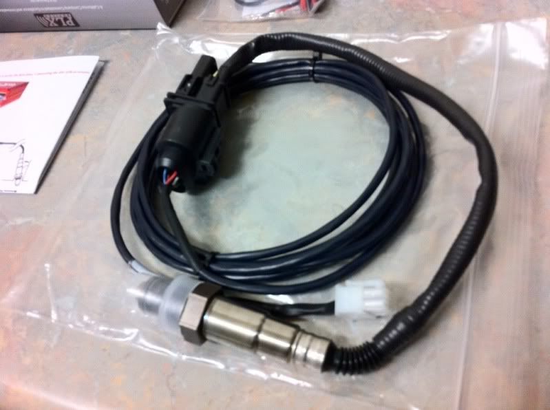

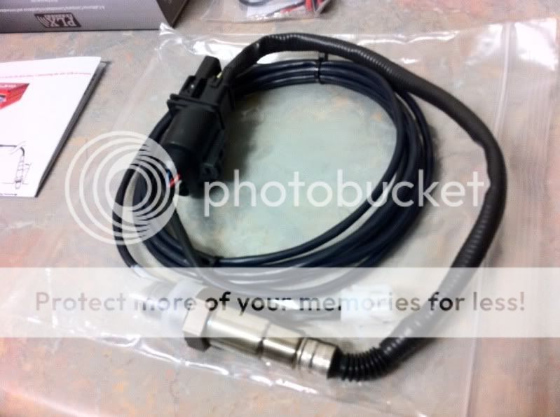

Well the post has been good to me, the parts arrived today. Thanks again to mike at frsport for sourcing the plx combo me and excellent service! Ill let the pics talk...

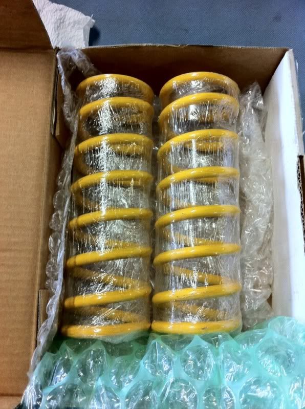

So thanks to the brilliant guys at MCA Suspension i have some new rear springs for the s15 to test out. These arrived on thursday which is an impressively short amount of time to have them made and sent to me.

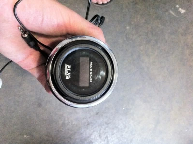

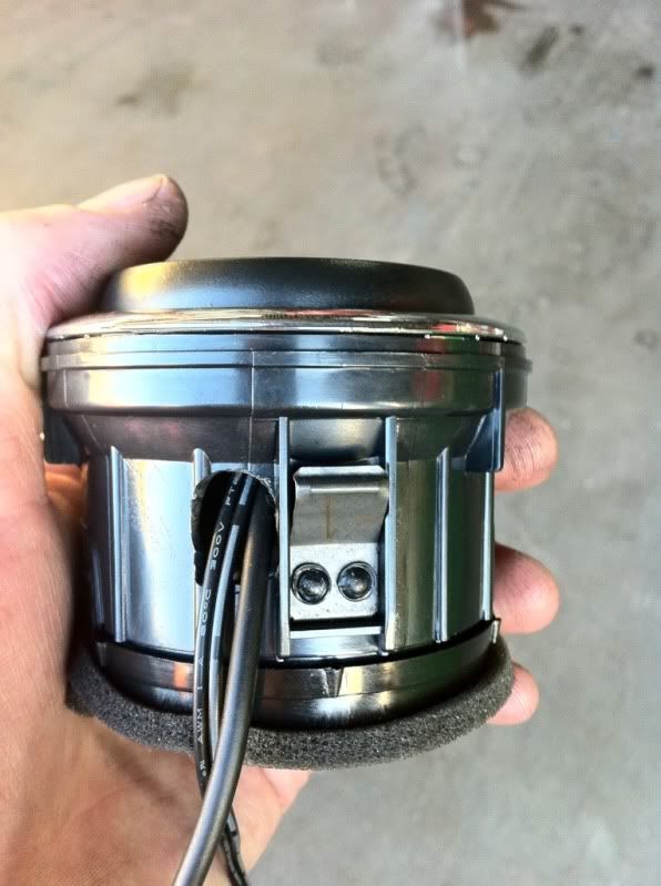

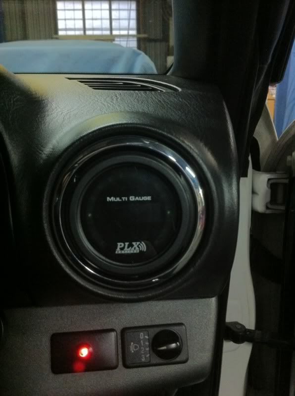

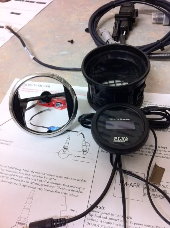

After much debating ive decided to sacrafice the air con vent to the right of the steering wheel to fit the plx dm-6 multi guage. I want to maintain a clean look so have dismantled and will modify the chrome vent to fit the guage. It looked like it would almost fit without trimming but it needs about a mm each side.
Oh well another vent sacraficed to the car gods. I am taking the exhaust off this week to have a bung fitted for the wideband o2 sensor, also looking at removing the first muffler in the kakimoto catback system. I dont want to but i really should for ground clearance, the car is not super low i only need about 15-20mm :(

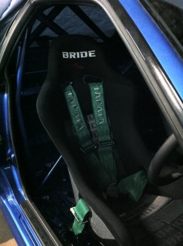

Also sat the harness in the skyline to see how it looks, need to make the side mounts. Hmm.

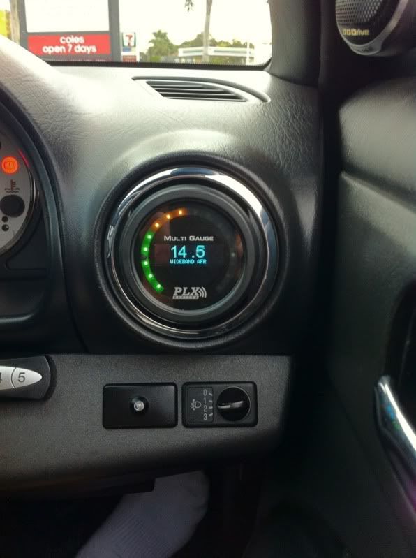

Heres the guage mounted in the vent. I have left a gap so hot/cold air can still flow around the guage. Im really happy with how this turned out as i wasnt that keen on sticking a guage in a vent and blocking it off completely.

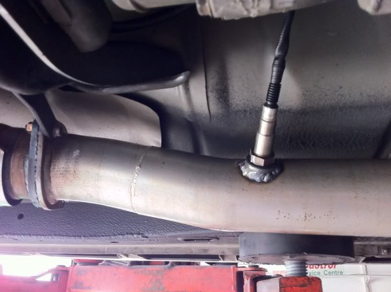

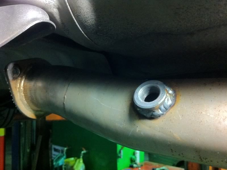

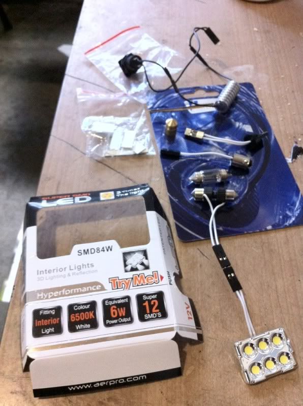

No spare money this week, still managed to pick up and interior 6 x led light and an exhaust o2 fitting and bung for $36.
A few pics from today
I cut a hole with a right angle drill and holesaw. Then my mate welded it without having to remove the one piece front/dump pipe which saved me about an hour and a bit of swearing or lost skin.

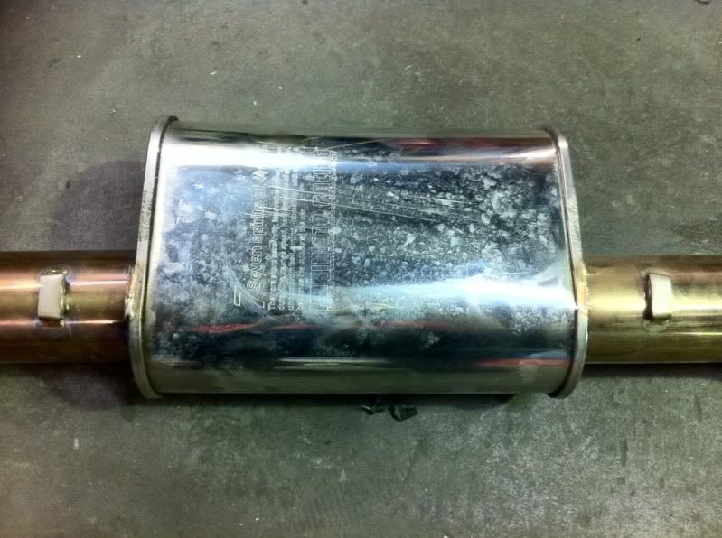

This muffler in the kakimoto catback is just too big, i cannot run the car as low as id like. Ive had it in the workshop press today tryin to flatten it a bit and then ill push it closer to the tailshaft. I really dnt want to cut it out or run the car looking like a 4wd. I only need about 15-20mm so im pretty confident i can get it there.
More tomorrow i want the car back for the weekend, with a bit of luck fedex will deliver the last bit of electronics i need to do some tuning. Basically to put a analouge 0-5v into nistune via usb. Had to get it from the Usa.

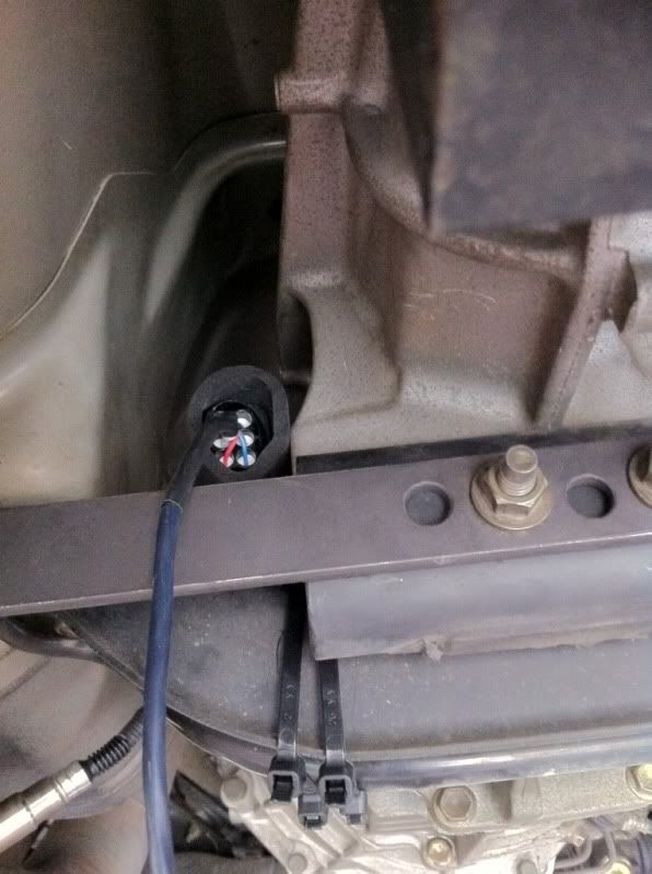

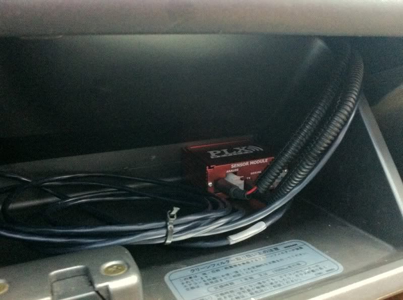

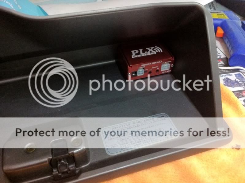

Just finished the wideband install
Wrapped the connector in a rubber tube and zip tied to the gearbox crossmember. Drilled a hole forward of the gearstick in the floorpan to run the wires up to the sensor module. Used a rubber bung in the hole and double protected the wires by using convaluted tube where the wire passes through the bung :) looked oem almost
Idle
Glovebox install, not 100% finished yet. No doubt ill add some more plx sensors because its so easy and cheap at $99 a sensor.

Oh also crushing the muffler has worked out well. I cut off the tabs and pressed it on both sides. The car now has 106mm clearance so its legal again, it was at about 85mm. In Aus thats something to be bloody relieved about, and no more scraping on speed bumps. Everywhere in aus.

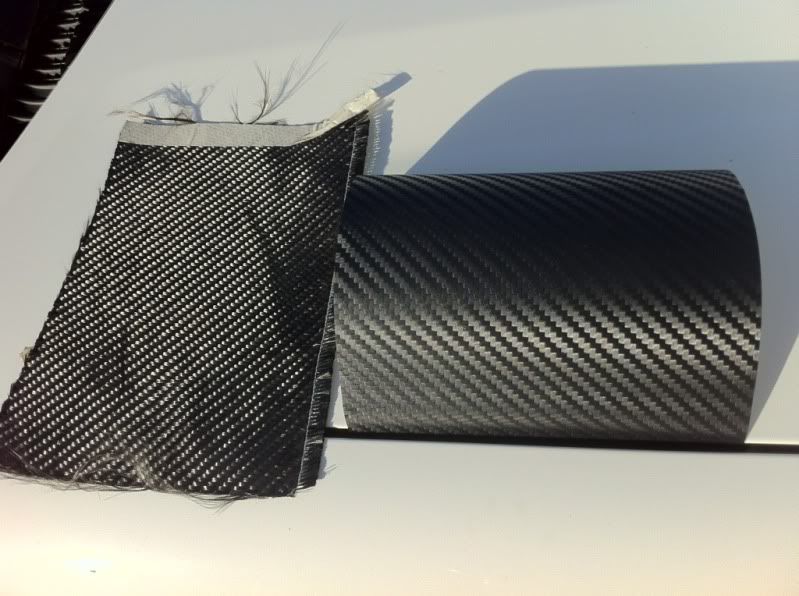

Ive wanted to make carbon fiber replacements for the grey plastic areas of the standard steering wheel. I could stuff around and make moulds an do it, actually i should in the future but for now im going to try the 3M carbon wrap. Thinking about tring to do the matching bit on the standard gear knob. Looks like a tricky shape, but it would get rid of the last of the grey areas.
Real carbon fibre cloth vs 3M product.
