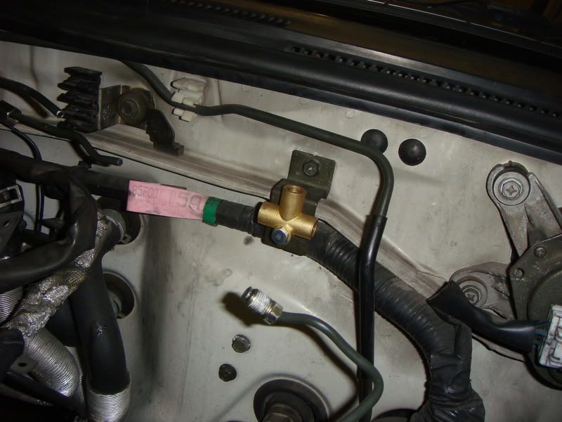

Made a bit more progress today and did a bit more work on getting rid of the ABS.
I was going to use braided lines to get rid of the stupid ABS, but to have the lines custom made would have cost £95+, and the ones from dbpower are still £80. So figured I would have a go at making my own copper lines. I wanted to use braided as they look a hell of a lot more neater and the fittings are more robust and easier to install.
With the copper lines, the recommendation is to install a T-Piece near the brake master cylinder and run a single line to the left side caliper. Problem with this is that the left side line will be a lot longer than the right one, I doubt this makes any difference at all, but is a point to note. Also it's really really hard to route new tubing in situ and make it look good. So what I did was cut the stock brake lines, and joined them to a T-Piece that I bolted in to the bulkhead where the ABS module originally as.
T-Piece:
Then I used some female and male unions to extend the stock lines to the T-Piece. I used a bubble flare on the stock lines, and a double flare on the new copper lines. I know this probably isn't the best way to run the lines as it puts in more joins, which means there's more chance for the braking system to leak.
So the plan is to bleed the system, and have someone to stomp on the brakes while I check every connection for leaks. If there is a leak, I will probably just run a new single line to eliminate using any of the stock brake lines. I don't anticipate that there will be leaks as the flares are quite good, and also I've tightened the unions a fair bit to allow the mating surfaces to deform and mate correctly. And if for some reason that fails, I will just buy some braided lines.
Trying to flare the stock kunifer lines in situ is a pig of a job! When I flared the copper lines I could just hand tighten the flare bar and flare away without the line slipping. But the kunifer ones kept slipping and had to use pliers to tighten the wing nuts. In a vice its easy, but in situ makes it very difficult indeed!
