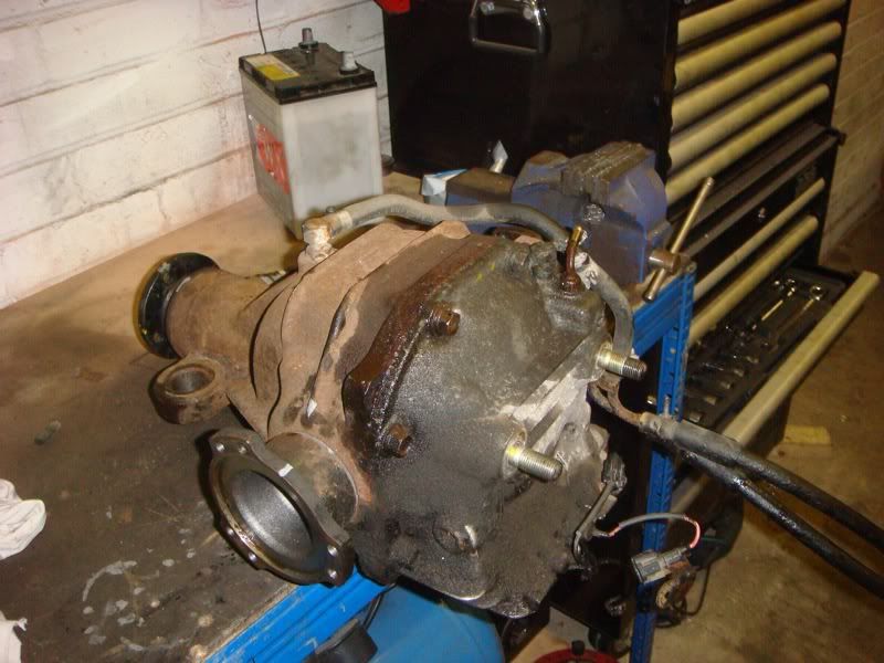

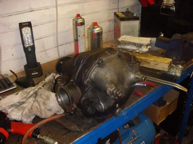

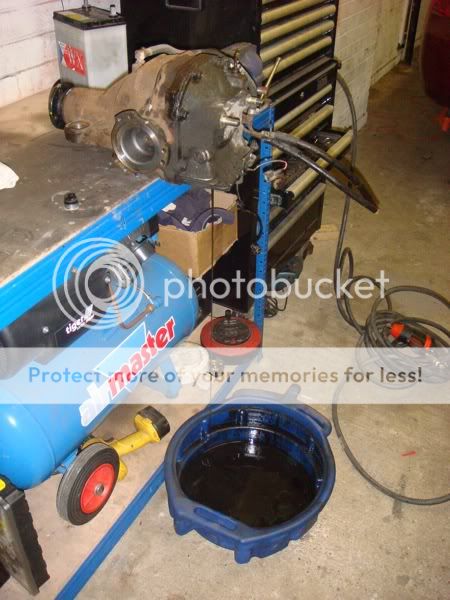

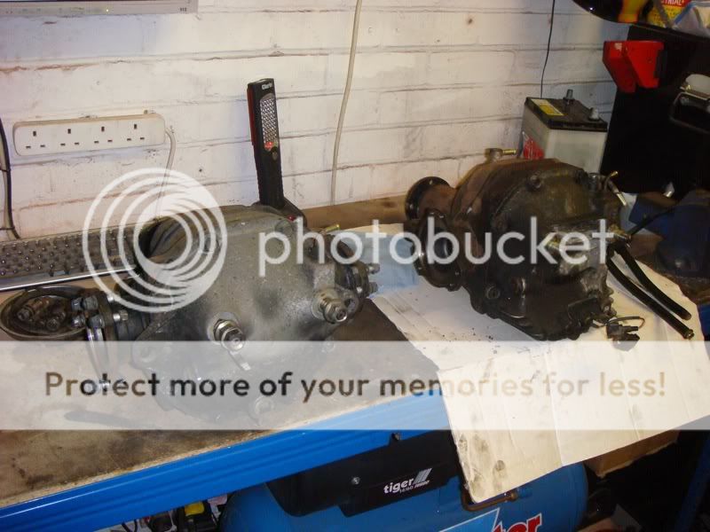

Small update. Still building my S14, but am still driving the S15 and drifting it. I was getting fed up with the helical diff, so picked up one of these for cheap:

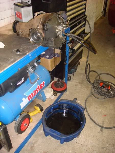

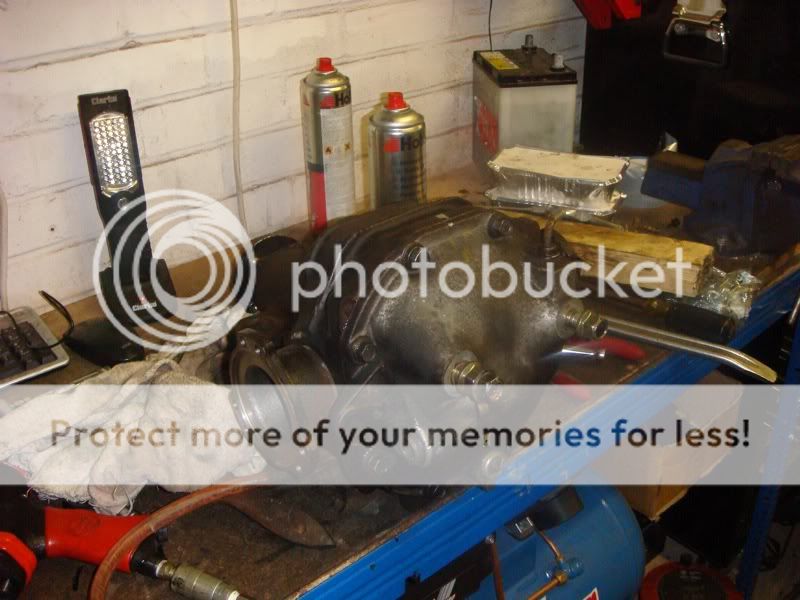

Draining the oil:

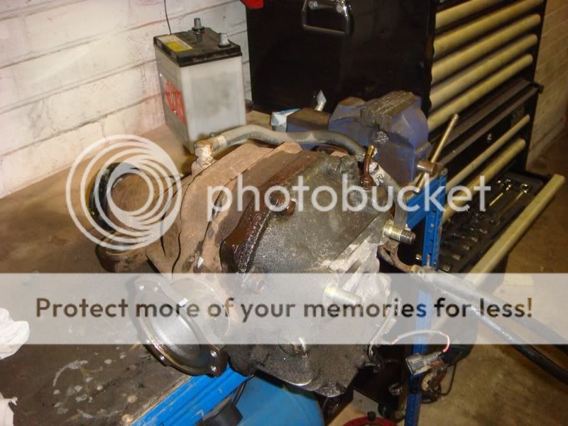

An S14 VLSD
I will be welding this up and rebuilding it into the S15 casing and put it in the S15. I might use this casing for my S14 build, or might use a Skyline casing with uprated drive shafts.
It looks just like a S15 helical LSD. I expected it to look totally different.

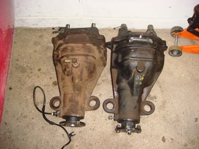

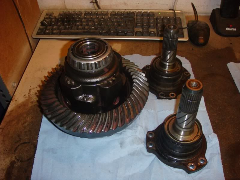

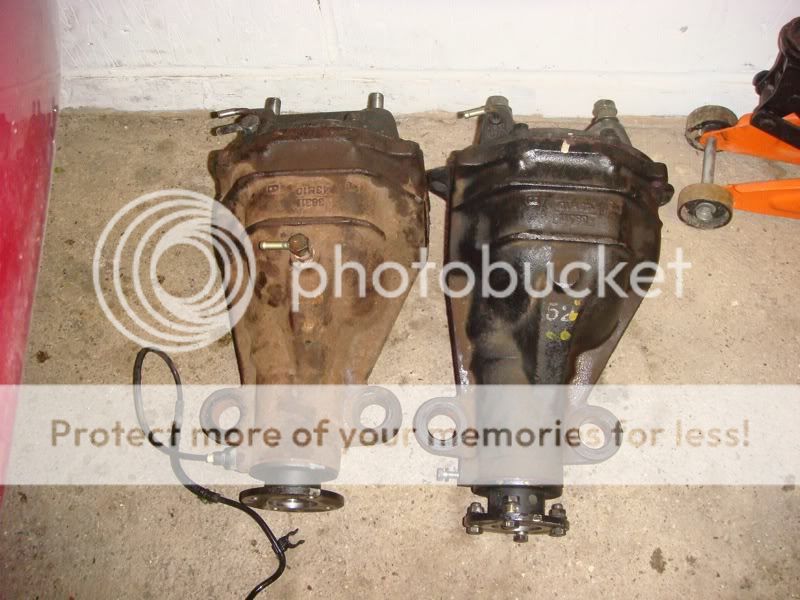

Took the diff off the S15 today. Was a bit of a pain as had to do it outside on the gravel as my S14a project is in the garage atm.

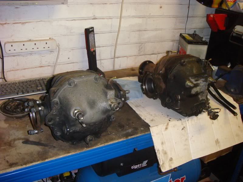

S15 diff on the left, S14 on the right:

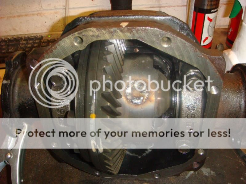

Slight difference in diff casing. S15 one on the right:

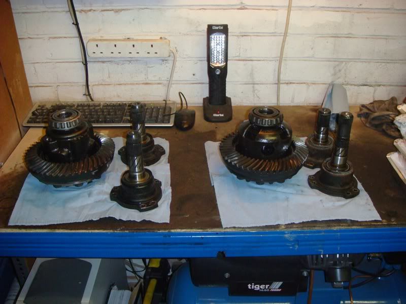

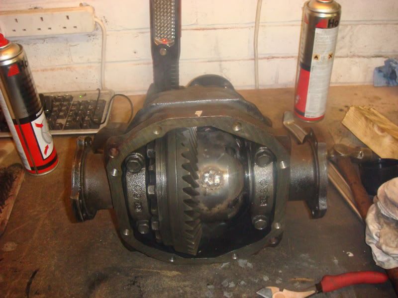

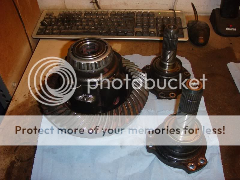

S15 helical diff:

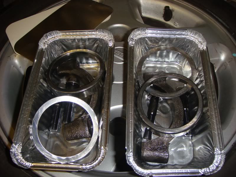

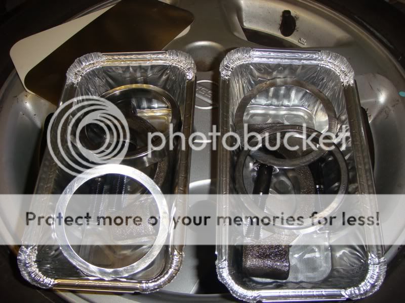

Spacers and bolts:

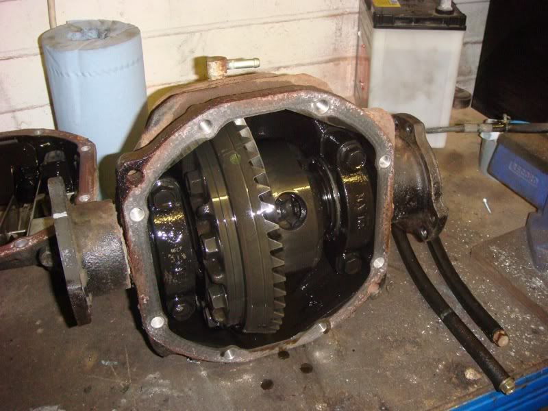

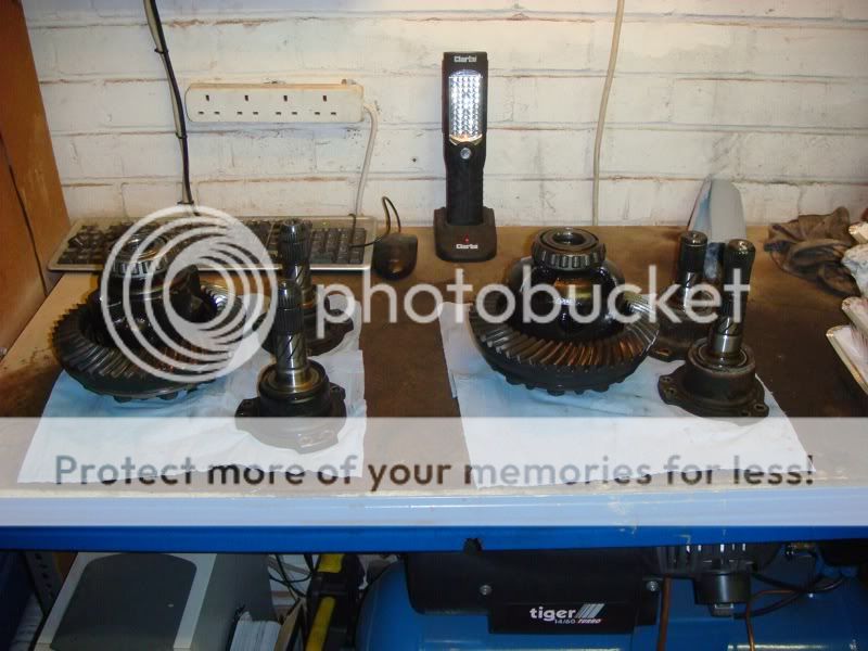

S15 helical on the left, S14a viscous LSD on the right:
Gonna clean up the S14 diff up tomorrow and weld it up.
Nice to see the difference side by side. The diff's are proper heavy things - I had to bench press mine back in yesterday too!

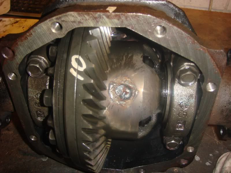

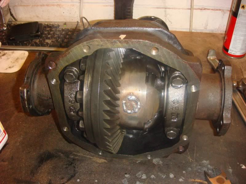

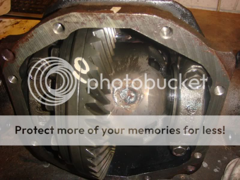

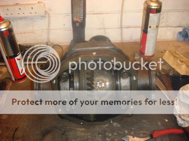

Finished the diff off today.
I installed the S14 VLSD into the S15 casing so that the speedo will still work.

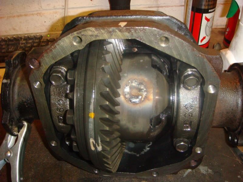

After it was installed, I got welding it:
There are 4 big holes to completely fill with weld so all the gears get welded together. It took an entire 5kg reel of 0.8mm wire, but didn't even finish off a small bottle of gas.
I then cleaned the diff out and fitted the backplate on and filled it with some Castrol 80w-90 GL5 diff oil. This will be changed after about 100miles or so.
The diff lifted into the subframe surprisingly easily using a trolley jack. Everything was bolted up and the car drives.
My first impression of a welded diff - it is ****ING loud, I mean really really loud! There is a constant whine and its pretty annoying, but I suspect this is because the previous owner must have had the diff shimmed quite a bit - I couldn't turn the output shafts in opposite directions even before the diff was welded.
