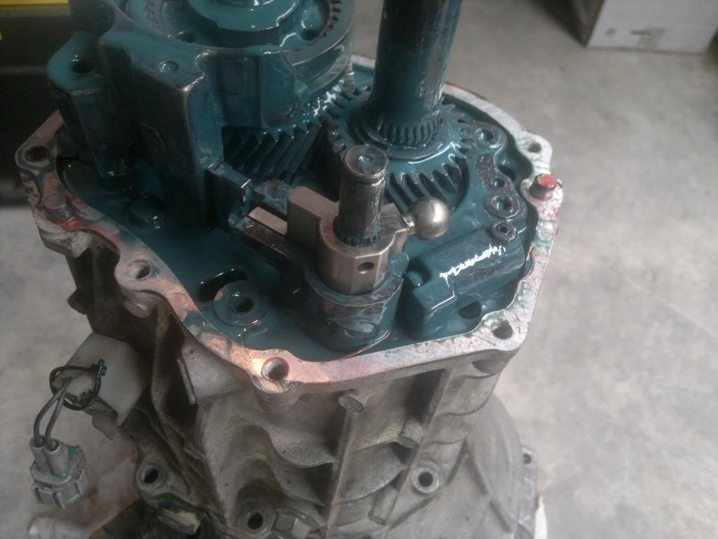

Redline Light Weight Shock Proof aka Smurf Blood this is what it looks like on the inside, proof that it sticks to all surfaces incredibly well
