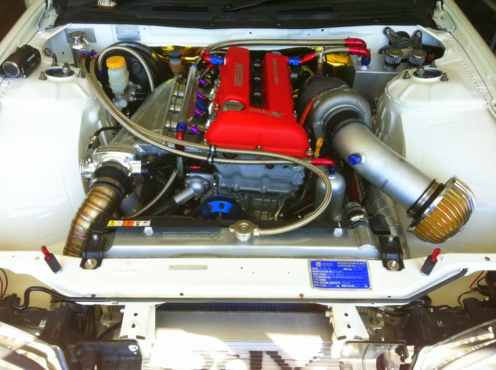

Both the P11 and P12 rocker covers have improved venting systems inside the cover, but you will need to still have a vent line to a filter box or catch can, actually I have a spare Cusco catch can going. Most builds try and have two connections to the rocker cover for venting, so you can weld up one perhaps but you'll need one left connected like this.
Have a look at this, this is from an SR23VET (R4Race) awesome build and the inspiration for mine.
You can see the two rocker cover vents going to a fabricated catch can with K&N filters to vent.

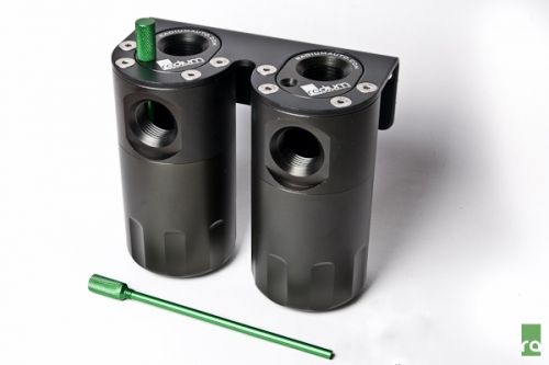

This is the catch can I would like if I don't have a custom one fabricated
