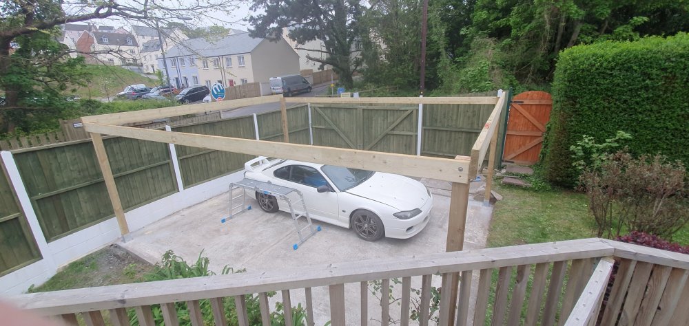

I've started stripping down the car and building a car port above it but with the lockdown the last bits of timber are taking forever to arrive!! (Car stripped more now than photo)

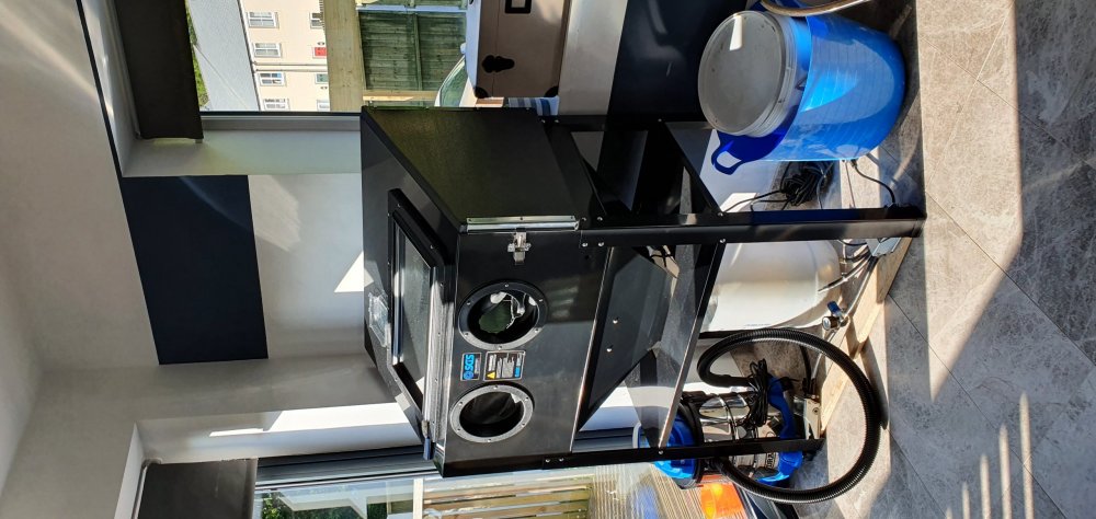

I'm getting myself sorted with the tools that I am going to need. Only a few more parts to go and I'll be able to start testing the vapor blasting cabinet. I took some advice and will be using glass bead 150-250micron media for the Aluminium components and Aluminium oxide 60/80 for the steel components. I've also got a blasting attachment for my karcher which I will use to blast the engine block with Aluminium Silicate media to spruce it up before I bring it into the house to store. At least the engine doesn't need any internal work!
The dining room is being turned into a workshop and the front room into storage. Everything that come off is getting attention of some sort. The 3L ultrasonic parts cleaner I've got is great for the smaller components! Next tools to get are powdercoating gun, and a used electric oven.
