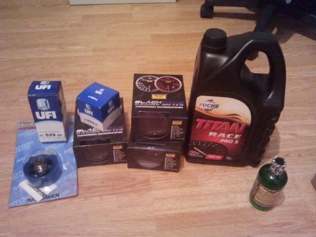

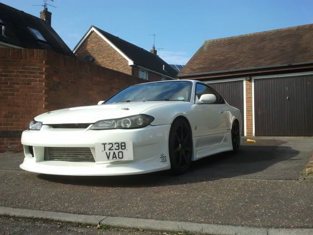

few updates

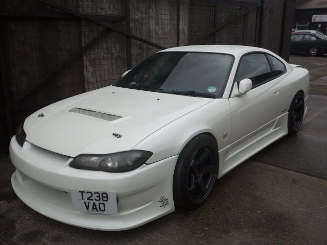

got the car back from the bodyshop and she looks good as new. very pleased with the job. Few pictures after i cleaned her
starting to get a collection of parts waiting to be fitted as well,
so far have
r-spec oil pressure gauge
r-spec oil temp gauge
r-spec boost gauge
sandwich plate
carbon sill covers
spl dynamics component speakers
fuches 5w30 oil
oil filter
fuel filter
currently waiting on a gizzmo to arrive as well.

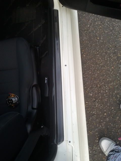

I was going to araldite the sills on, bought the stuff then sat down and thought about it and realised they wouldnt come off when i need to run the speaker cables down the car :annoyed:
In the end i velcro'd them on, they dont come with clips on the back and i didn't want screws visible in them and i thought they might blow the carbon.

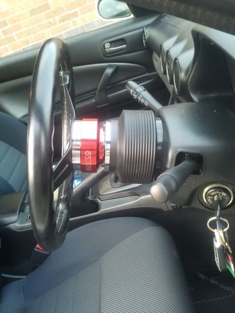

Also fitted a red snap off boss today instead of the blue. Matches the wheel nuts :D have a blue one for sale if anyones interested?
Sill -
Boss -

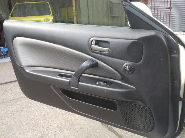

spent saturday fitting a set of spl dynamics comp's in the doors....went well bar when we snapped the piece that goes around the door lever so if anyone has one lying around il take it... :D
pic of the door once complete. Didn't take any progressive ones...

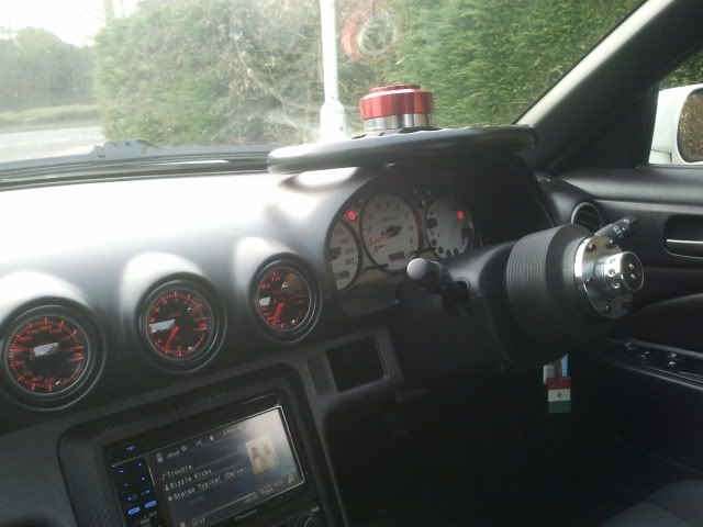

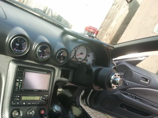

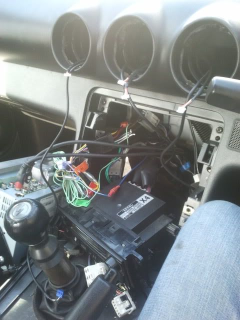

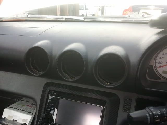

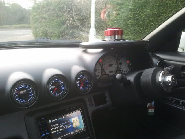

so today we fitted the dials, changed the fuel filter and oil. few pics....
bumper off so we could get her in the air
vents out
mid way through the wiring
day time
night time
pretty chuffed with them tbh :)

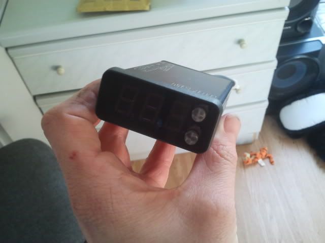

few new bits arrived today
finally recieved my gizzmo...just need a ecu now.

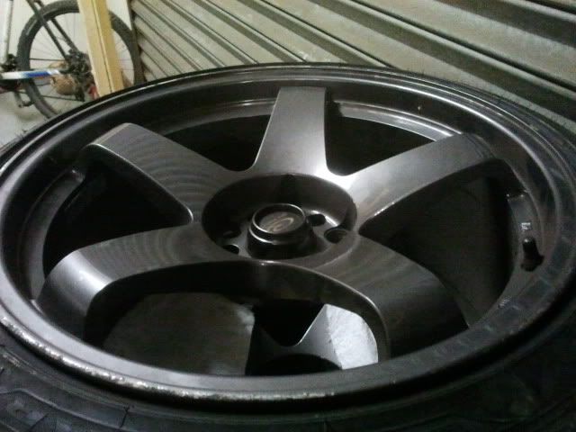

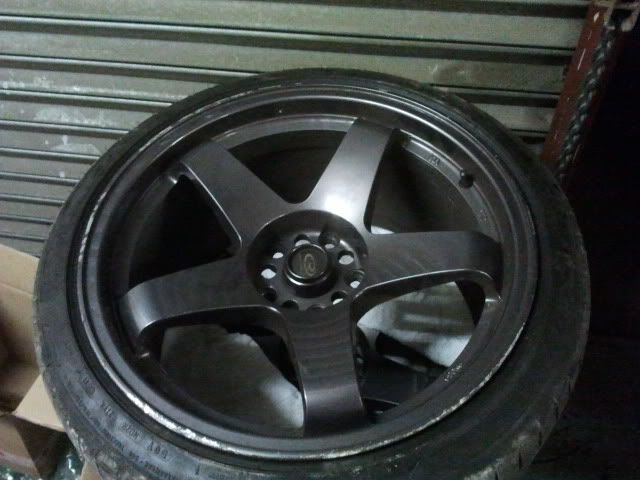

picked these up last night, 18x9.5 et30.
hoping they clear the coilovers...just need to get 2 new tyres and a refurb on them when i get some spare cash.

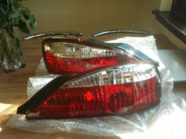

I do like those rear lights, I've got them on my car aswell. The wheels will fit fine, I'd have thought you may need to run a spacer up front though. What tyres are you going to use too? As that'll help them fit the car a little better.
26 March 2012
96
where did you get the rear lights from? i have those wheels on mine have a 20mm spacer on the front and its still fairly close to the coilover platform.

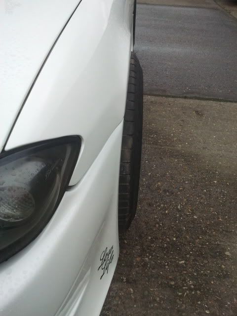

Had some issues with the wheels today, I'v got a 20mm spacer on the front to clear the coilovers but they stick to far out the arch :(
rear lights are from ep racing. Cost £160 del. i think. :)

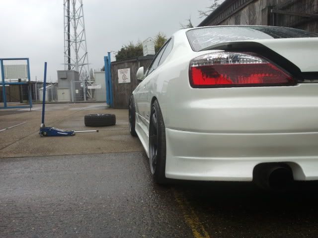

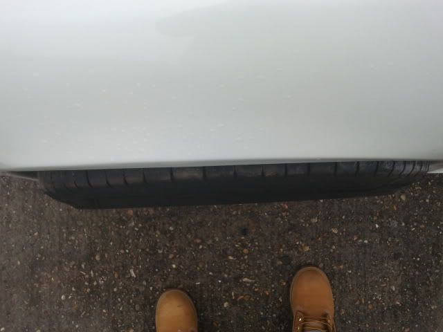

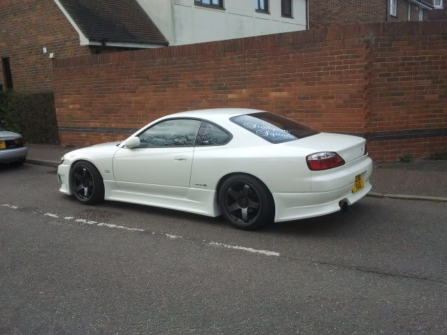

trial fitted the wheels today....not as sucessful as i'd hoped. Turns out the car all ready had a 20mm hubcentric spacer on the front which was handy, however the wheels stick way to far out the arch on the front and make the back look stupid.
I'v ordered some 15mm spacers from driftworks for the back....should bring it all most level.
Plan is to work out what size tyres im going to need, stick the 15mm spacers on the back and dial in some camber both back and front. Think im going to need at least 2.5 deg both ends. Luckily the car came with camber arms on the back and camber adjustable suspension on the front.
Thinking 225/35/18 for the front and 225/40/18 for the back. Any opinions? feel free to tell me im completly wrong and need something else instead :D

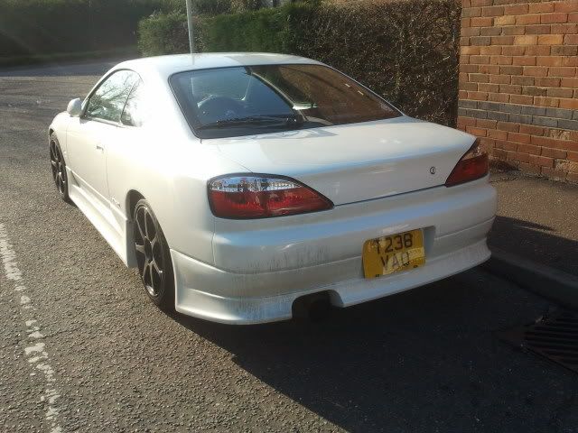

de-spoilered her as well. Ordered one plug and got 10 so if anyone wants one, pm me and cover the postage and il send one out :)

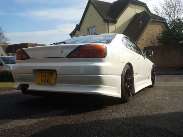

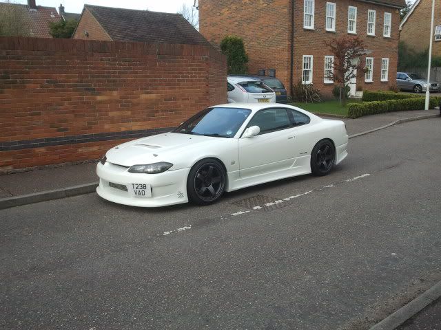

went for 225 40s all round in the end purely due to the hike in price for the 35 profile over the 40...was a extra 50quid a tyre!

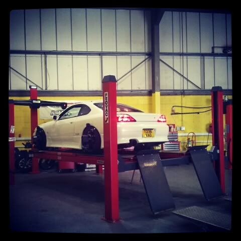

ordered up some dw spacers which set me back £105 and some fresh spiggot rings then headed down to skidmarques on saturday to have it set up.
Turned out the spacers wouldnt fit on the rear, i ordered 15mm ones and i appear to have extended studs all round so they wont fit...bit gutted but dont really think it needs it tbh.
3.5 deg camber on the front, 2 deg on the back.

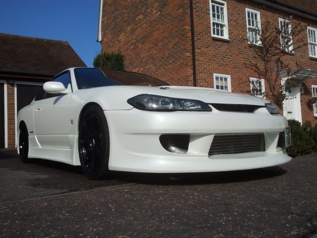

Few pictures:
will be booking them in for a colour change next week :)
