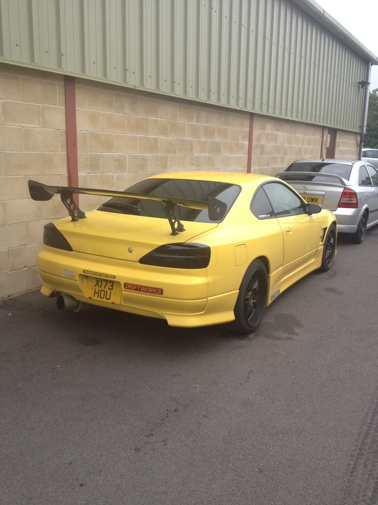

I didn't know you were such a DOG lover mike!!............................... There's plenty more pics of her on Facebook!!
she's not that bad! lol
plus. you cant say there's pics on facebook, WITHOUT PROVIDING A LINK! ;)
Mr LuPix wants to perv. haha

Ha ha! To be fair it was one of her best pics I could find! I can't post a link to her Facebook that would be wrong!
And there are no semi naked shots Mr lupix! tut tut! A family man like yourself should know better than to perv!

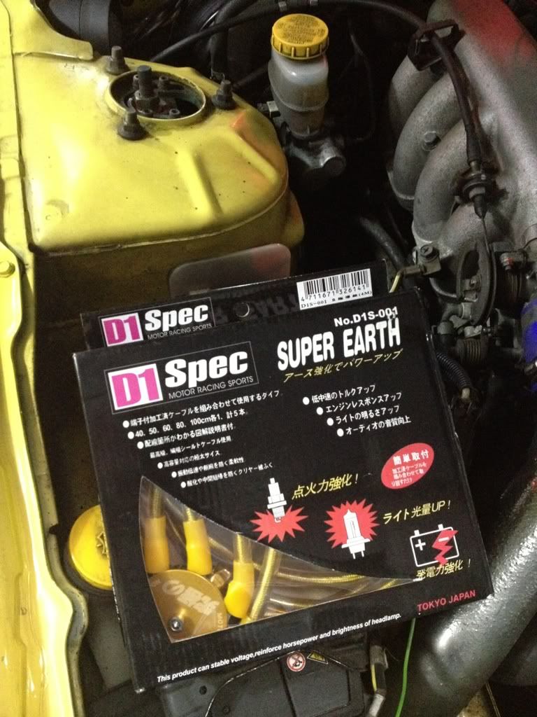

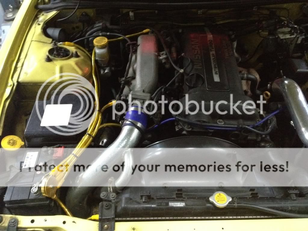

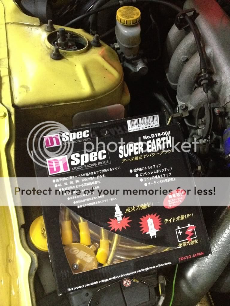

I also picked up a D1 yellow earth kit up off my mate and fitted that today! It promises 10-25% increase in fuel efficiency and much more throttle response. The only thing I noticed was the pretty yellow wiring!
So in total I was in the workshop for 9 hours covered in waxoyl and ****! But was worth it for the results! Much stiffer rear end and easier to control the drift snap! Was fun in the snow on the way back! :)

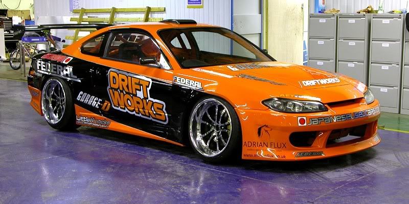

Well on another update, I've decided I want my car to have this vinyl! This is probably the best looking s15 ever (IMO)
So yeah I need to pphotoshop it on sso I can say defo yes but I think iit will look sick!
Nice updates dude...
Can't go wrong with yellow and black combo and agreed, Phil's 15 has been epic since day 1 :thumbs:

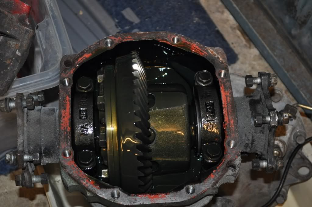

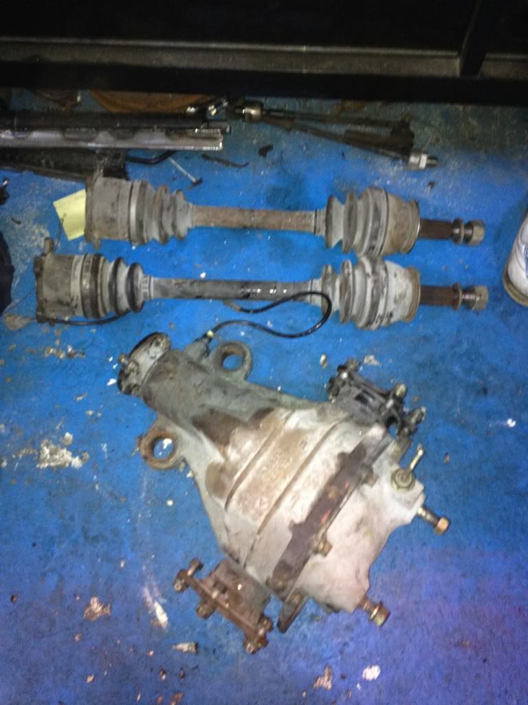

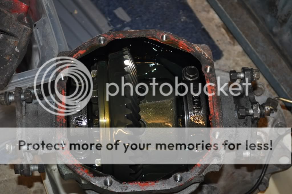

Little update, I've been doing small bits and bobs over the last month or two, but recently purchased a Nismo 2 way diff from sx-si! It's always been my goal to get one as its the ultimate drift tool to finish the car off.
Heres the diff and shafts, it's a skyline diff centre built into an S15 casing with original planet gear and pinion, which for me was the clincher as it was an easy swap and correct drive ratio! with the skyline output shafts and drive shafts it's an uprated and (touch wood) stronger setup.
So i polished up the rear casing and painted the shafts and touched up the back plate bolts with yellow too! :)
I also topped up my smurf gearbox oil, to help the box as it was feeling abit notchy
So my verdict on the diff is that it is brilliant! I was really expecting it to be clunky and noisy, but it's really quiet and only on full lock turns does it slightly skip round. Once it's warmed up it's more aggressive, but I haven't had any rain yet to give it a good test on my local "driftabout".
Gotta love Nismo!
I have the Nismo GT pro diff, and think its great, only get slight crunch and pops at very low and tight corners, put when pushing hard it really digs in.. :)
Nismo GT Pro are the dogs!! Really want one for my 14a (but only 1.5 way)... just a case of finding one :wack:

Yeah today I pushed it abit harder and found my self understeering more, but that's to be expected, and yeah it's abit noiser once hot! But yeah well impressed! :)
i find there's more grip in the car now, than with the helical, which I thought was strange. But instead of loosing drive through one wheel first, there's more grip from both now, so it makes sense.
1 May 2010
830
Wolverhampton
Make sure you have got the diff set to 2-way and not 1.5...should be able to break traction pretty easy with a quick clutch kick and then proceed to do some nice skids :nod:
Do the skyline shafts fit the S15 hubs then as i thought they were different?

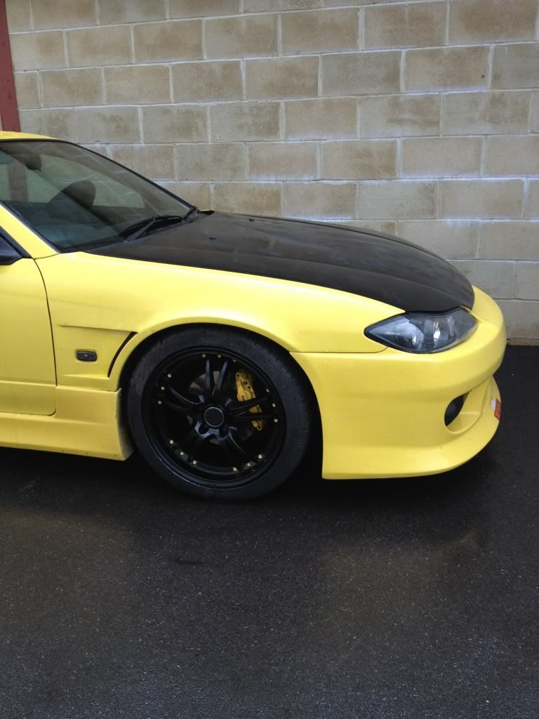

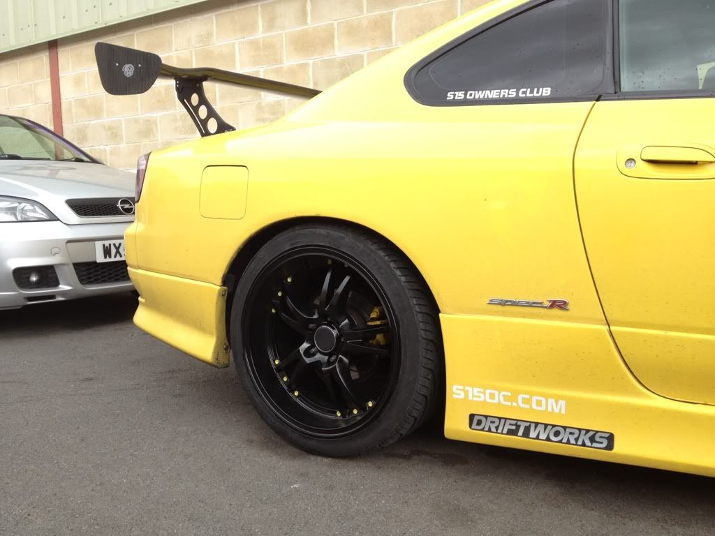

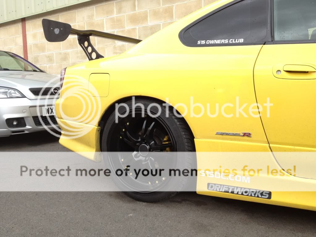

So with japfest fast approaching I thought I better tidy up my wheels!
They were a right old state where the Matt black paint I'd used was flaking off and also Matt bblack is a bastard to clean.
So I decided to paint them gloss black.
They looked alot better but thought they lacked a certain something. So I thought id colour the fake split rim bolts in yellow.
Shes looking good and almost ready for japfest! Just waiting on some new rear lights and also thinking about a D1 style sunstrip? But not sure if it would be too tacky!
4,644
46
Like the wheels bro, looks awesome!!!
need to do mine but so many other things to do still, think the sunstrip would look good to btw
Wow loads better with the wheels refurbed Sam :thumbs:
Can't wait to see her at Japfest :)

yeah really has transformed it back to looking smart and not so tatty!

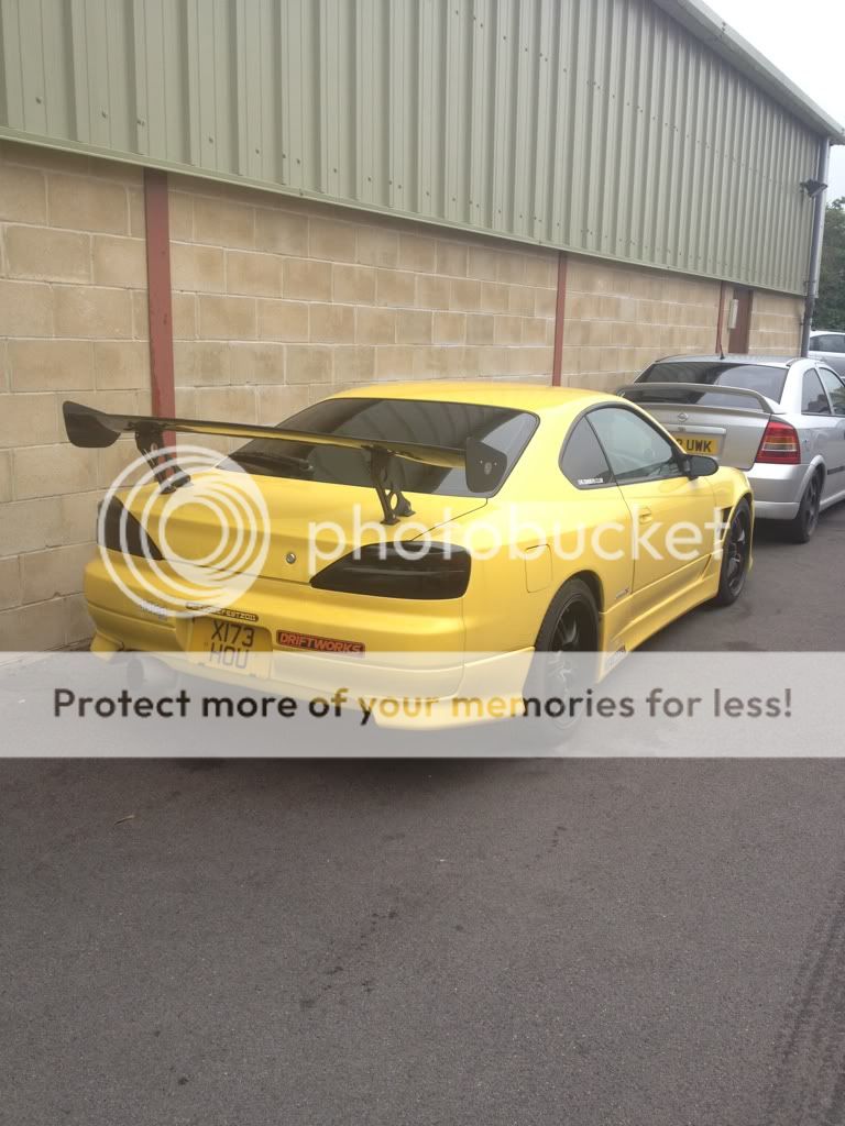

Just sprayed my new stock rear lights with etech smoke effect light spray, came out really well. And you can still see the lights when their on!
14 June 2010
682
uk, kent
Hey the rims and lights looks so cool Sam,
Good job mate :clap:
