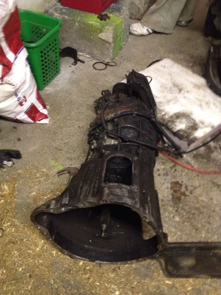

This arrived the other day as a donor for the gearbox, managed to pick it up for £700 delivered to my door (From London) which was a bargain considering the price of these gearboxes now days.

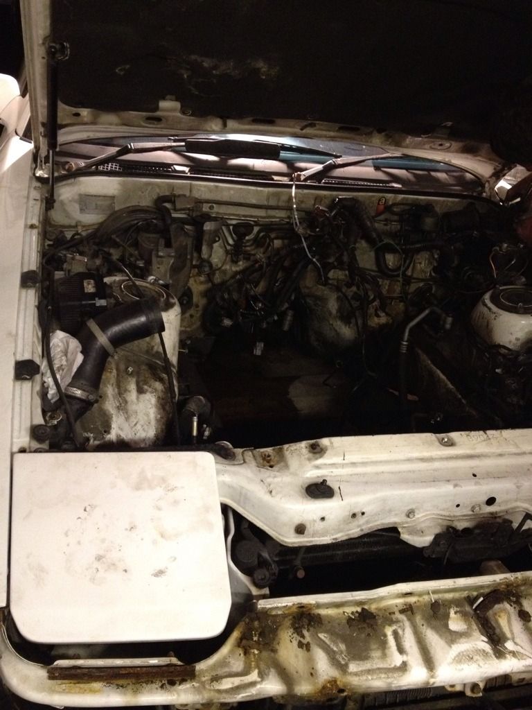

A day after arriving at my house it looked like this..

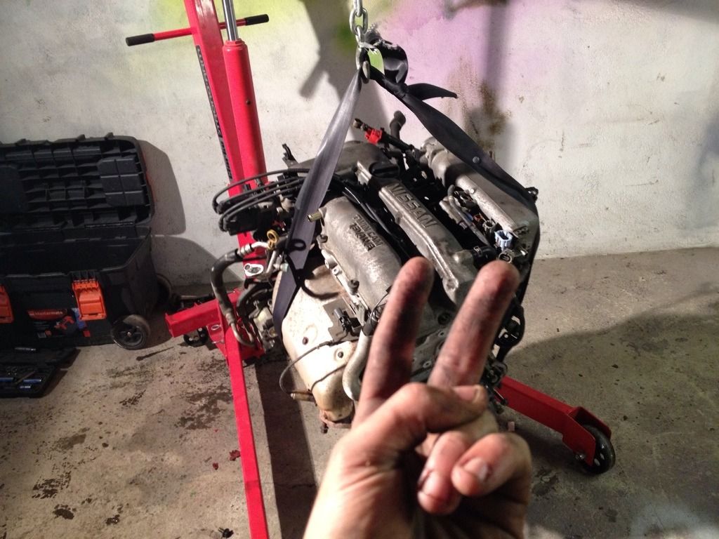

Also earlier in the week I whipped out the SR20DE from the S15.
Nice R154 ready to clean up

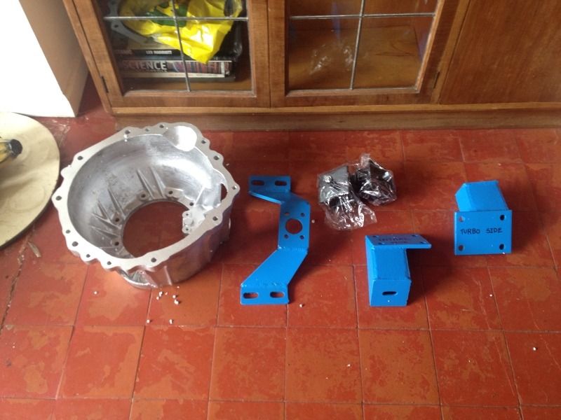

Got a couple of presents from Thailand yesterday.
Mount kit and Bellhousing for the 1JZ>R154.

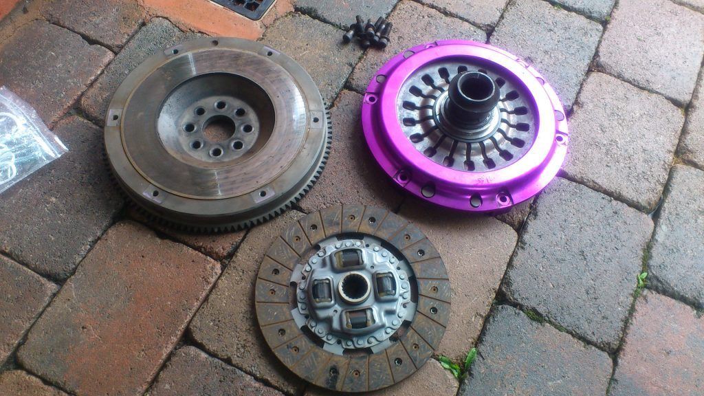

And.. Getting this tomorrow all being well..
Exedy hyper single clutch and flywheel

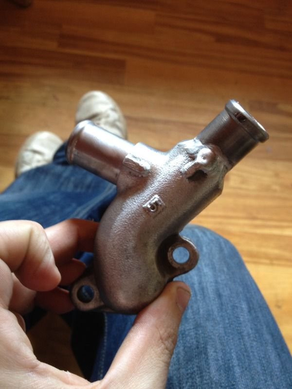

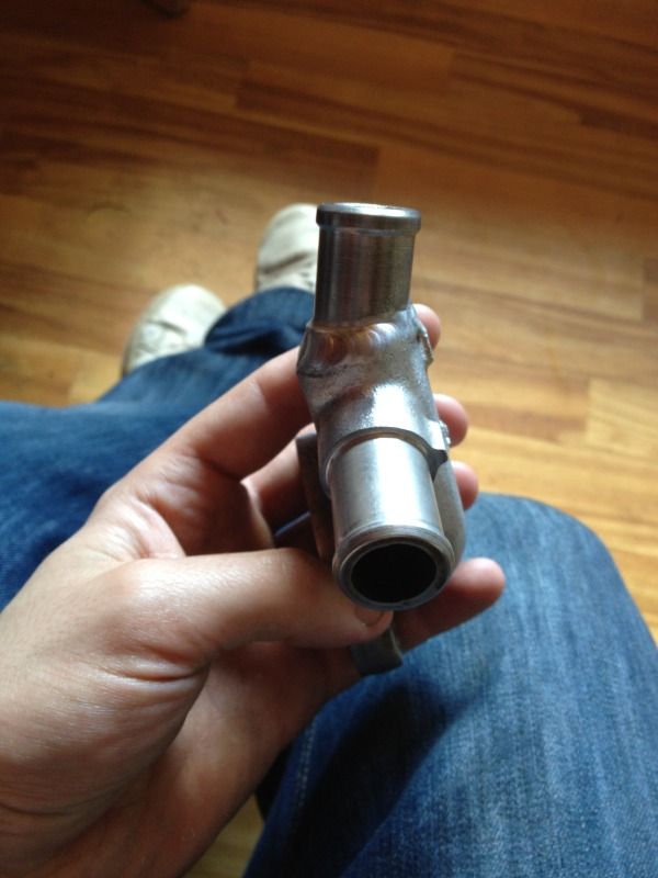

Finally got my oil returns sorted, cut, moved and tig welded. Fits like a glove now :)

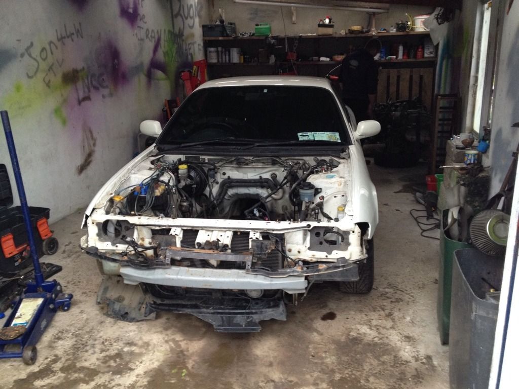

I was made redundant from work on Monday so have plenty of time to do the niggly jobs on the cars which I never got at before, I started my quest today and gave the garage a good cleaning to get the S15 back in with a bit of working area for a change.
I started with this, a bit of a crazy mess and yes, the graffiti is there to offend everyone possible.
After 4/5 hours of tidying/sorting I had this.

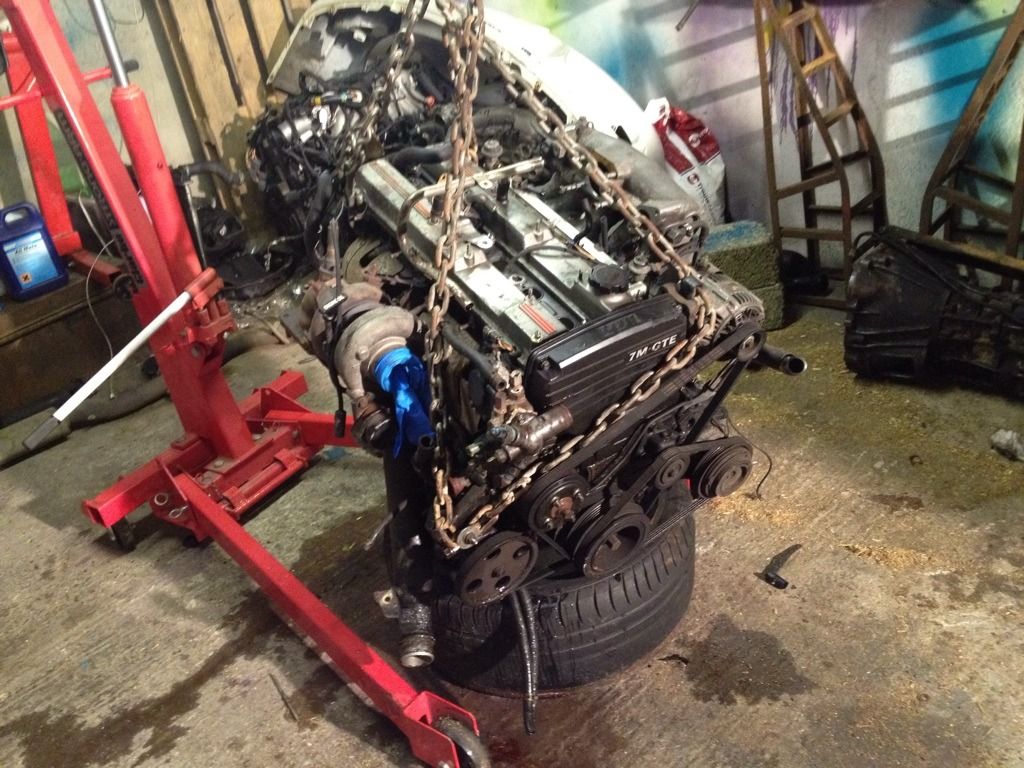

Still have to remove the 7MGTE Engine tomorrow when I get my Engine Crane back. A new lick of paint to cover the walls too.

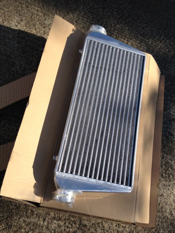

Okay, so after a short time of unemployment I have finally got myself into a decent job and things are looking good again, so I decided to treat the S15 to some goodies even though she treats me like ****. lol
I love boxes.
The contents.
Have the twin turbo's off already which was a complete c*nt, Now I need to get the manifold modified slightly to try and locate the wastegate somewhere as there is no space in the place it is meant to go.
