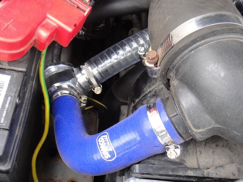

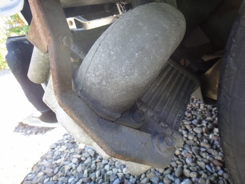

I also found the source of my neverending boost/backfiring/overfuelling problem! -
See the crack at the base of the pipe? yep. that tiny little crack lost me 10mpg, dropped boost by 0.2, and made her run pretty ropey. Cant believe it! Car runs like a dream now :) 30mpg, smooth changes, and boosts back up to 0.7 instead of 0.5 :)

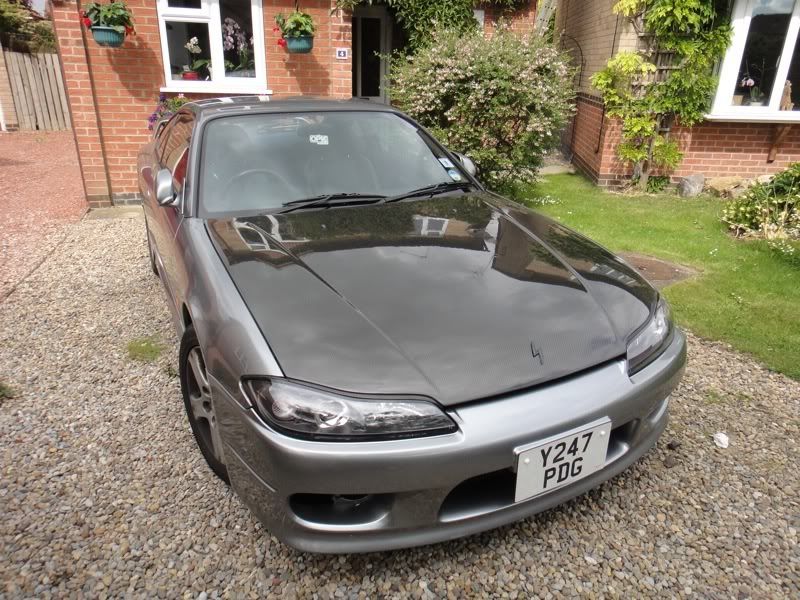

Front as it is now -
(for all those who were at Club JDM the other day - bonnet is now dropped and secured so doesnt look all goofy)
