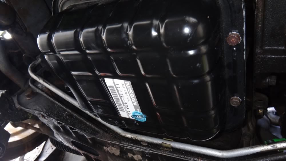

New oil sump fitted:

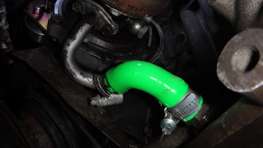

And that pesky 'garden hose' has been removed, and i've got a purpose built oil hose on it now courtesy of SFS :) No more kinky hoses here ;)

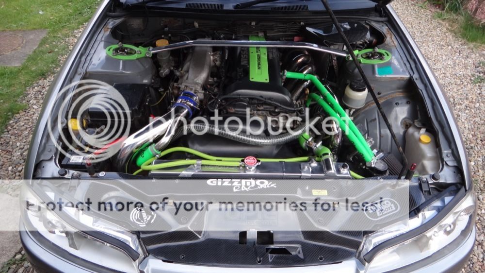

Well, The Koyo is fitted, and the car is running SWEET (at the moment.)
Just got to relocate the expansion tank as a) my hose isnt long enough, and i cant be bothered to order a new one, b) i feel like tinkering, c) i dont like the idea of having a U bend in my hose. haha
Note - the masses of cable ties are temporary until i get the fan shroud back in ;)

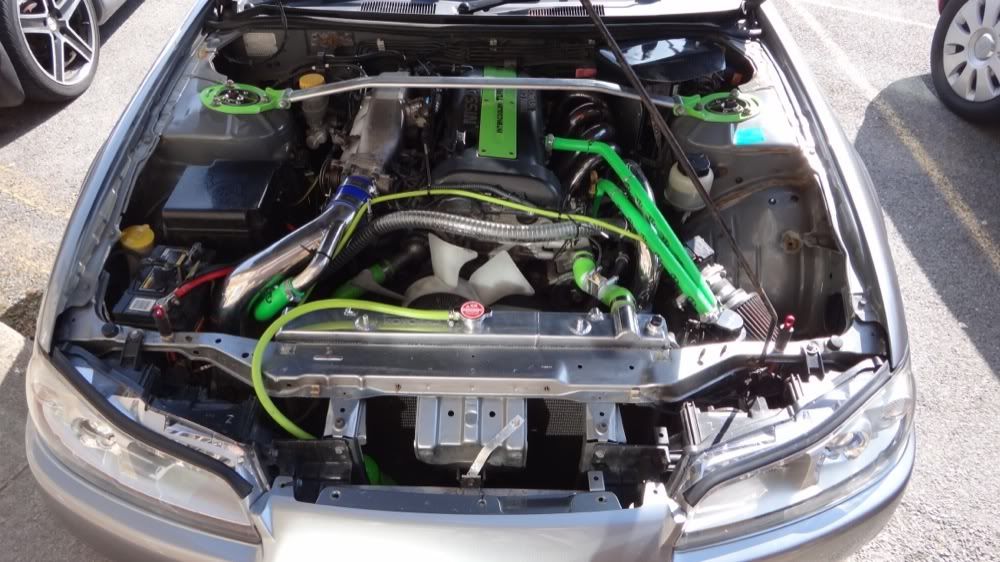

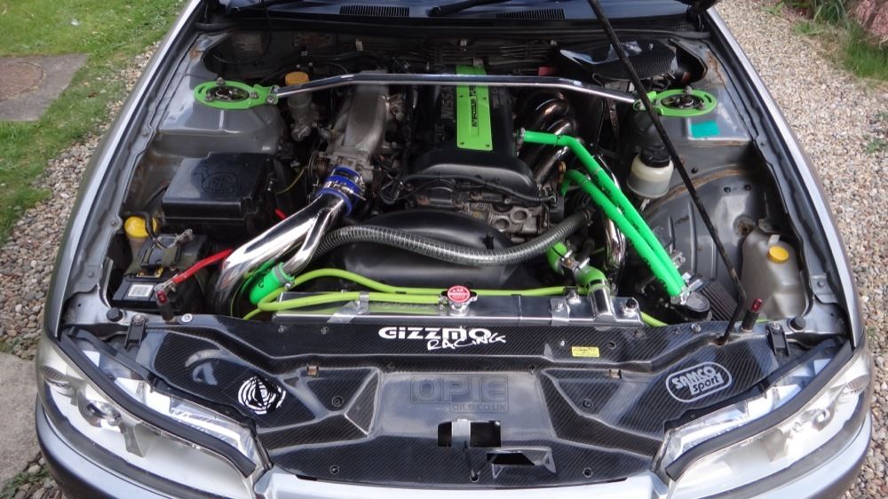

Little update:
New fan shroud fitted, and Koyo radiator is now secured on custom brackets :)
Also the carbon fibre cooling panel is back in, and everything has been cleaned up and polished! :D

Got the 6000k HID bulbs in anyways. Theyre nice and bright, and NOT blue :p
4,641
Looking good mate! Very clean and tidy!
What size etc is the hose from the turbo? Might order one myself looks way tidier
24 November 2009
1,121
North Yorkshire
Oil catch can hoses are 14mm to ensure a tight fit. Two 45 degree angles, and some straight section and couplers. makes it much tidier & controllable than trying to bend straight pipe and keep it there..
Recirc hose form BOV to turbo... not sure, sorry. I got it as part of a set, from apex :)
Intercooler hard pipe I got (again) from Apex I think, but lloydy has one for sale \/
If you mean the intercooler hotpipe, i've got one for sale :)
Looking good Jase!
Cheers mate! :)
4,641
Sorry if I was unclear,I meant the hose in the top pics for the oil drain under the turbo! :D
24 November 2009
1,121
North Yorkshire
Ah sorry mate, its the same size as the top breathers :) So 14mm ID will be a tight fit!
I got that one from SFS, its just a 90 degree elbow, that i cut down. You need to make sure you get the ''fluorosilicone lined hose for oil/fuel applications'', otherwise it could deteriorate or something.. better safe than sorry!

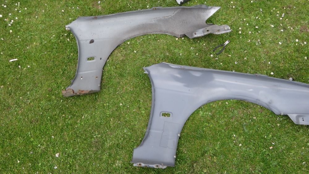

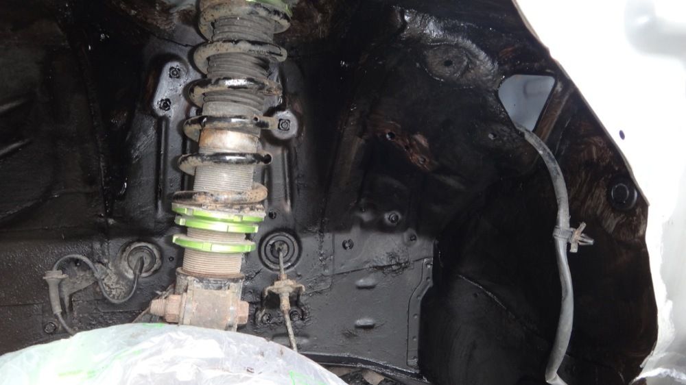

Undersealing & Replacement fenders! :)
the whole front end is now covered in WaxOyl and should (in theory) be watertight... bar the bits i've probably missed.. haha :)
The old fenders were rotten to the core. had to do a fair bit of angle grinding to get to bare metal underneath the car..
Next time.. it'll be the rear half of the car! :D

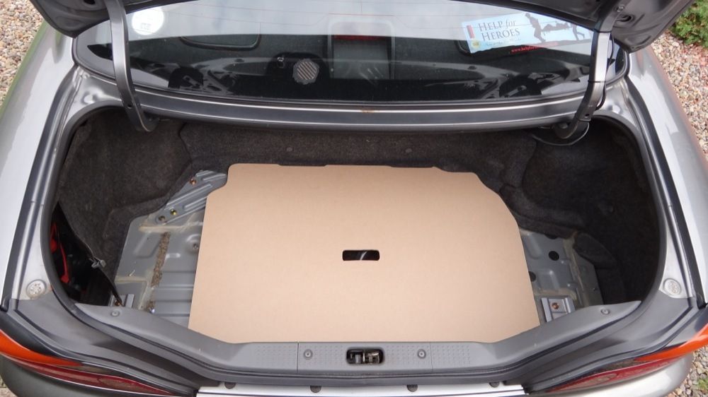

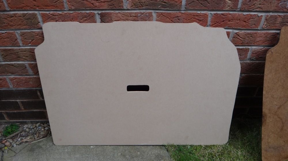

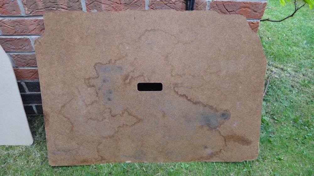

Seeing as Project Lolita has (for the moment) been a restoration project, i've headed into the boot. The old wooden spare wheel cover/shelf was warped from spilling things on it, and general heavy things on it all the time (jacks, wheels, etc) so decided it was time for a new one. Time to head to B&Q. I opted for some 6mm thick MDF as its a little bit sturdier than the current hardboard, and its cheap as chips.
So we went from this:
with the aid of a pen and a jigsaw... to this:
fitted:
Easy hours work :)
