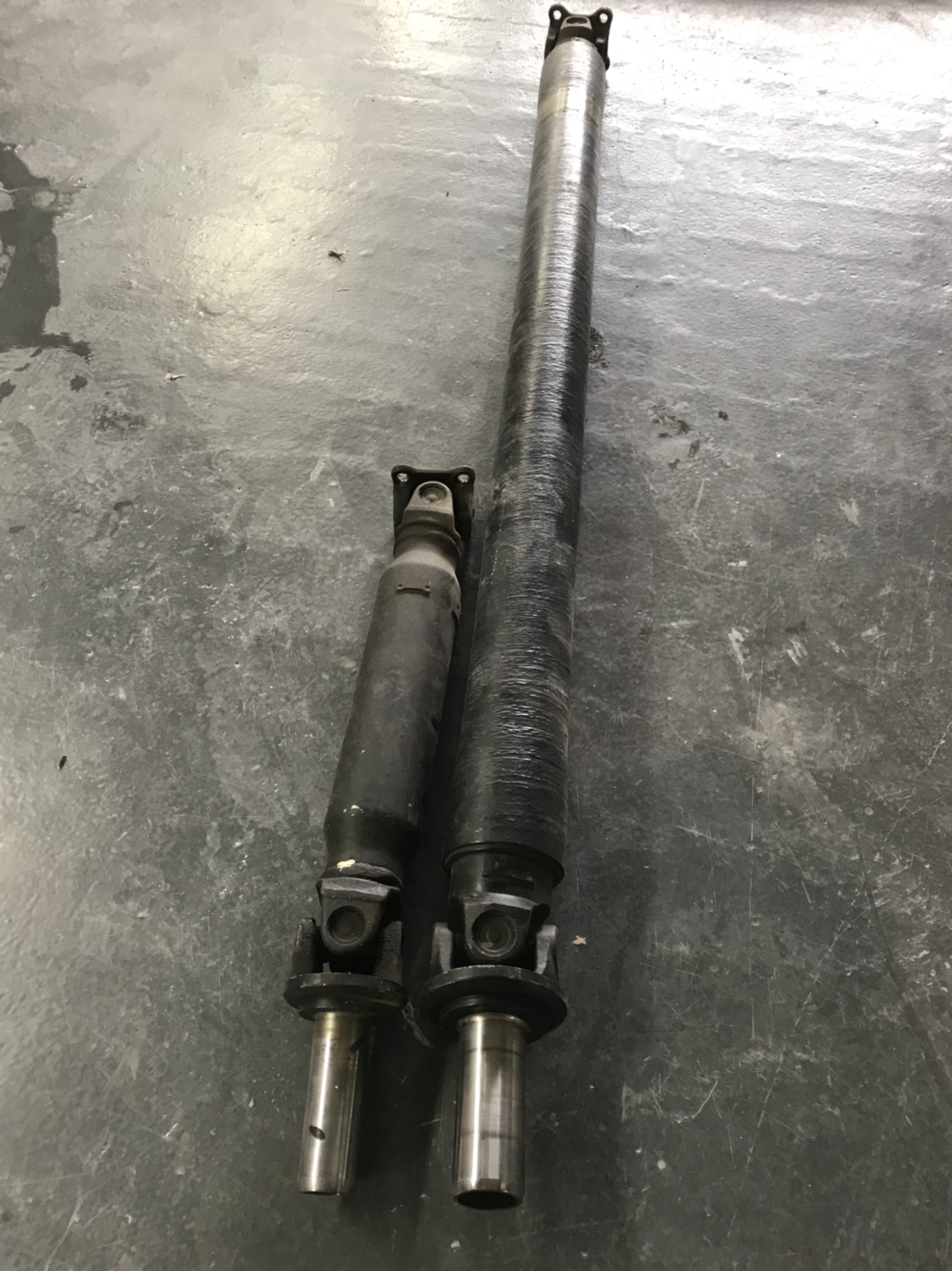

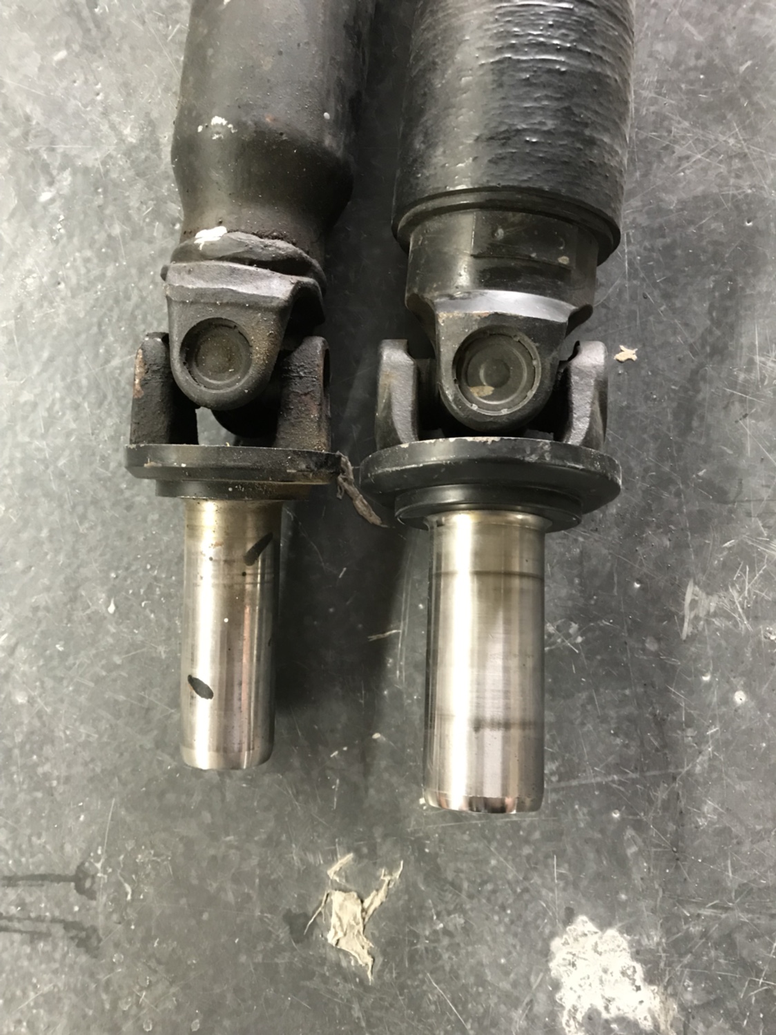

Got my prop here ready to go off for modification now .
Not many parts left for the build it’s just a case of finding the time to make it happen really!
What box you gonna run mate Z33?
