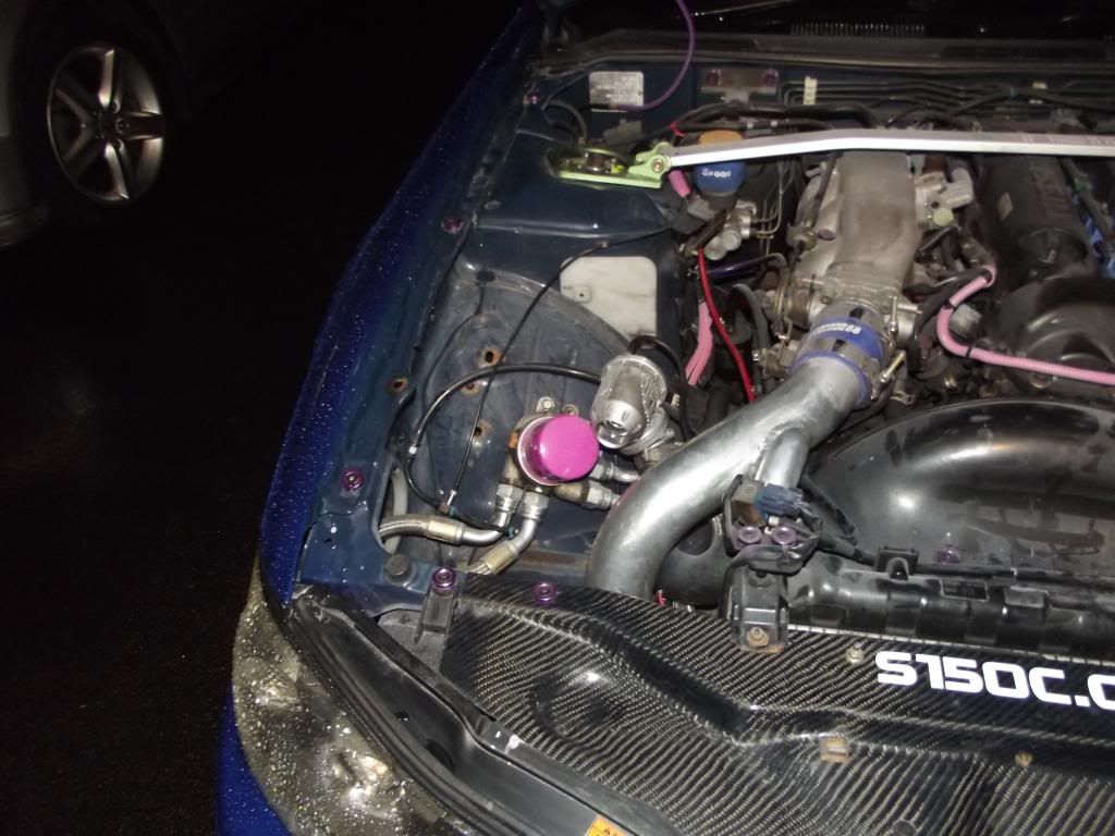

When I was looking through the pictures on the first page I noticed your oil filter sitting low, has it actually been re-located to that position? That seems like a really weird place to put the filter. The outer casing is really soft ali, so the smallest knock could rupture it, the car doesn't look particularly low so it may not be a problem.
I'll try and get a better picture of this later as i was worried and hence asked on here a while back and was told the lower the better, so that you can drain the cooler lines properly, aslong as it's above the chasis rail?

As above mate car is coming along nicely,but I agree with adam that filter seems very low maybe worth moving it if you intend to go lower at some point. Very nice though! Do like a blue spec r

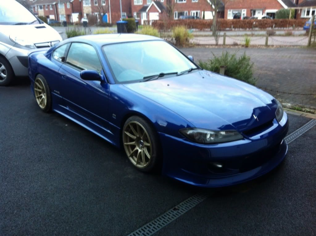

I think after a year that an update is long overdue! Although not great, an update will certainly be better than none as if any of you are like me you will be checking almost everyday whats new on here lol.
Some of this may not be in the right order due to me going off of pictures to try and remember back to the order it happened.

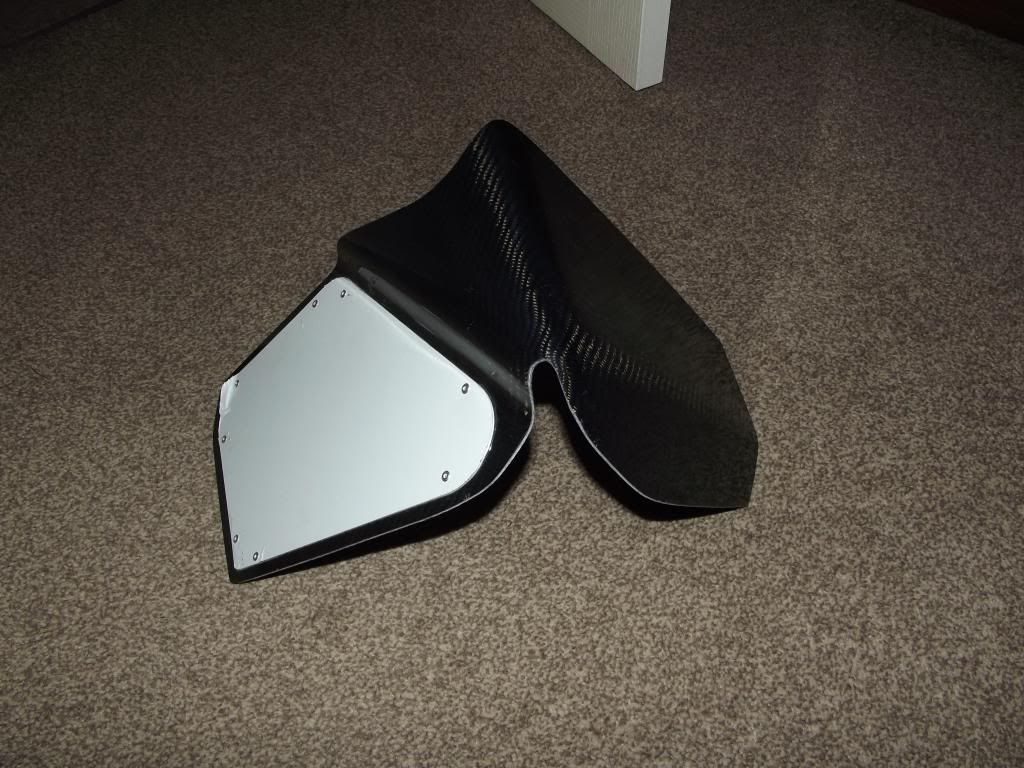

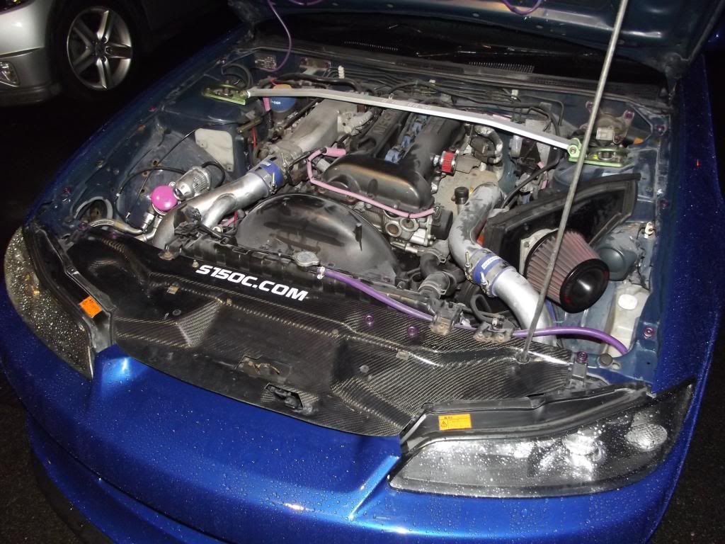

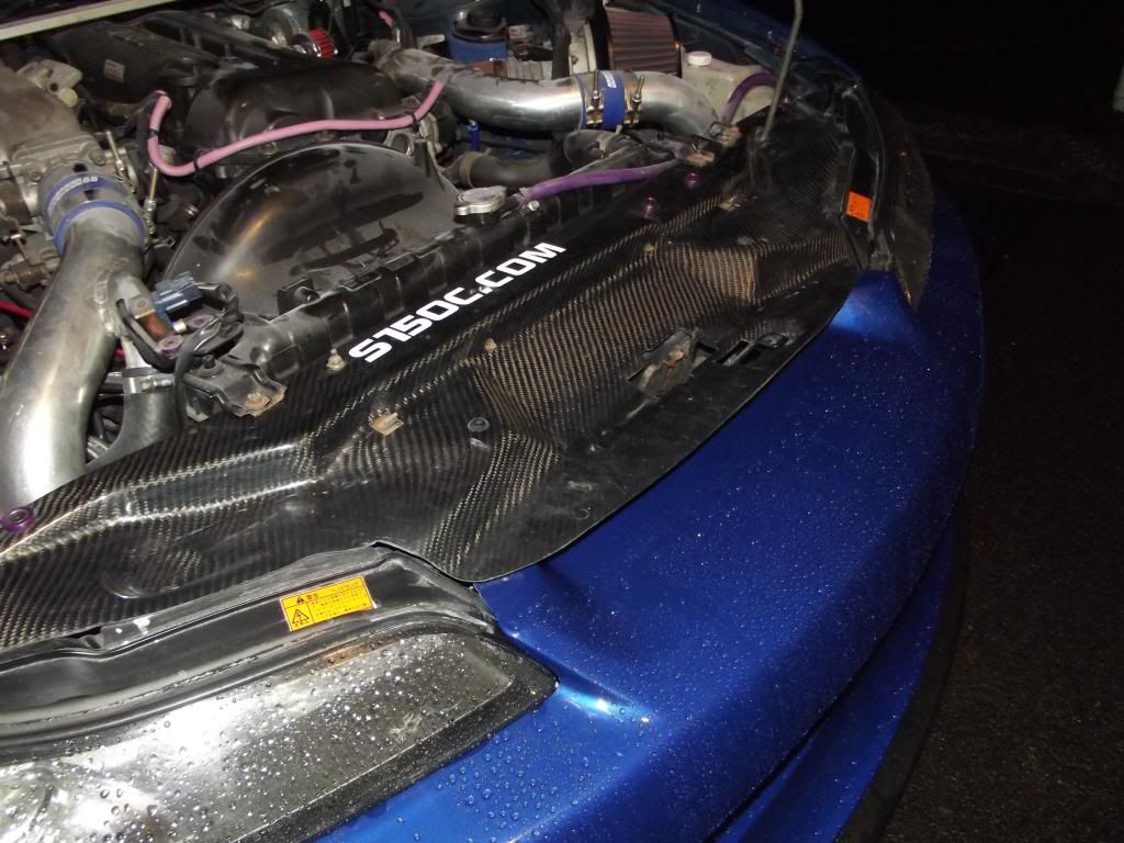

Firstly, was the carbon cooling panel i got from here. No picture of when i first fitted it, so just ran out to get one now. Hats of to craig on fitment, took a few minutes to fit and really neatens up the front end. Hiding that bonnet catch. Had to bend the support bar to allow it to sit properly while the bonnet was down.

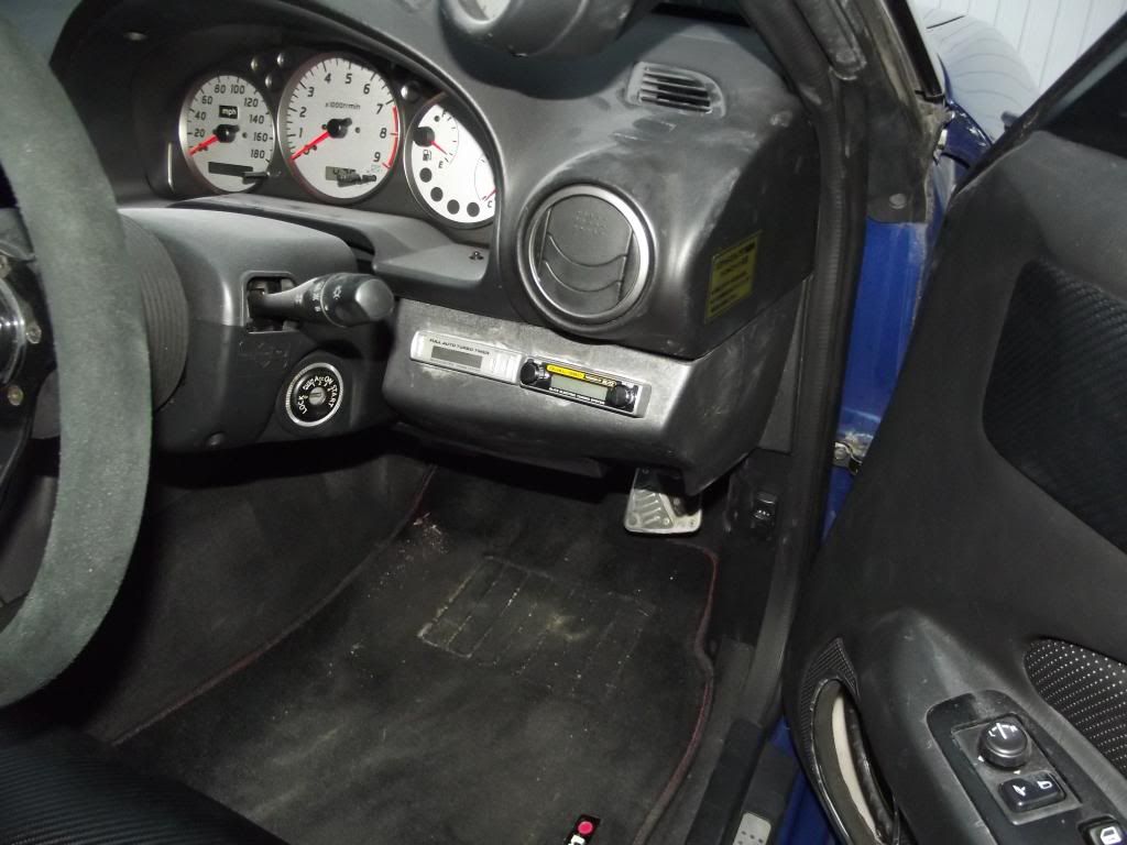

Next was fitting the blitz boost controller along with the splitfires and walbro fuel pump. I really wanted the car mapping but no one in the uk seems to be able access the tomei ecu, so that will be something to change in the future, maybe for an aem system, unsure yet. Anyway i went with just having the car set up on the rollers, it made 331bhp at just below 1.4bar with a low setting of 278bhp. Which is much nicer to drive than the higher setting, the 2 way has gotta go!

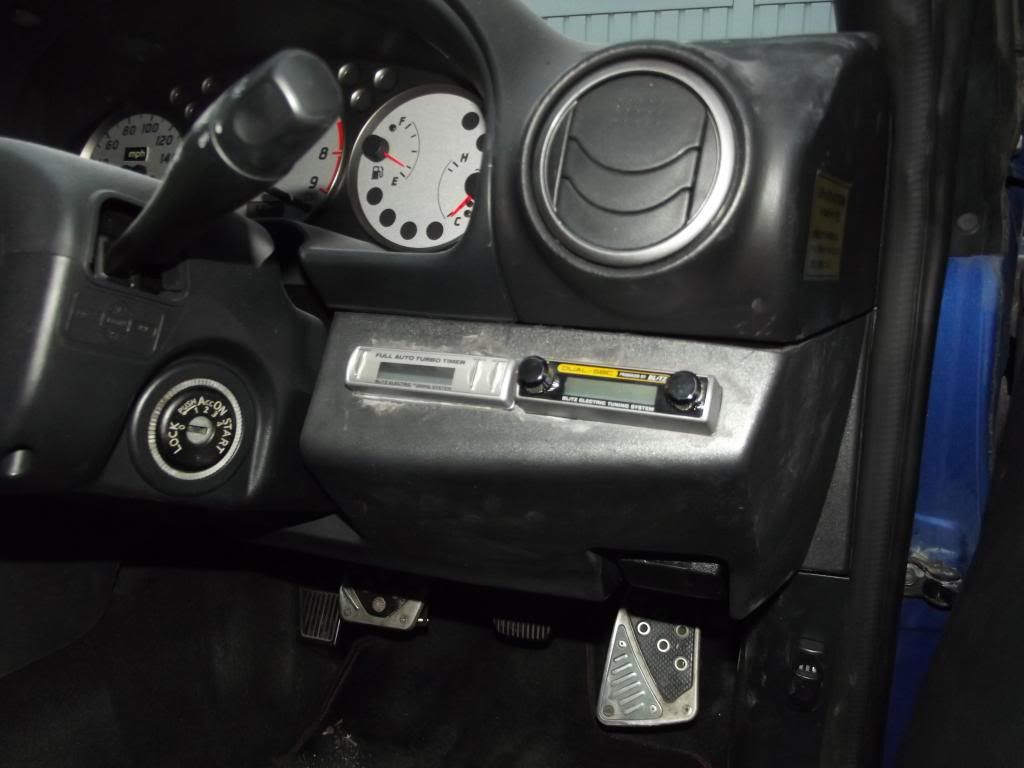

At first i had the controller below the cd player in the central tray but due to not liking where the turbo timer was (that you can see in the older post) i decided to get a upper dash vent and move both to the right of the steering wheel, plan to get the dash flocked at some point so ignore the filler and dust!

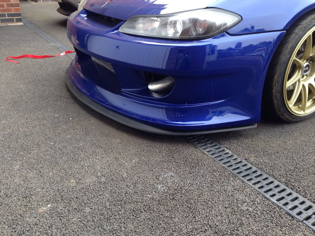

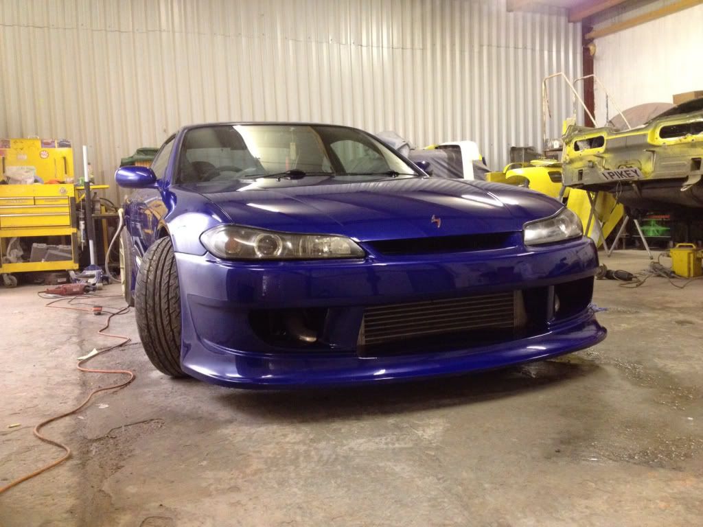

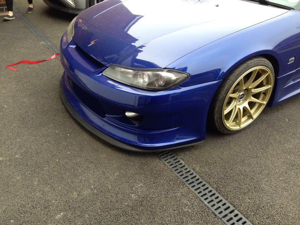

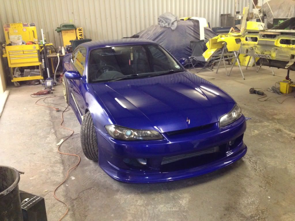

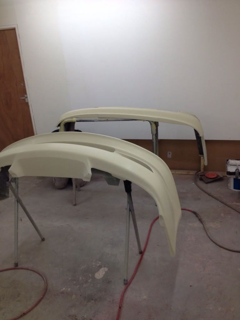

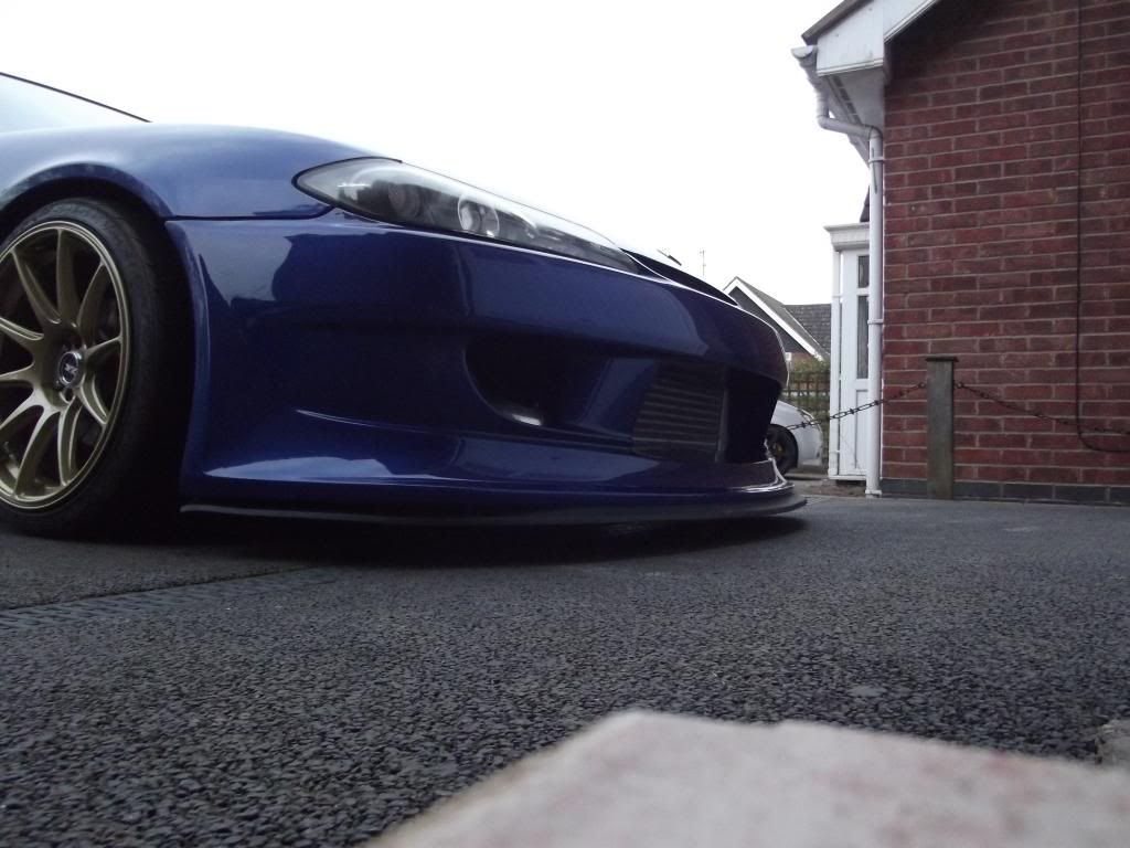

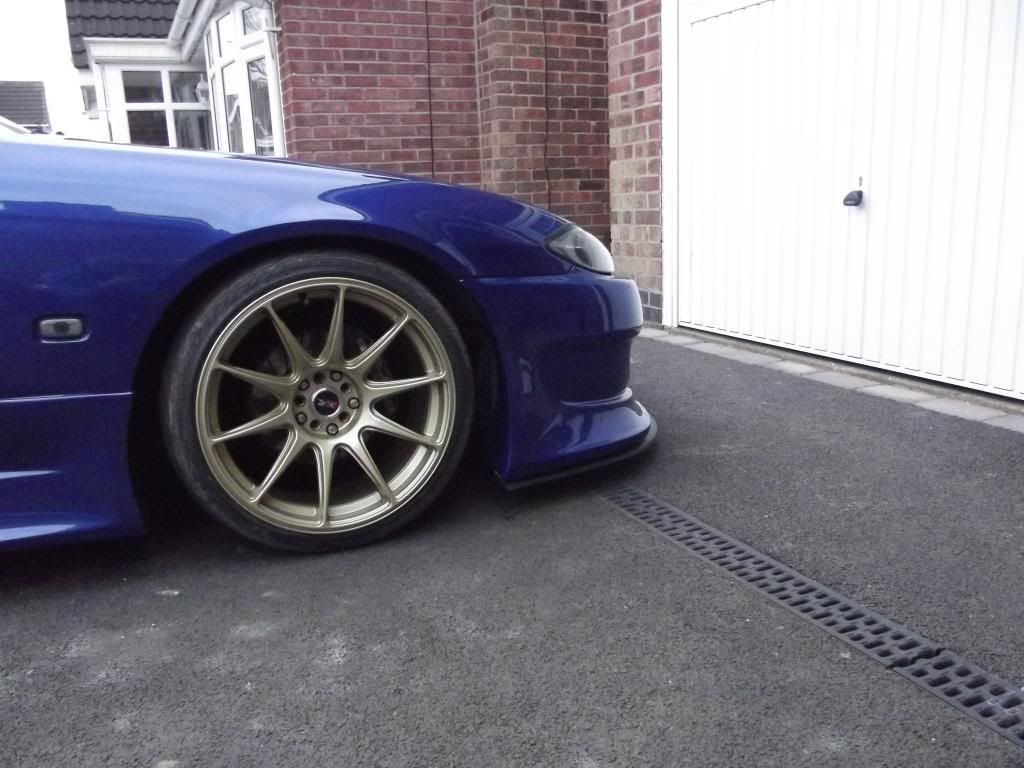

Next was aero, decided on a vertex lang kit, can't find any picture before fitment other than this.

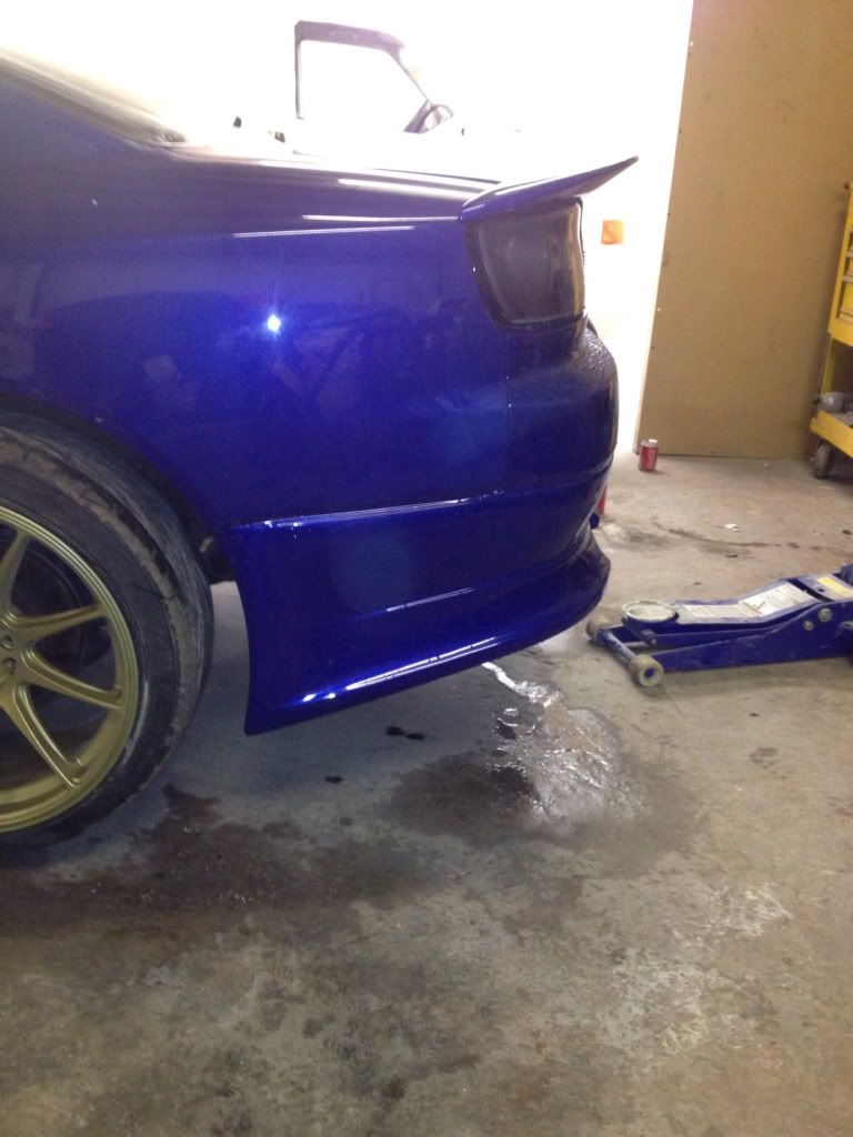

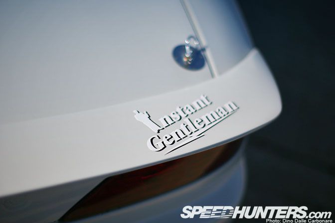

Went with a Instant Gentleman rear boot spoiler too, like this one..

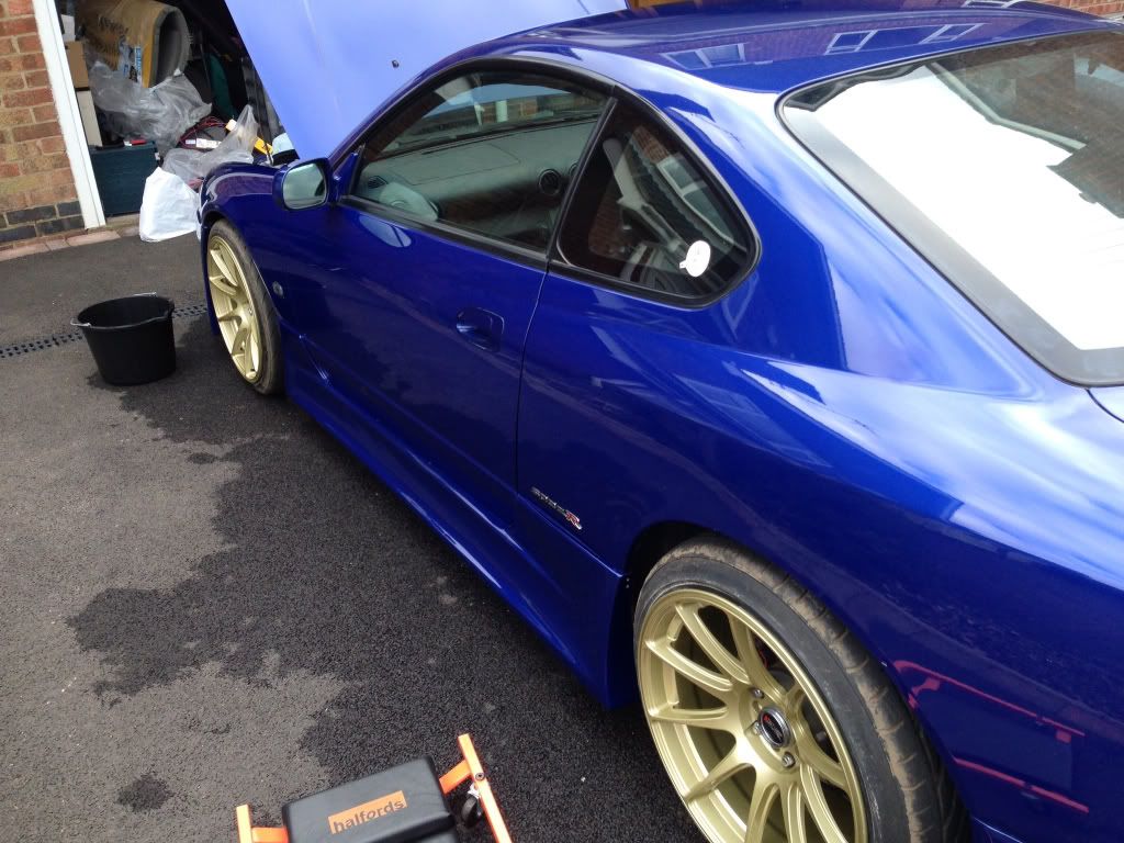

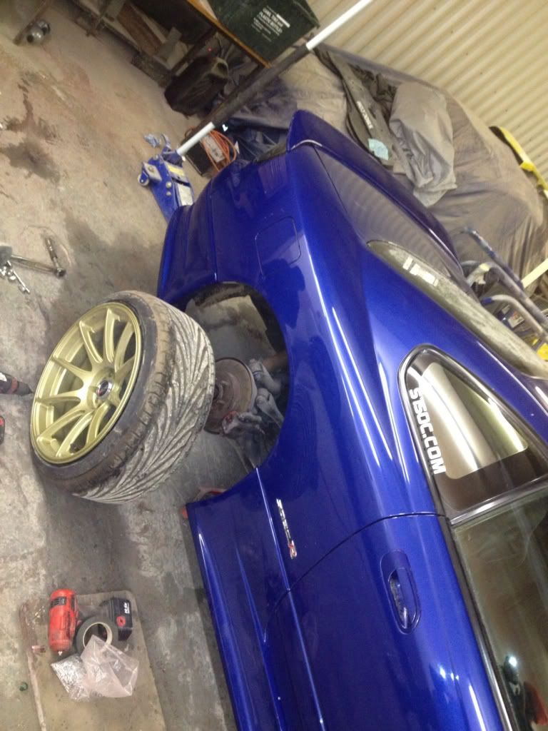

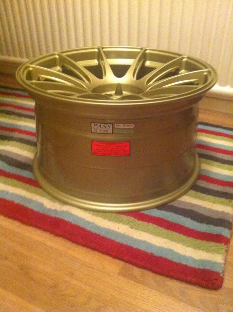

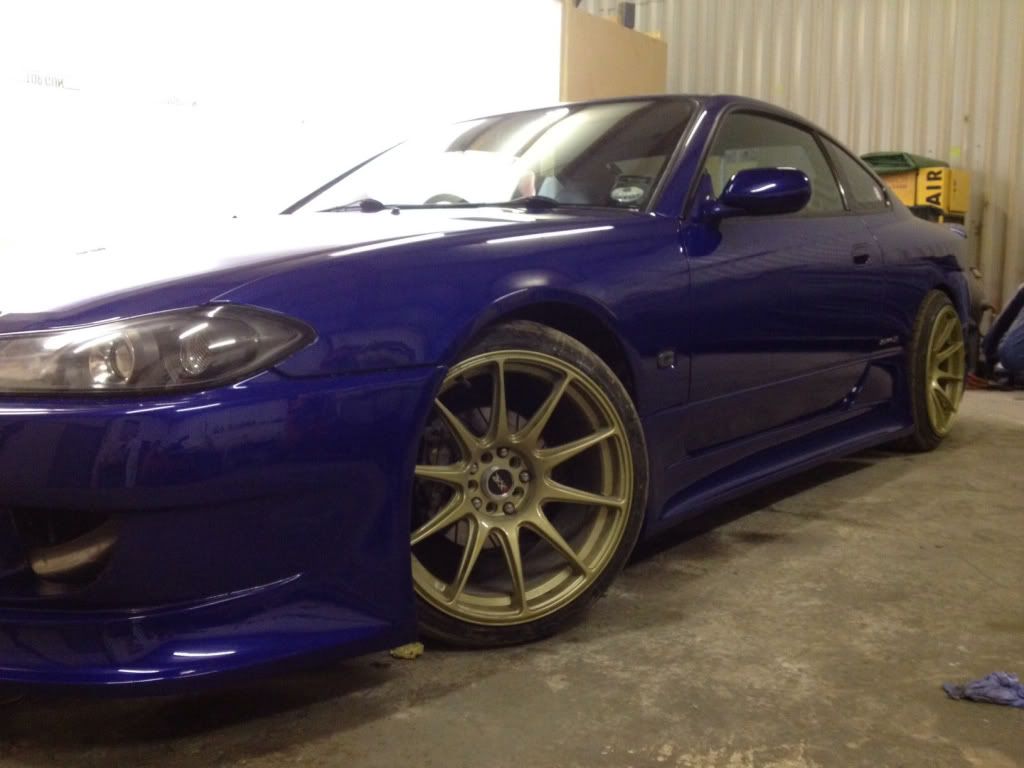

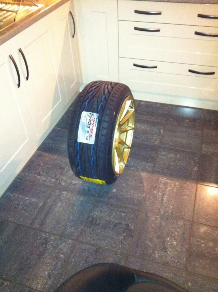

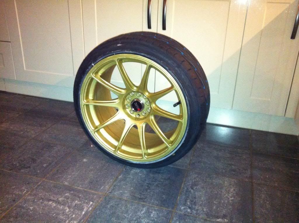

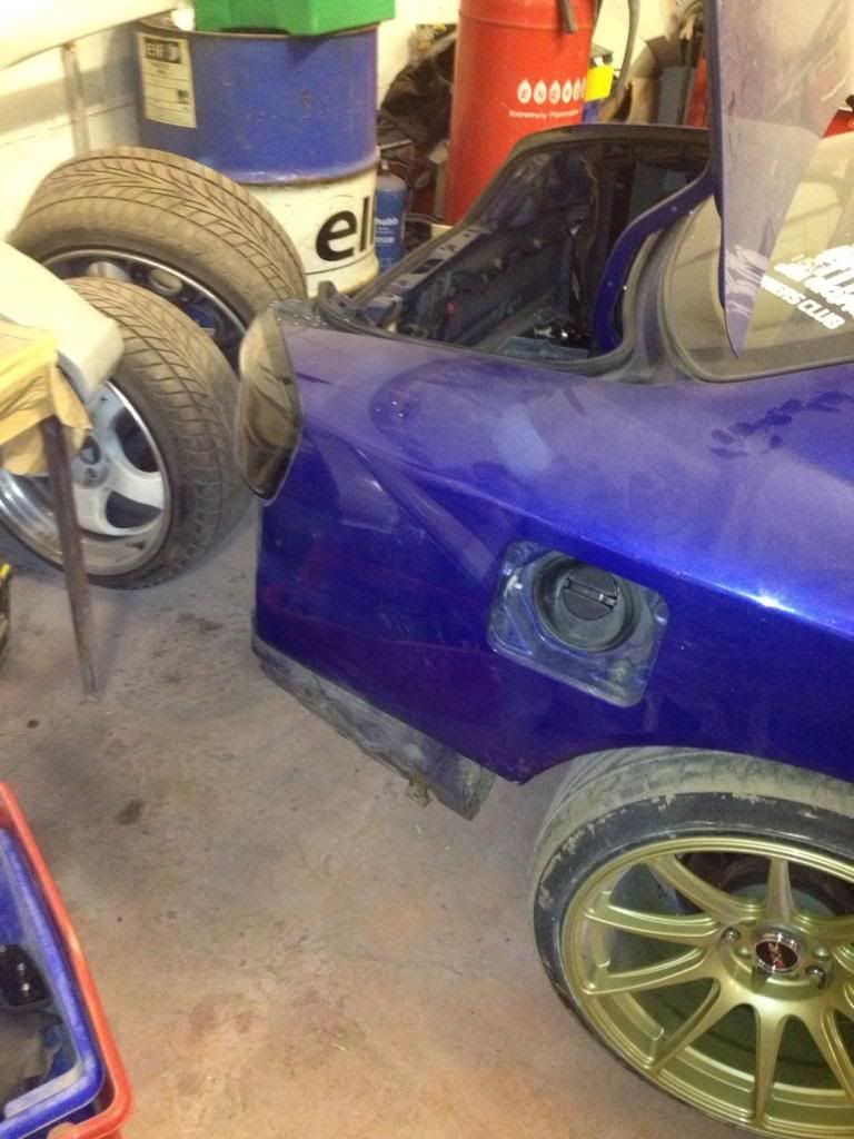

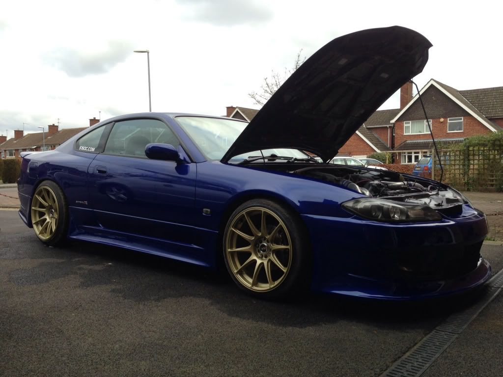

Also decided it was time to change the volks, loved the wheels just wished they were 18's and had more aggressive offsets. I went with xxr 527's 9.75j+20 rears and 8.95j+20 fronts.

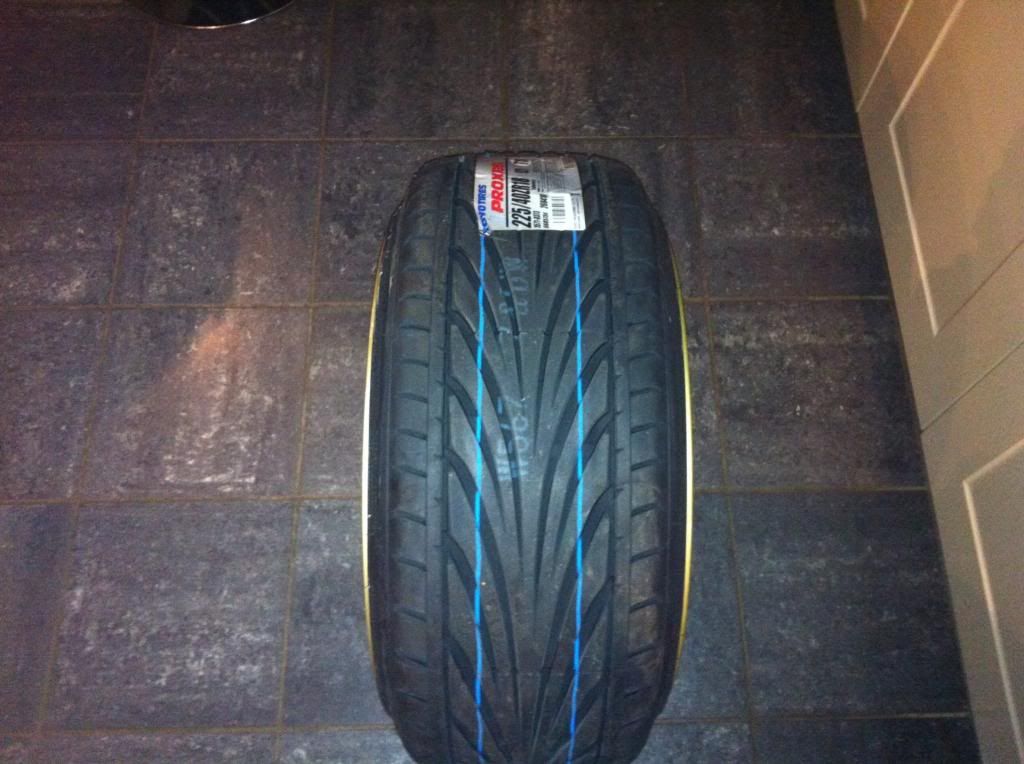

I went with a stretched tyre on the rears as i was expecting arch clearance issues. I went with 225's on the rear and with 215's on the front. Rears are toyo t1r's and federal fronts.

Also some picture of the rear wheel fitment.

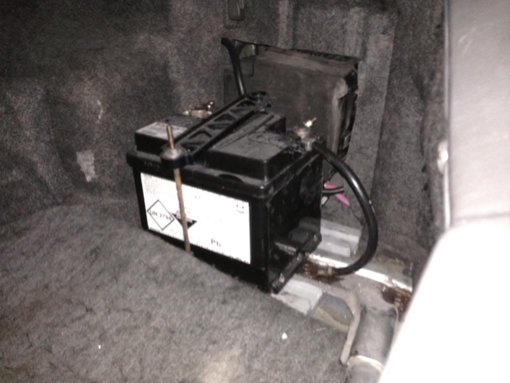

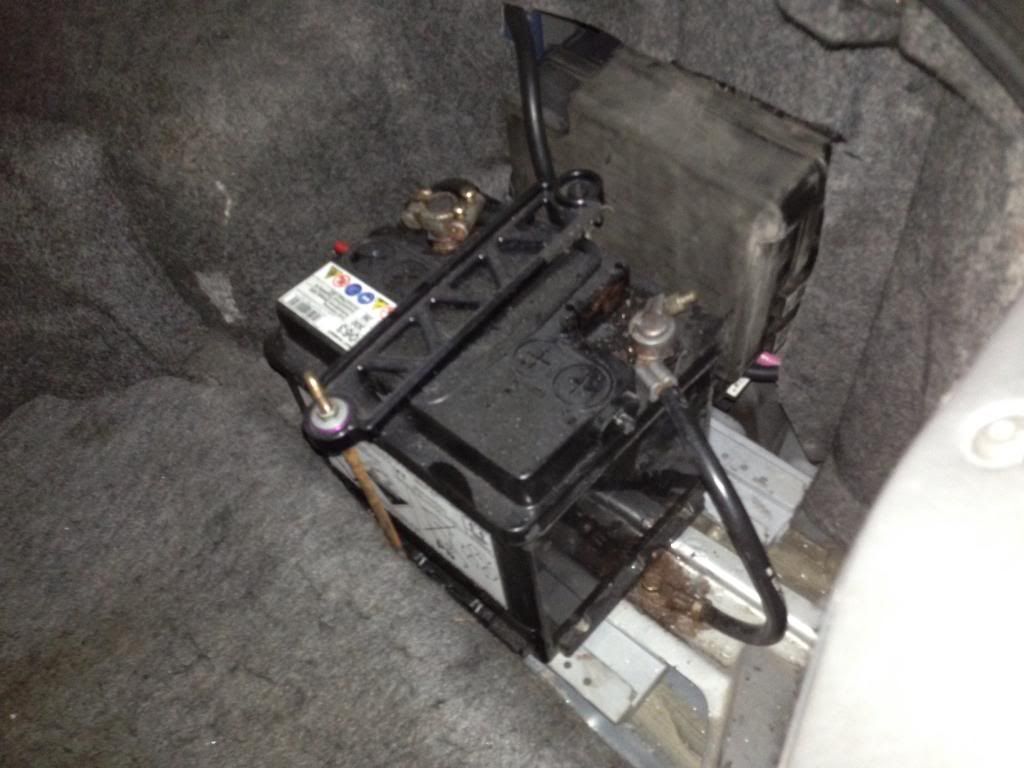

I have also moved my battery and fusebox to the boot, didn't fancy going the passenger airbag way like many others. It was quite a bit of work but easy when you have the time, a lot of soldering and unfortunately i don't have any pictures of the process, but i went around the turret of the bay so the only thing remaining in the drivers front arch is the bonnet release cable. Sorry for the iphone pictures, they're all i have, i went with a ventilated battery with the fusebox fixed behind it.

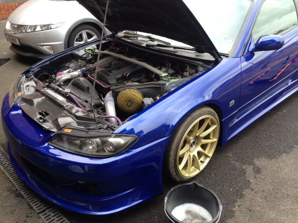

I then went about moving the oil filter relocation kit to where the fuse box used to be. Along with new oil lines. Hks! :cool: the next engine oil swap will be a little easier!

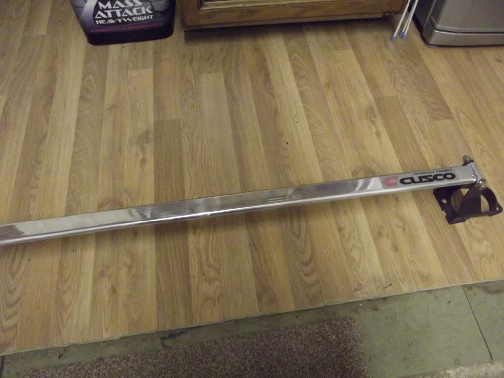

Also got an apexi filter and a tein strut brace.

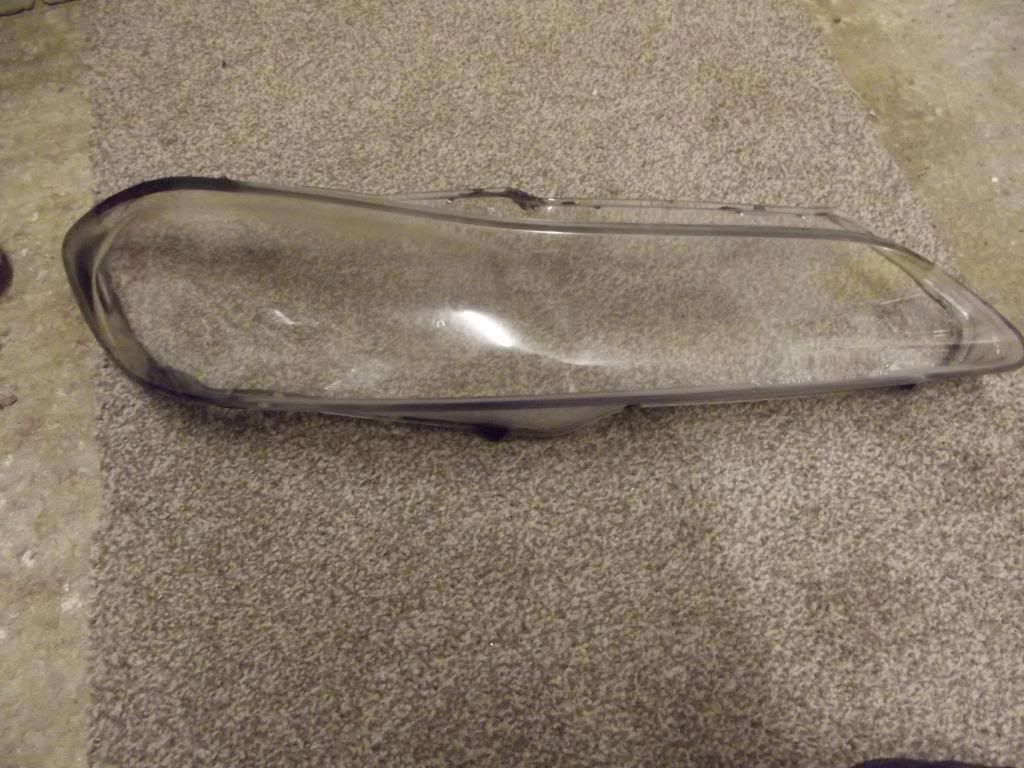

I got a new lens from jase for the drivers side light, due to mine having a really deep scratch on the outside, but haven't grown the balls to put the light in the oven yet lol.

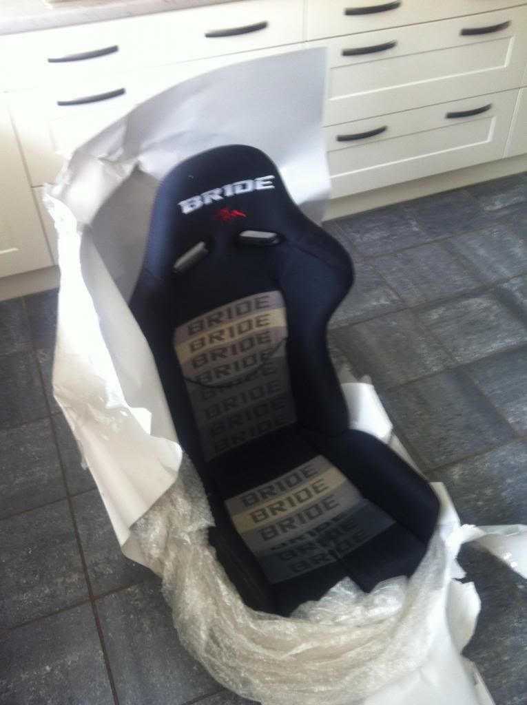

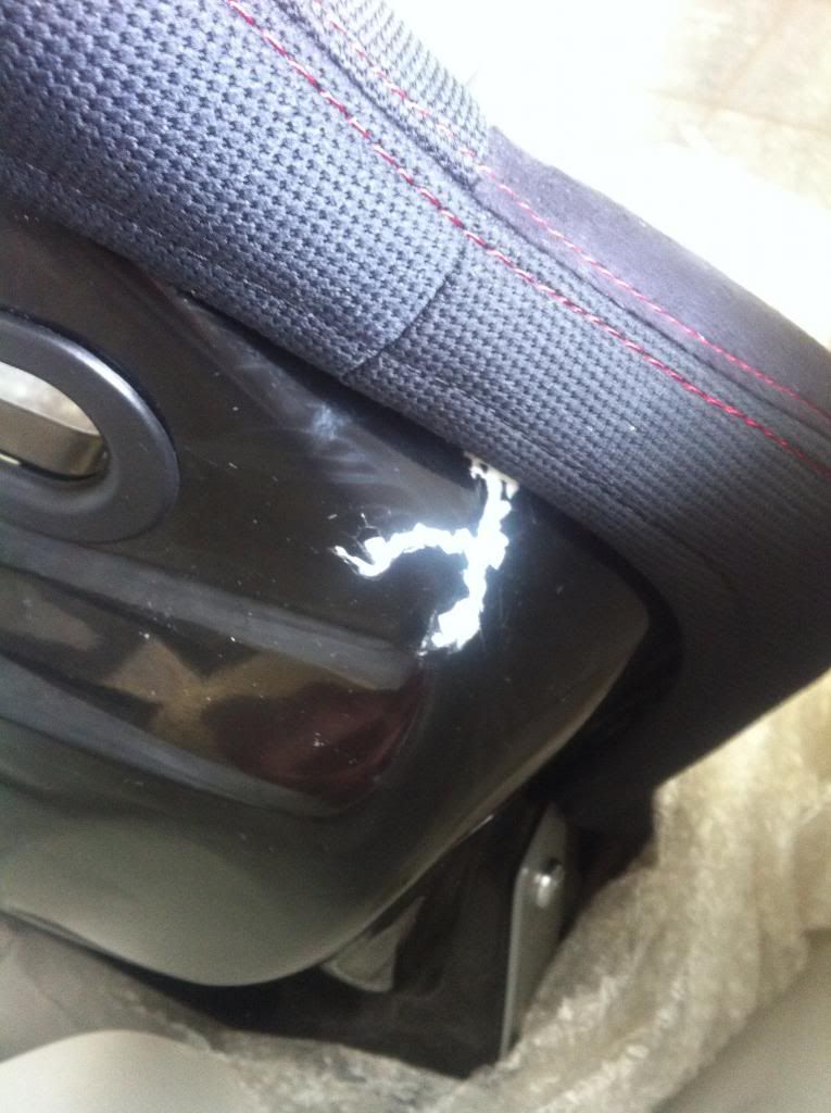

I bought a fake bride but due to a crack in the rear on delivery i sold it on. :(

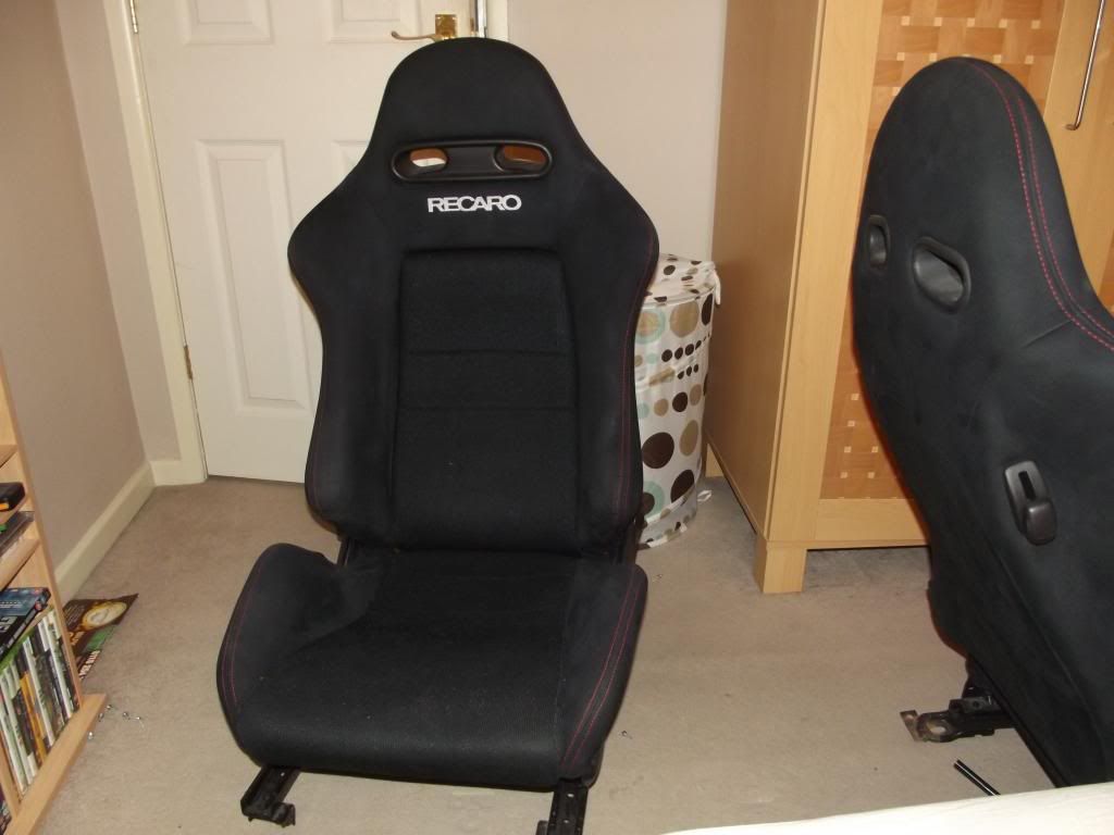

Which led to me buying Dc5 recaros, they're so comfy, but i haven't had any luck fitting them yet. I'm told that bride rails are they way to go but very expensive brand new, so leaning towards custom rails. I had a go fitting the standard rails but to make them fit they would of sat very high.

What front splitter do you have on the bumper, looks really nice!

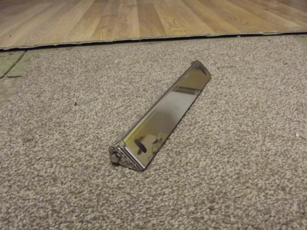

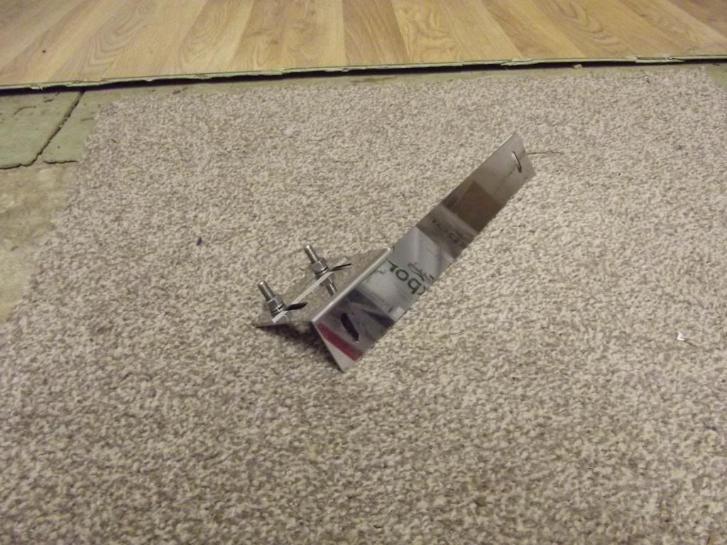

I fixed a slotted grid down with tek-screws and then used a tegiwa battery tie bar kit to hold it down to the grid, been looking into battery boxes but it seems plastic is the way to go due to oxidisation.

Can't seem to find it, it was advertised as universal and the picture was of it on a z4. Will keep an eye out.
