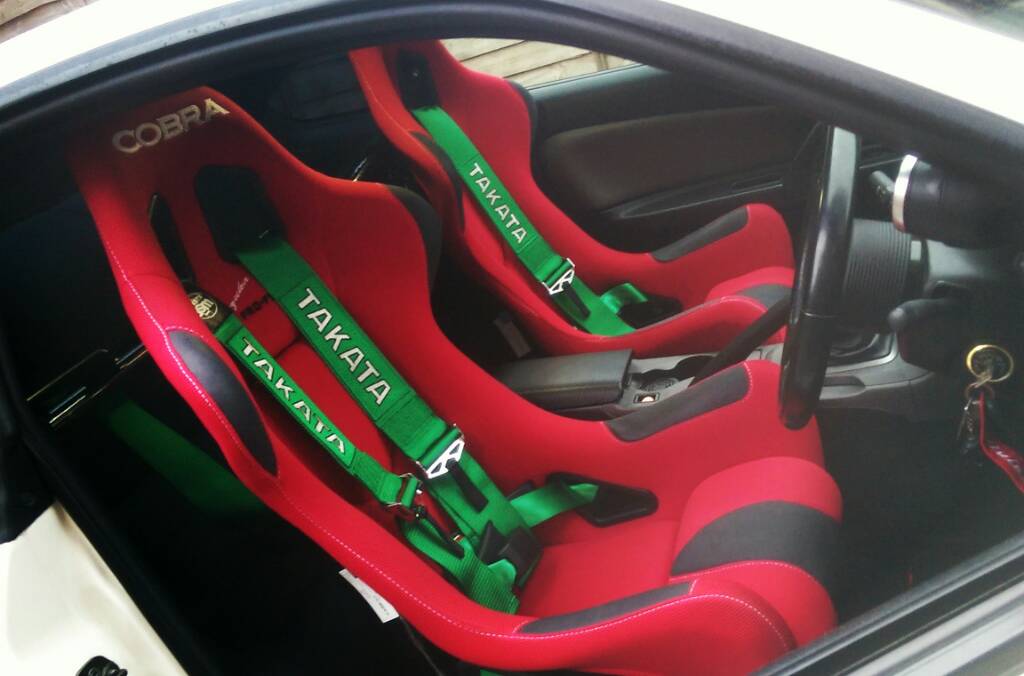

Got my harnesses in and harness bar
Safety first 😊 can't wait to get on a track
