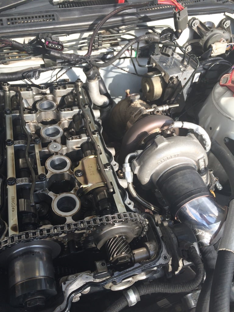

Few mods since mapping :
Rocker cover off :
Rocker cover on :

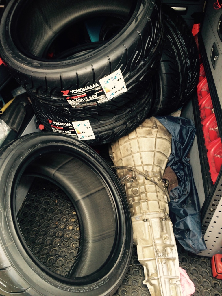

Well I knew my 6-Speed wouldn't last long but it ended itself.
Would barely go into third & fourth.
Garage - D overhauled box purchased for the time being until I do a 350Z conversion.
4 new AD08R's for when the new wheels arrive :)

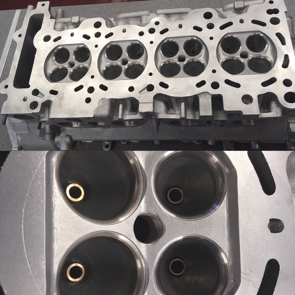

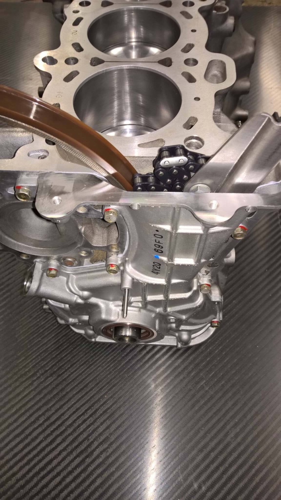

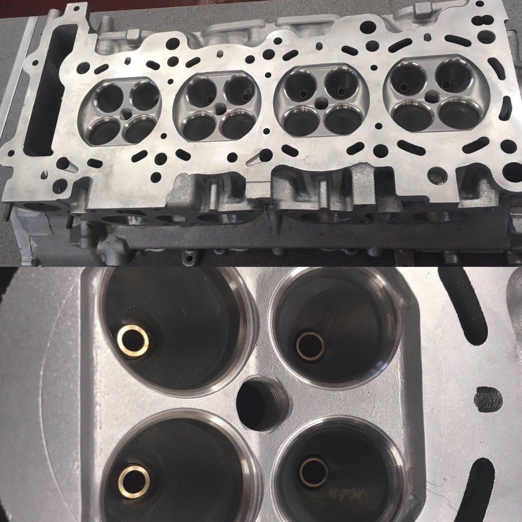

Hi
Quick update:
Il let the pictures do the talking :
The above pictures are for my spare engine.
Block:
CP Pistons
Manley Rods
ARP Main Studs
Unground Stock Crank - Polished
Head:
OEM valves
5 Angle Seat
Mild Porting
Still a few bits to order up.

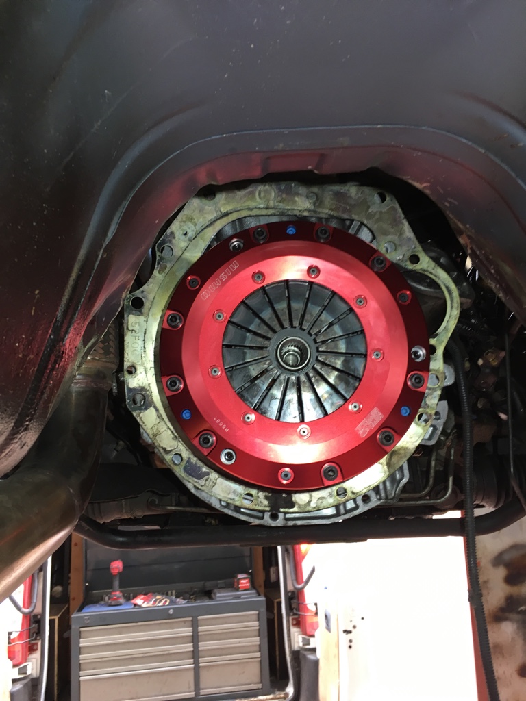

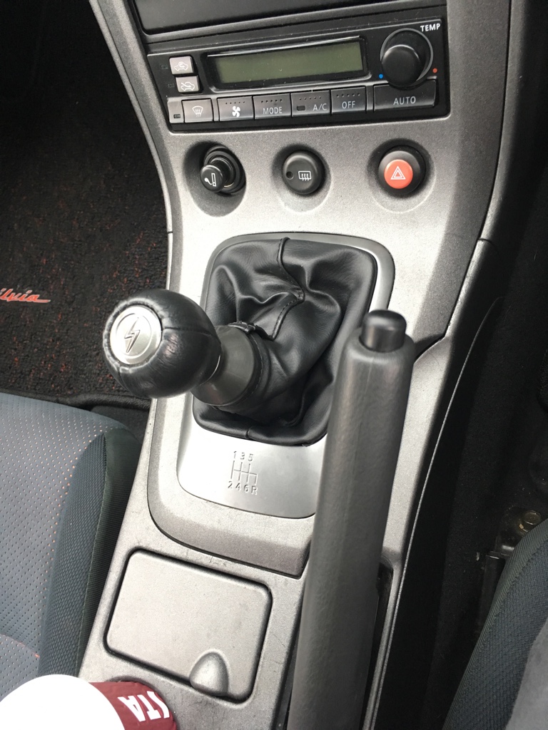

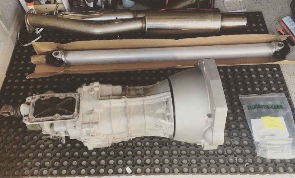

I've also blown my 5th OEM 6-Speed up.
Yes 5th.
I'm now running a Low Mileage CD009 with a Brand New Nismo Twin Plate S14 Clutch Set Up.
The Box is great.
However it's a noisy t**t.
Just because of the backlash on the box due to running a Single Mass Flywheel as most CD009's are connected to a DMF.
Low RPM's there is box noise and a slight chatter from the Twin Plate but once you're moving it's golden.
The Mazworx kit was easy. Everything worked out fine.
Cutting the box was the only nerve racking part.
The shifter set up is GKTECH. It does what it says on the tin.
The box is punished and it's been 100% faultless.

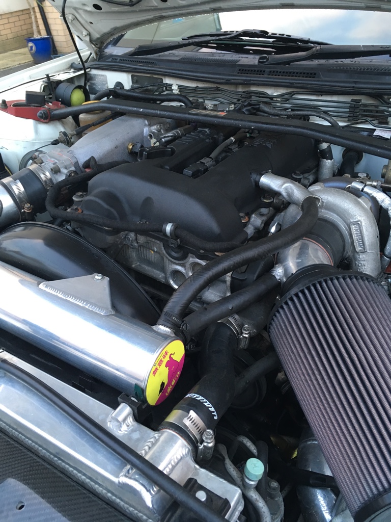

And a little engine bay picture

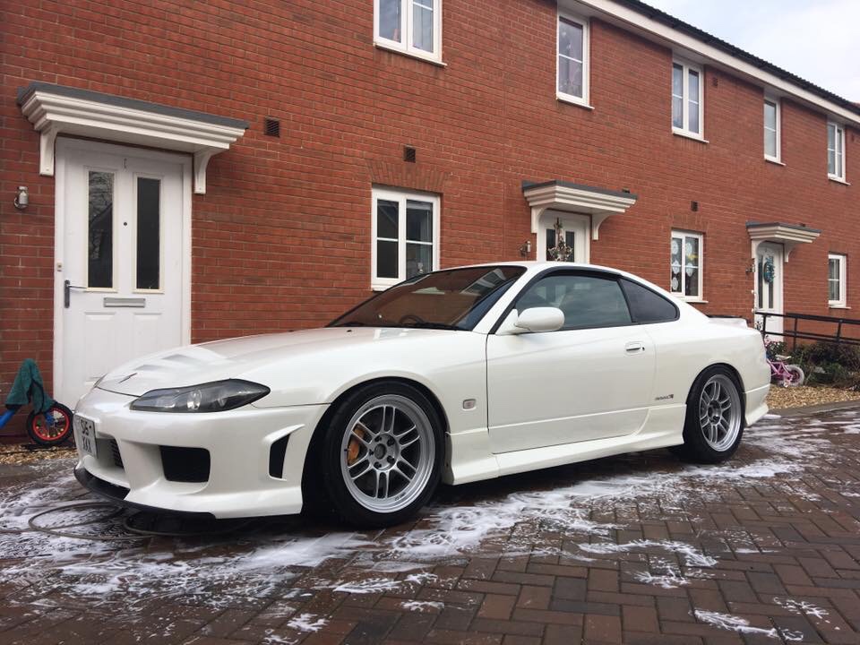

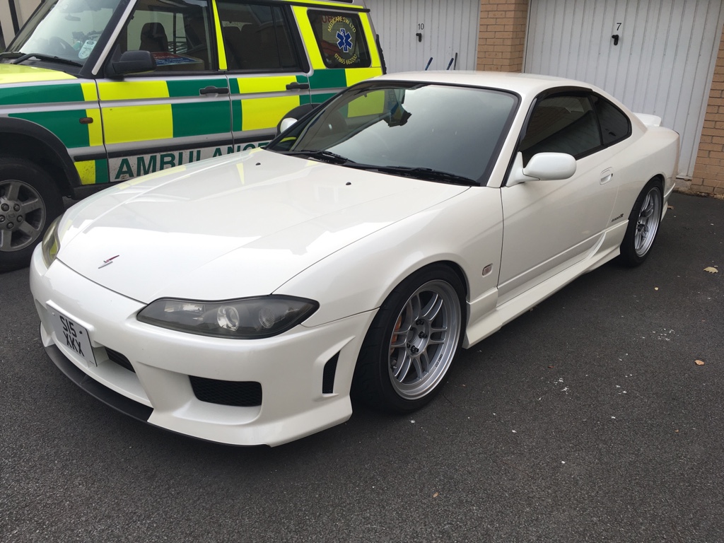

AND I have new wheels.
It's been a while since I posted
ENKEI RPF1's
9.5 Rear's with 255 AD08R Tyres
9.5 Fronts with 235 AD08R Tyres
Can't remember offsets.
Fit well. Fronts rubbing a little on the front.
Guards rolled out a little all round.

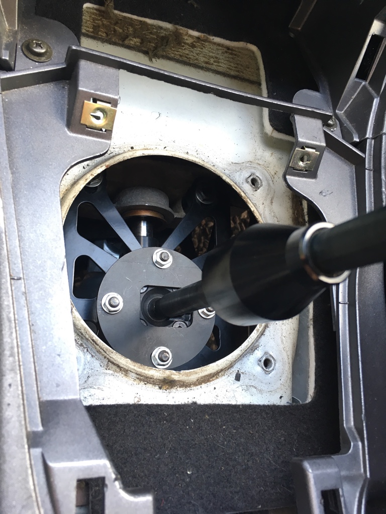

Love the wheels , really suit the car ! Adam had some on his they look great . What made you go for the gk shifter rather than the mazworx dude ?
JackPilk
26 August 2013
120
Devon
Cheers dude.
I went with the GKTECH shifter set up due to it promising a much better location without having to cut the tunnel back so the Mazworx one can fit in.
To be honest I probably will change my shifter set up to a "SerialNine" one.
My GKTECH one rattles badly at high rpm and I have tried EVERYTHING to try and stop it but no luck.
