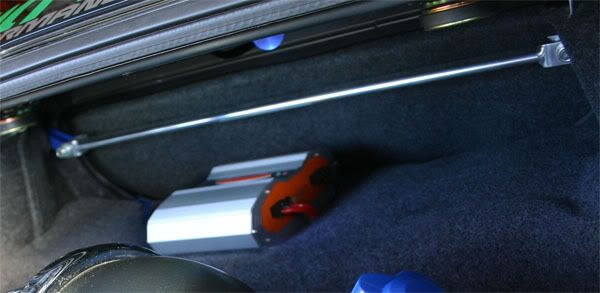

here's my recipe for handling on rails...
Take one s15, add HKS Hiper Max D's 10kg F / 8 kg R springs, mix in with Cusco strut braces front and rear, Do-luck Room bar and sprinkle with -2.25 degrees front, -1.95 degrees rear. Once baked until golden brown, add some 225/45/17 tyres on a 17X8 rim and 245/40/17 tyres on a 17X9 rim on the rear. Finally garnish with adjustable rear camber arms and presto - one S15 handling on rails!! It works for me :)
256
can post pics when i get home from work, mine sits under the parcel shelf so its fairly stealth :)
didn't realise they had anzac biscuits in the uk hahaha
