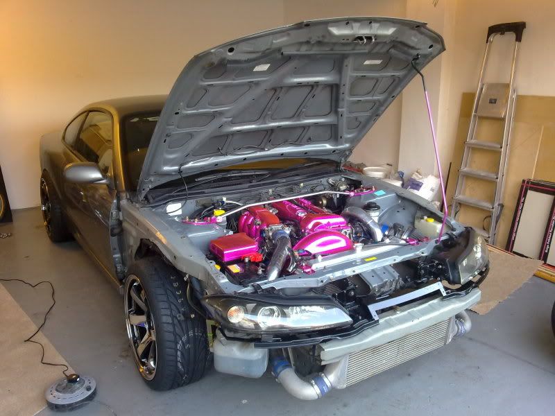

Well I spent most of the weekend getting the car ready for its trip to ABW so it can have its body mods done. First off I changed the wheels which meant I had to put longer studs up front so it would take the 10mm hubcentric spacers.
Next up was the removal of the front bumper and front wings, again this was a very simple job to do and took next to no time which left me plenty of time to to give the car a good clean where the new parts will be going. So this is how it looks now:

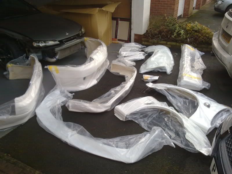

Then today I took a trip up to collect my bodykit........lucky I took a van as I can't believe how many parts there are.lol.

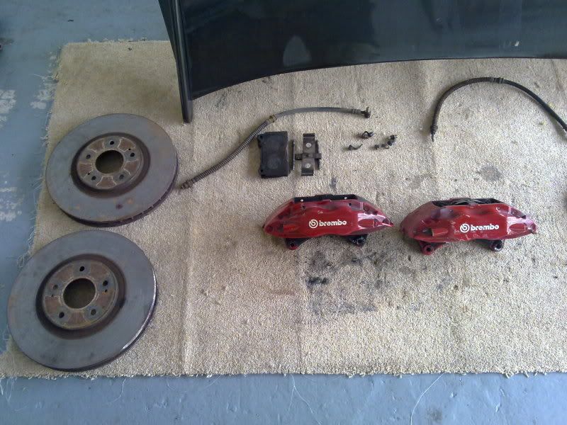

The car is now in primer so hopefully I should have some pics soon to post up. While the car is down south I thought I would upgrade my brakes and get myself some Brembos. Found some excellent Evo 9 front calipers and brake disks at a great price:
Next thing to do is strip them, prep them and then spray them in a candy colour to match the engine bay bits. Also I will have to get an adapter made up so that they will fit on my car.

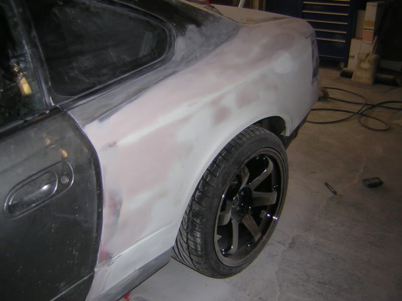

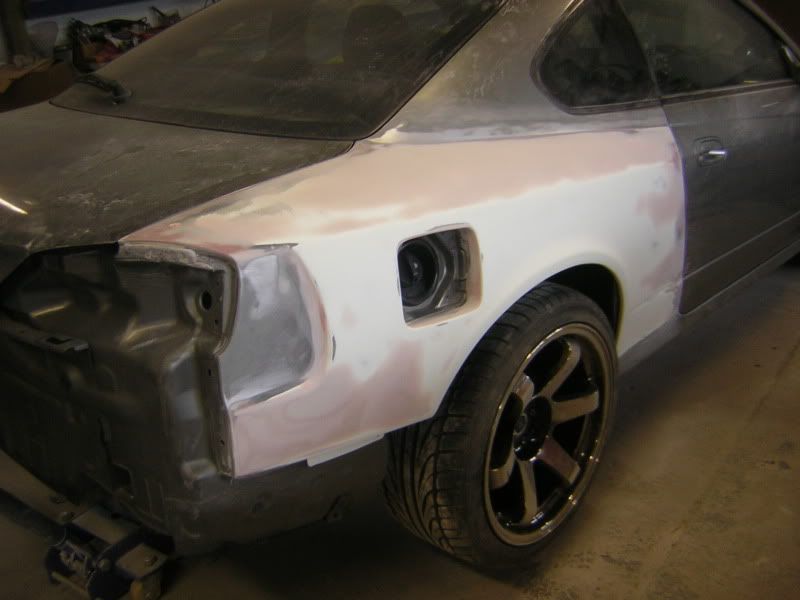

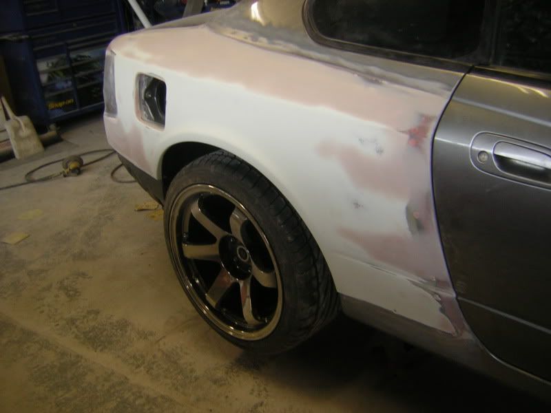

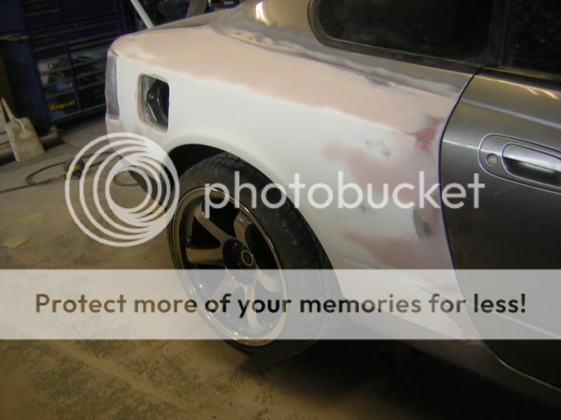

This is when the rear arches were put on and then blended in. Daren (ABW) had to layer them up to thicken them as the arches were a bit on the thin side for his liking (perfectionist). Also he cut out about an inch of the rear arch to give more than enough clearance for my wider wheels and also if I wanted to slam the car lower at a later date.
Heres some pics to see the 50mm wider arches:
