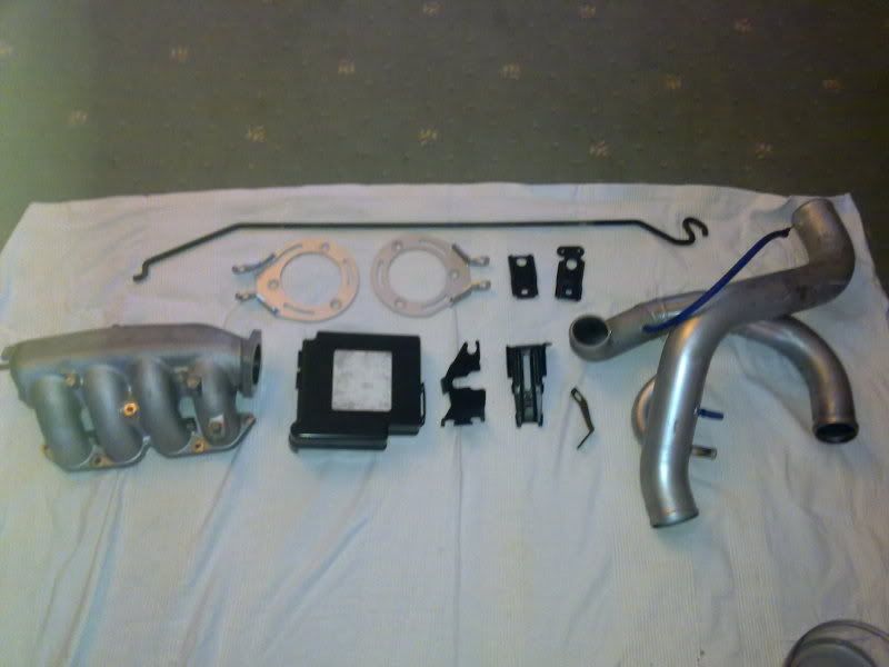

The car has now been stripped of bits so they can be prepped, sprayed or polished and the mods have started. First lot of bits that were removed were all the smaller items:

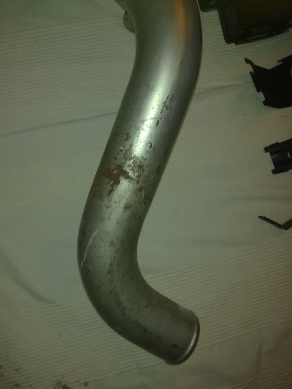

The HKS intercooler pipe work had been coated in some horrible grey paint and they wern't in the best of condition as you can see:

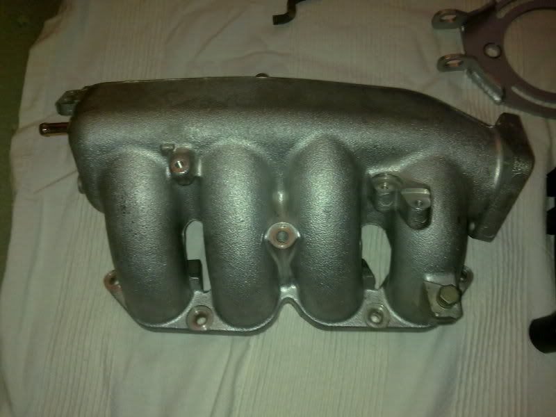

Also the plenum as you all know has a rough texture to it which I am not so keen on:

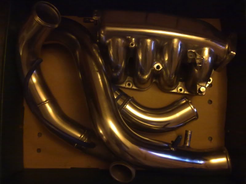

After hours of grinding and polishing they all came up really well, like new:
Even though I have polished up the plenum I have decided to paint it anyway, but at least I will get a smooth shiney finish like the cam cover.

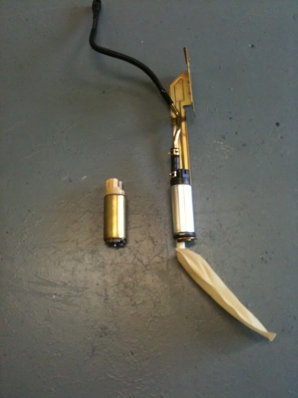

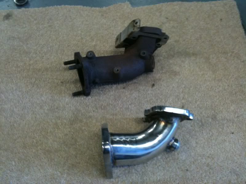

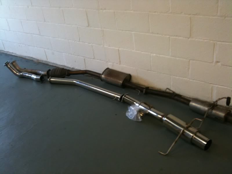

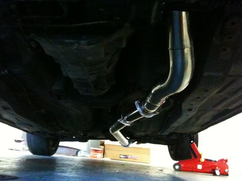

Next up was removing the exhaust and replacing it with a 3" Japspeed system, the only problem is that I wanted to totally decat the car but Japspeed dont do a decat pipe for the system. Luckily a mate runs the Japshop which is just round the corner from me and after measuring up what decat pipes they had, we found that a R34 GTR 3" decat pipe matched up perfectly, even the angle of the end plates which was nice.

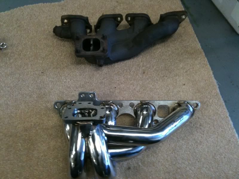

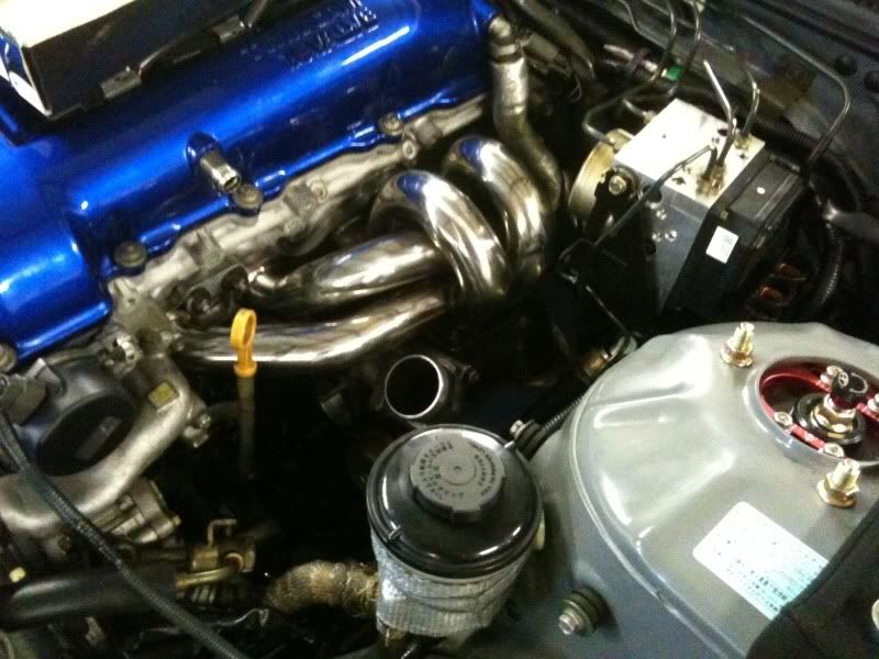

Whilst doing the exhaust we also did the manifold, turbo elbow and fuel pump:
The manifold looks great:

Looks ace mate!!! :)
Lovin' the polished items like the plenum - top job that one :D Can't wait to see her when all the mods are completed...
What did you use to get them all to polished up like that? and did you do it yourself?
Cheers..

Yep, did it all myself as it works out quite expensive to get a company to do all the bits.
I used a wire brush disc on a grinder first of all to get the paint or texture off, then a few different sanding discs of different grades and then a very fine wet and dry paper, finishing with the best stuff in the world for polishing......Autosol metal polish.:cool:
The good thing is that when all the bits are fitted back on the car the finish will get even better over time if I keep using the autosol.;)

Do you have a better pic of the plenum? how did you get into all the tight corners?
I polished a couple of pipes on my previous car so might give this a go :thumbs:
