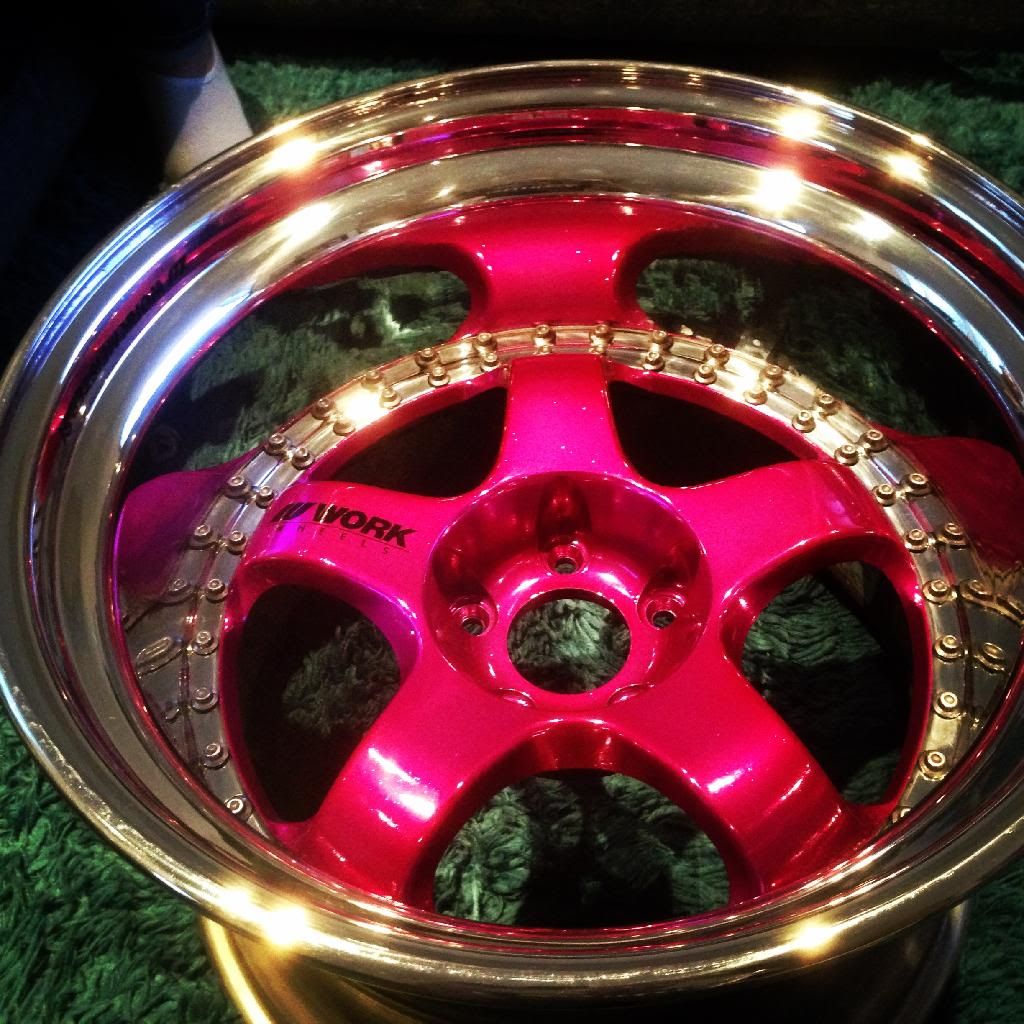

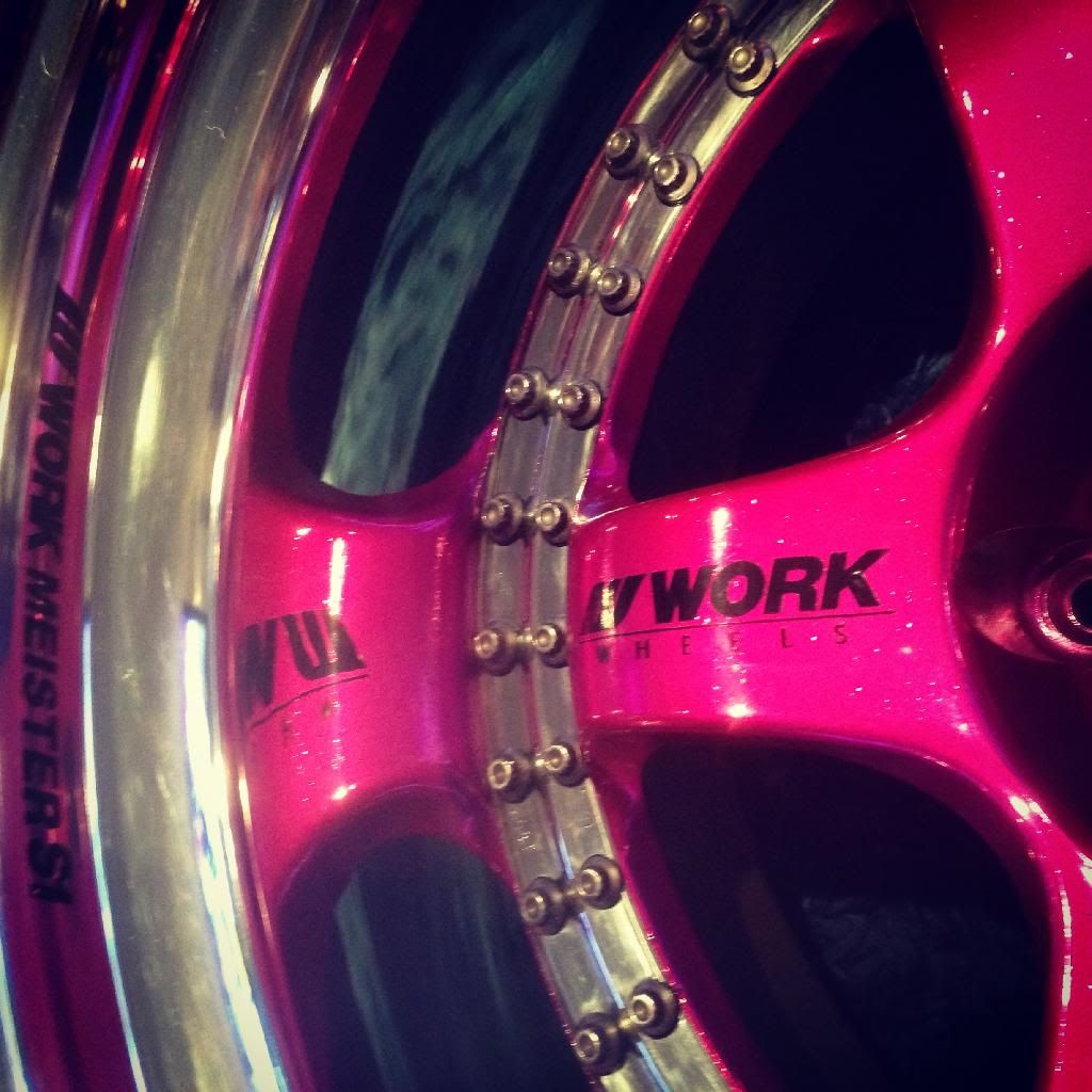

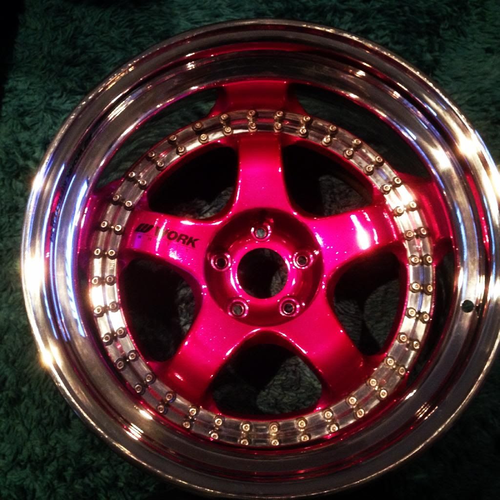

Got all 4 lips all polished and they look beaut just waiting on the centers to come back from paint and I'll put pictures up of them built up

Damn son, they're awesome. Good job!
They torque setting for split rim bolts isn't much it's like 20nm for re-used bolts and 30nm for new bolts to allow for stretch.

I torqued them to 25 but always recheck them after the cars done a few miles and again after say 100 more. They're all stamped with Work so losing one would be unthinkable lol

now the wheels......... My god they are massive, just a shame they are pink! Lol. (Says me with blue wheels) what kit have you gone for to have arches that wide???

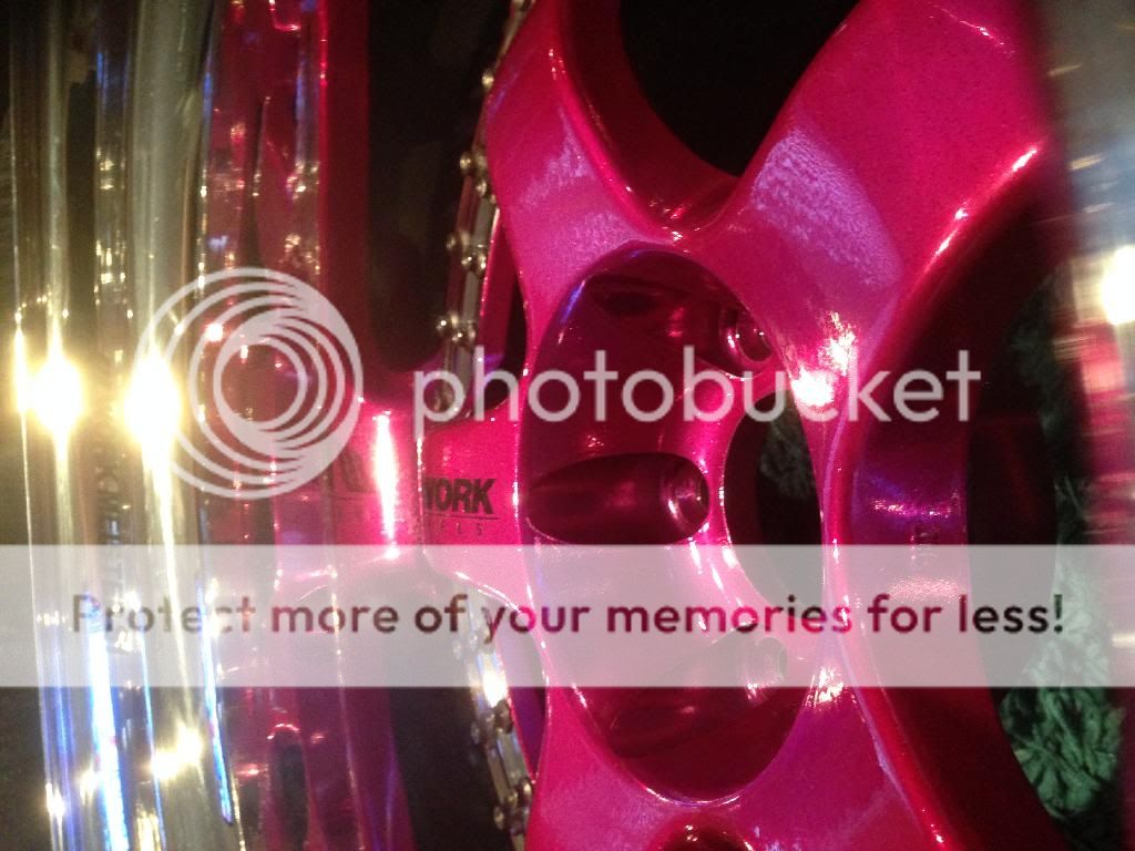

I've got the BN sports blister kit but will have to be widened some how as the wheels are 130mm out the arch and the kit is only 95mm, which I'm told is wider than the kit usually is.... They're only pink in direct light in shadow they're a wine purple colour and at night like mnp.
