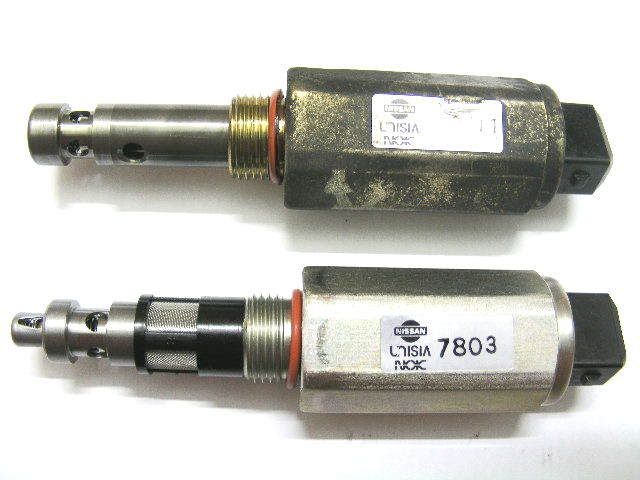

Finally this package I'd ordered from RHDJAPAN arrived yesterday...
The one on the top is my rattling Kouki. The bottom new Zenki valve...

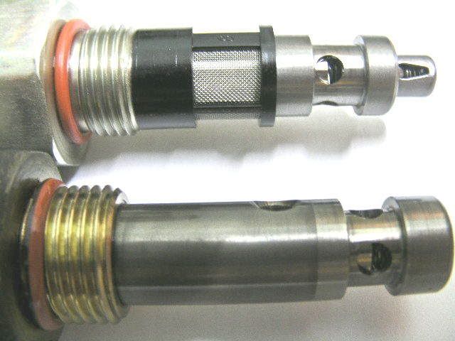

Close-up on the valves differences. The new one is slightly longish with filter mesh as well...
Just a simple screw-on with a wrench and harness plug in. Will see how it starts up tomorrow. Fingers crossed. :rolleyes:
