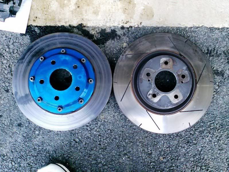

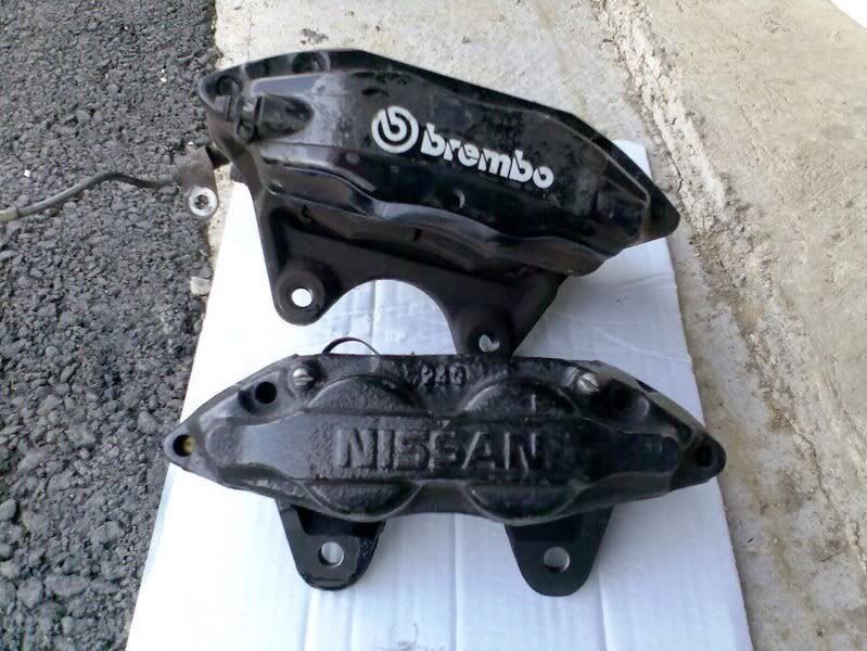

I have swapped over my Apex brake kit for R33 GTR Brembo's, only have the front on so far, this is what it looks like now -
Old caliper in forground is much smaller, and alot heavier than Alloy brembo's behind -
Old 310mm Disc's, Vs New 324mm (? - Stock GTR size) DBA Disc's
