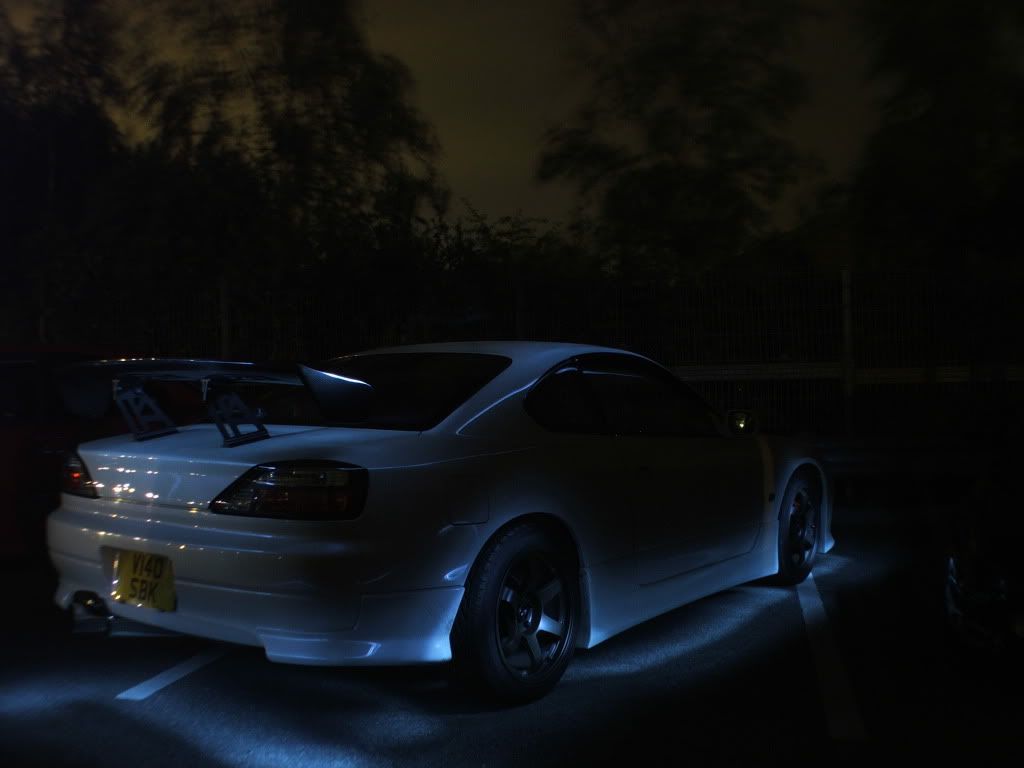

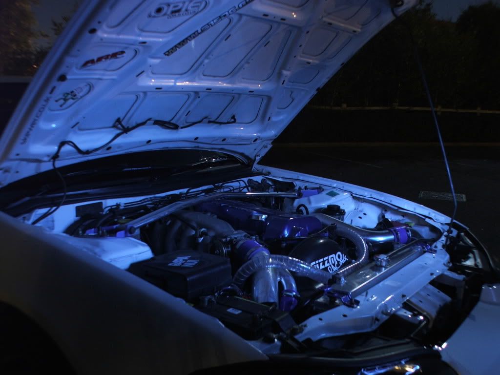

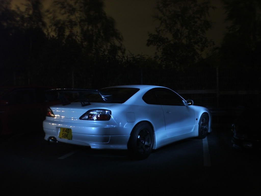

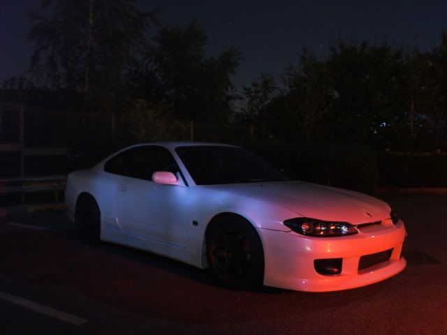

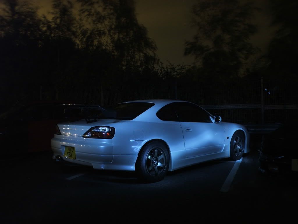

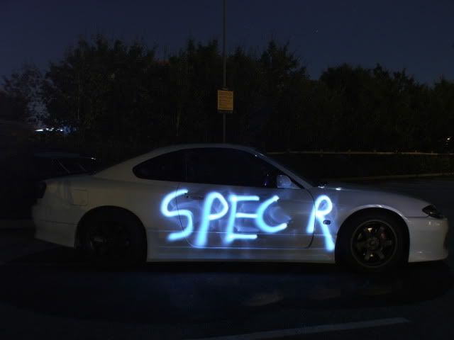

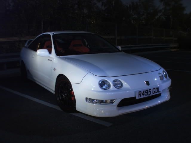

Mate of mine is looking at taking up photography as a new hobby so went for some night shots with his basic bridge camera!
