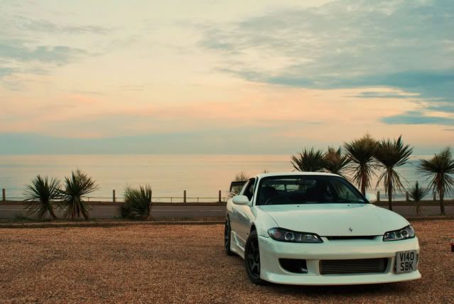

Well after a 4 week wait she is finally OTR, so grabbed a few snapps and though I should start my self one of these :)
Vitals:
'99 spec ARRR
Jap speed FMIC
Jap speed Manifold, down pipe, decat and cat bak
Filter
NGK 7's
Walbro 255
Gizzmo set to .8bar
Apex 56mm rad
Braded Turbo Lines
Nismo Upper & lower arms and tie rods
Nismo S tune suspension
Rota Drift Grids 8.5" front and 9" rear with 225 45 and 245 40 TR1's
Vertex front bumper
Carbon Culture rear board
Braded brake lines
Red stuff EBC pads
Current plan is too Get my self a HKS SSQV and Z32 A/F Meter, I have some Nismo 555 Injectors I need cleaned and then I'll take the car too Jez and get him to map the std ecu.
Toying with the idea of a Turbo elbow too, but it looks like a real pig of a job....

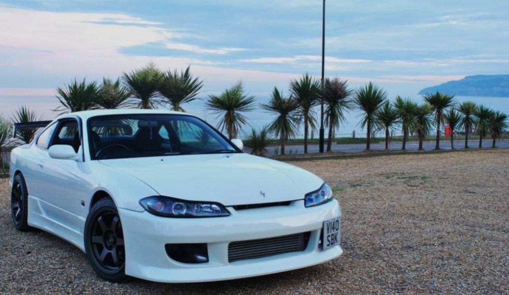

One more snap
T
Toby
Thanks guys I love it!
Just need to get the final bits before the map, Unsure if my std A/F meter is going to be restricting me with the current mods...
now thats a credit too ya lad never liked the ultra lights on it how much was the vrt ?
Thanks bud, the Verex bumper came with the car.

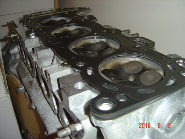

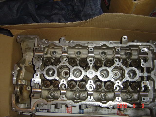

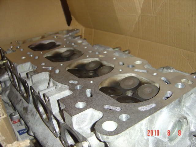

Got the head back today, looks lovely! New steam seals too!

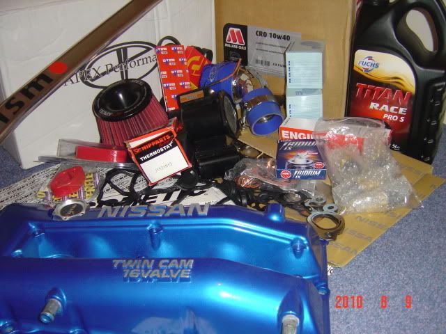

And some goodies!
After alot of searching, googling, talking with various tuners and suppliers Ive opted with the Cometic 1.9 Gasket.
Hoping to have the bottom end back Mid week next week!
That head looks well sexy haha!! :) Where did you send it to in the end? Take it same place is sorting the bottom end out as well?
I spy: exhaust gasket, Z32 AFM, Apex intake hardpipe and pulley belts lol ;) (amongst all other more obvious stuff). I hazard a guess that the plastic bag on the right holds a set of x4 740cc injectors cos I can see yellow hehe??

Sure does! No the head work was done locally by a extremely good engine builder - I'd have him do the whole lot but his waiting list is far to long!!
They are indeed Yellow, but Nismo 550's!
ARP studs should be in the post to me as we speak, I'd looked at rocker stoppers but concluded unless I've raised the rev limit, or get seriouslt frisky with the rev limiter it should not be necissary!
