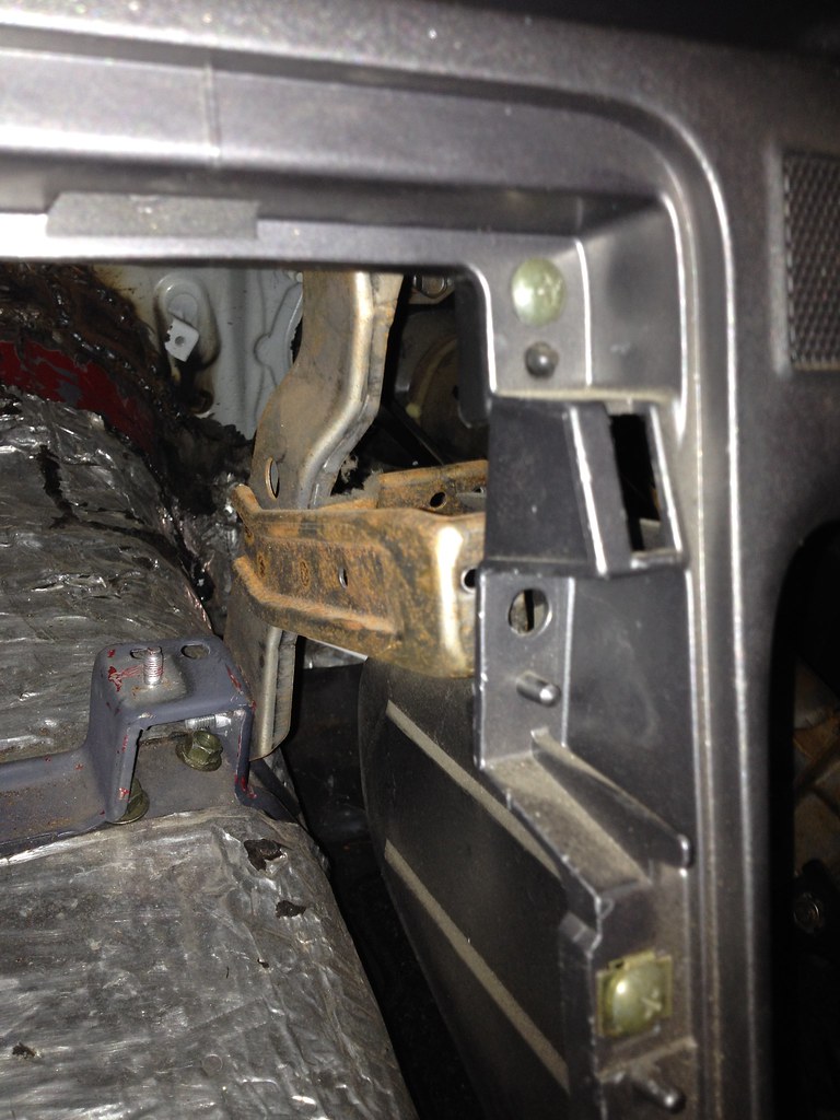

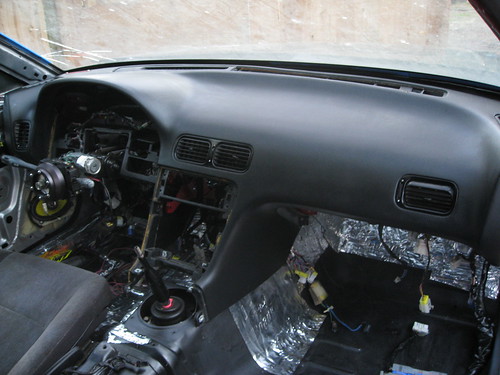

just a lil update. i got some sound deadening on the firewall and driver side floor. i ran out. but all i wanted to do for now is the firewall so i dont have to keep pullin my dash out later when i get it done. im working on my a/c right now too, Digital Climate Control!.
waiting for my down pipe and a shift knob. im stoked.
