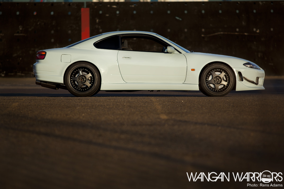

wheels are finally finished took a lot of efford but we got it done.
18" Koenig Special KG-IMP Customized wheels
Front: 9J ET19.3 with 2.75 inch lip
Rear: 11.25J ET21.125 with 4 inch lip
finished in matte black coating. Not the most special of colors. But I recon this will suit the car the best.
3 October 2011
164
Nijmegen
Hard to take proper images since the wheels are so dark :)
So have to do with these for now.

A friend of mine is a proffesional photographer, ill have him take some photos. He is doing a blog feature for my car on wanganwarriors.com anyway :)

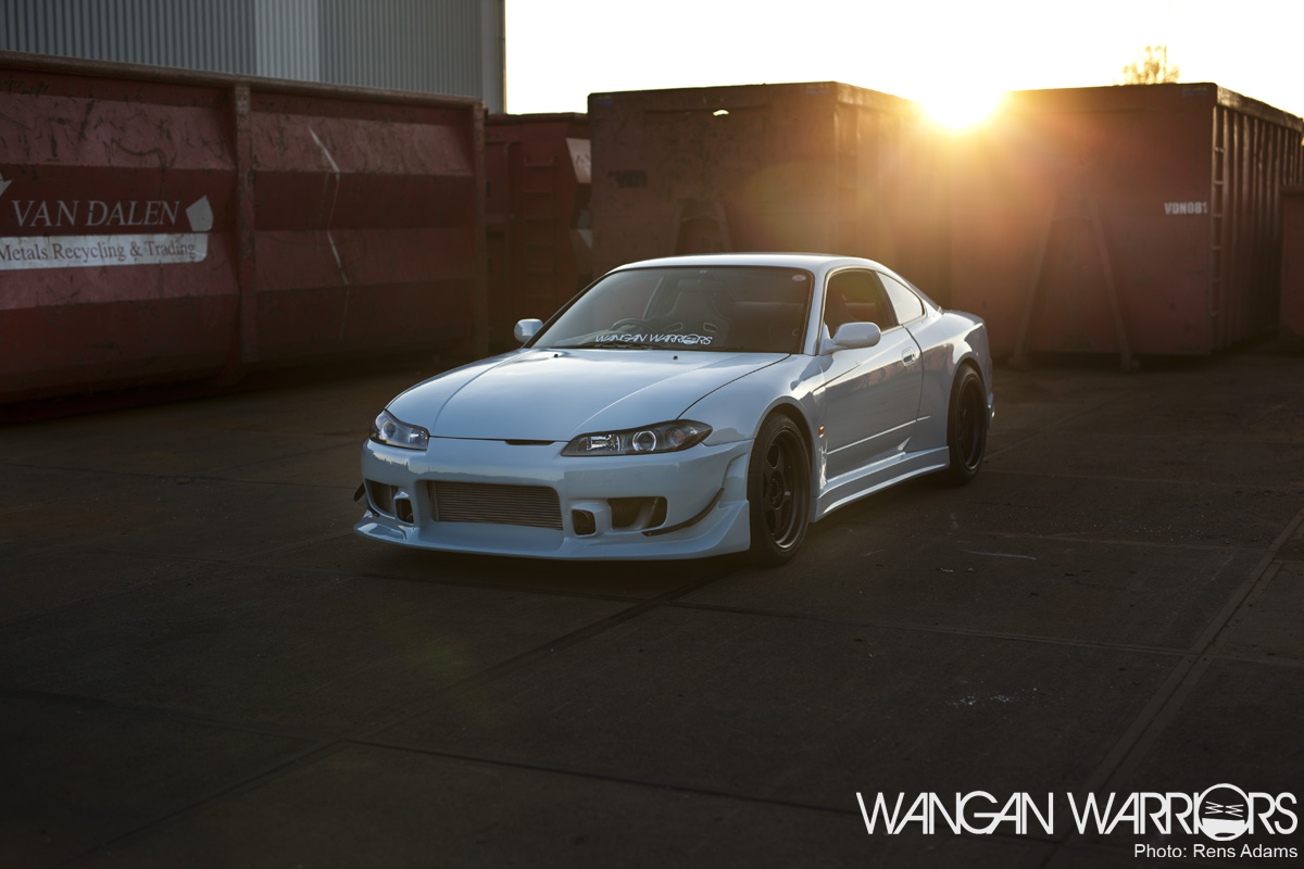

Your front wheels not hit your shock? Seems quite a high offset for this kit.
3 October 2011
164
Nijmegen
No they dont, have some mm to spare :) and yes, running a 5mm spacer in front. but thats to clear the brakes rather then to clear the coils.
The kit isnt as wide as you might think either.
It is listed as 30mm front, 40mm rear (wider)
