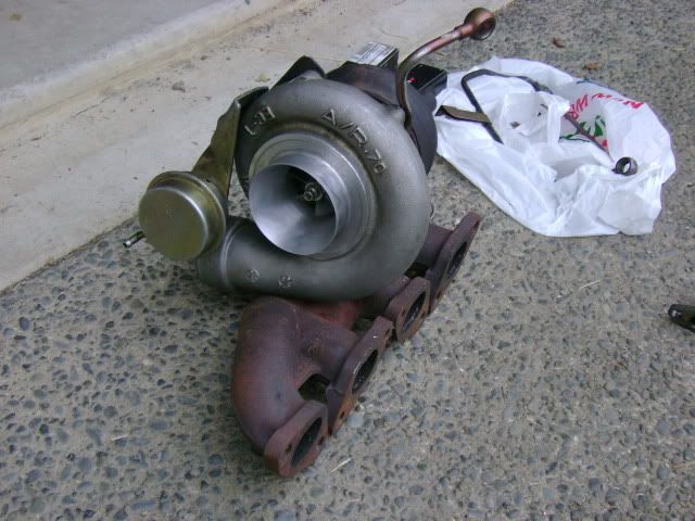

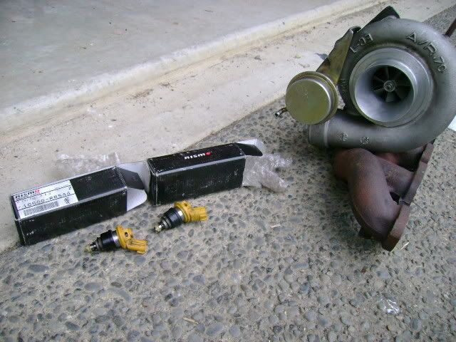

I bought a turbo which was meant to be a Garrett GT2860 ie disco potato but turned out to be a much bigger GT2876. Also got, 4x 550cc SARD injectors, Standard Manifold and standard dump pipe for the moment.
All going well im hoping to run this turbo on about 14psi which on the de should spool up nice and quick and make (I hope) 240kw+ :twisted: :twisted:

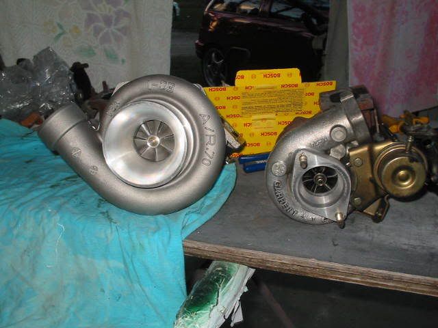

A comparision between a standard t28 and the gt2876

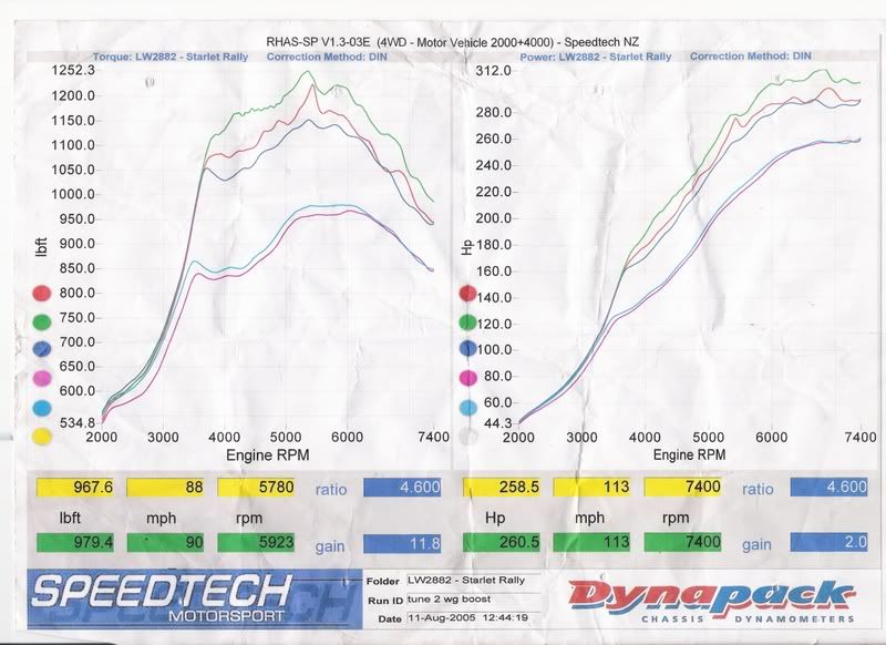

Heres a dyno sheet from the previous owner..
He had it on a GTIR engine using standard GTIR parts except he got it forged. I think that was after this dyno tune though.
He eventually made 330hp(246kw) at the front wheels on 15psi

I'll only be running it at 14spi max due to it going on an sr20de. So 550's should be fine
