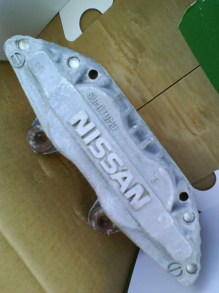

Are the Z32 fronts direct interchangeable? Any pictures (assuming they're slightly differnet to the cast ones) :)

Looks like Z32 calipers - not sure why you want to swap them into the 15 though? They use they same rotor size and you wouldnt get much of an upgrade
Get at least the R33 GTST brakes - they are bigger than the 15 brakes and takes 296mm rotors, stock is 280mm rotors, this is bolt on
Or the cheapest largest brake is the R34 GTT ones - as noted by Wing, 310mm but you need to drill the hub for 14mm bolt

You can get a bigger brake setup by DB-Power that uses the Z32 calipers. which should make a big improvment. Have a look on his section on the SXOC.

So I've confirmed they're Z32 Turbo ones which are straight swap exactly for S15. Just much lighter!! :)

..........:eek:....looks like they're built wrong or is a mismatch pair. One has 34mm clearance for the disc and one only has 31mm. Looks like may be difference between Z32 NA and TT options :(
