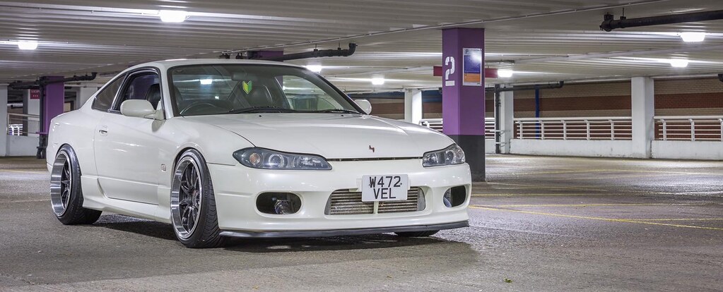

after being royally cocked about by a JDM wheels supplier, I've given up on buying a second hand set of decent wheels.
iIve always wanted SSR Koenigs but after 2x sets arriving and not being fit for purpose and the reality is i won't find a brand new set for less than circa 3-4K
so I've bought another set of wheels anyway, cheap i know and again no to everyones taste...

hey its look really nice what spec it is ??

F9x18 et22
R10.5x18 et22

Damn, those wheels do look very good. They're XXRs? Fitment looks spot on!
Looks just as good mate, don't worry about not being JDM, a wheel is a wheel at the end of the day, its round... :) spend the extra saved on other mods..

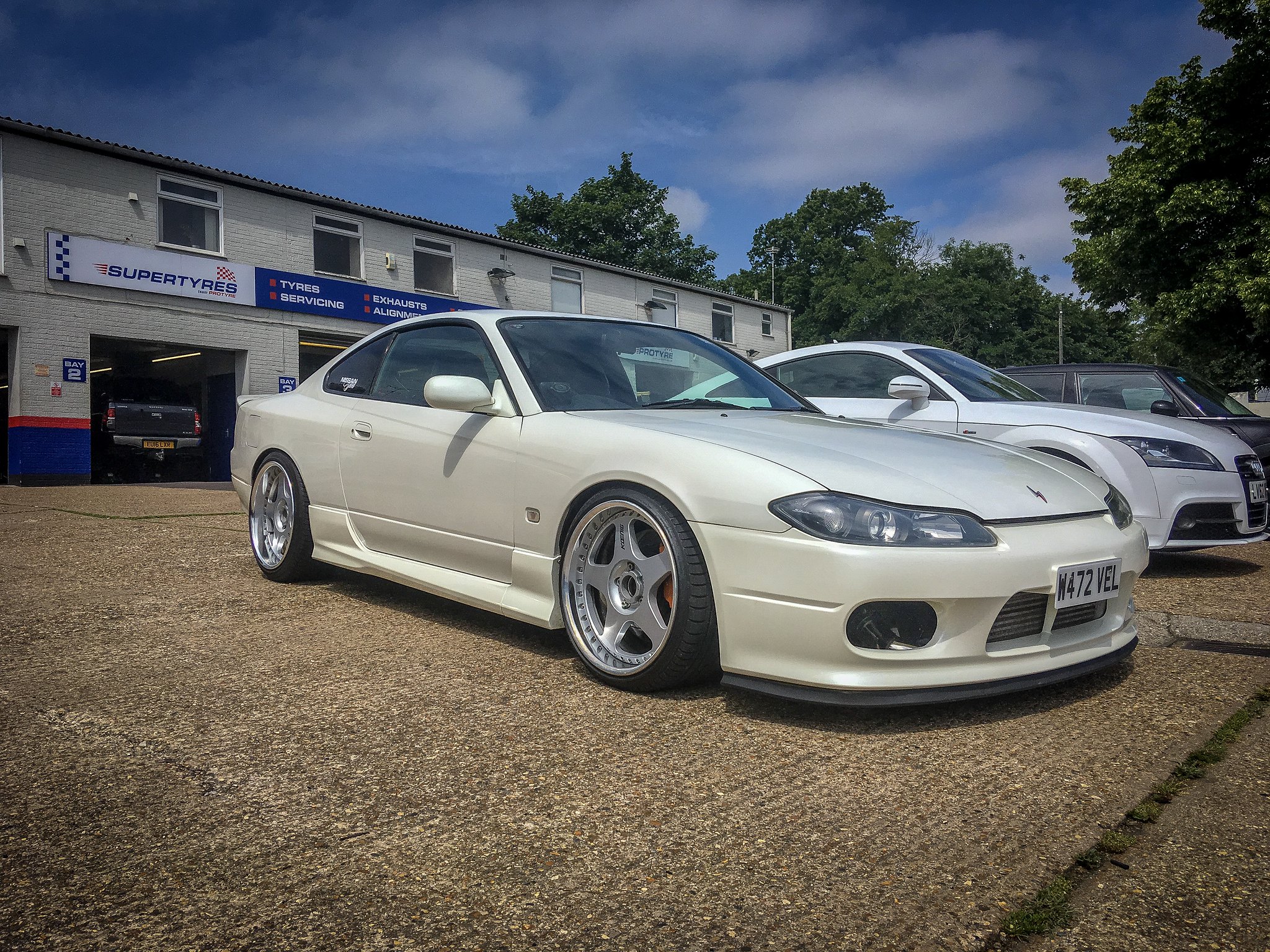

so all good, however i had had XXR wheels which were a compromise last minute desperation thing but i hated them from day 1.
made the best of what i had whilst i continued to search
Then as luck would have it a year later to the day after being let down massively by JDM Distro (twice i might add) late one night i saw someone had changed their wheels...SSR Koenigs.
Turns out he hadn't got as far as creating a for sale ad yet, but we struck a deal I drove up near Glasgow and picked them up
:) some of you might know where these came from...
Ive since added a DMax boot spoiler, and have a roof one waiting to be painted, along with a JDM DC5 lip spoiler if i ever get round to doing anything with it.

looks nice, very nice mate! Martin's old wheels are they?

thaey look like they fit very well. any arch work done? any specs on the wheels?

The fitment are fairly good,
F 9x18 et35 but I have to run a 25mm spacer to clear the brakes and for cosmetics.
R 10x18 et35 but with a 6mm spacer again for cosmetics.
yeah it goes fairly well I’ve actually been able to dial in the boost much stronger than I used to have it on my old 14a so that it itself makes it feel quicker anyway.
