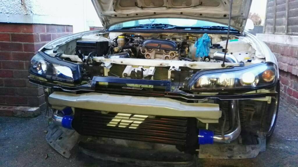

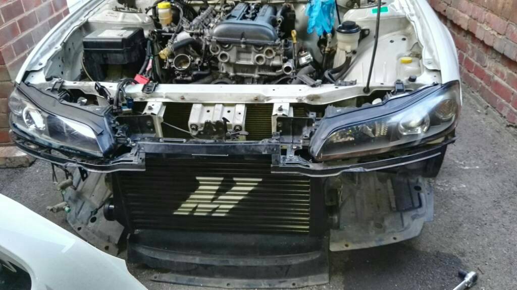

Mishimoto intercooler fits nicely, just some pipework to sort. Bought a s14 intercooler pipe kit which is fine on the turbo side but on the throttle side ive had to have the pipe cut and welded and find a good silicone bend but seems to work ok
