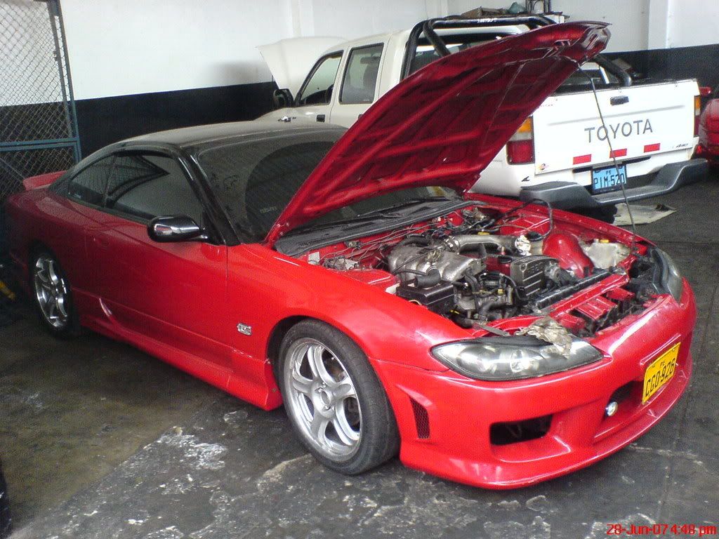

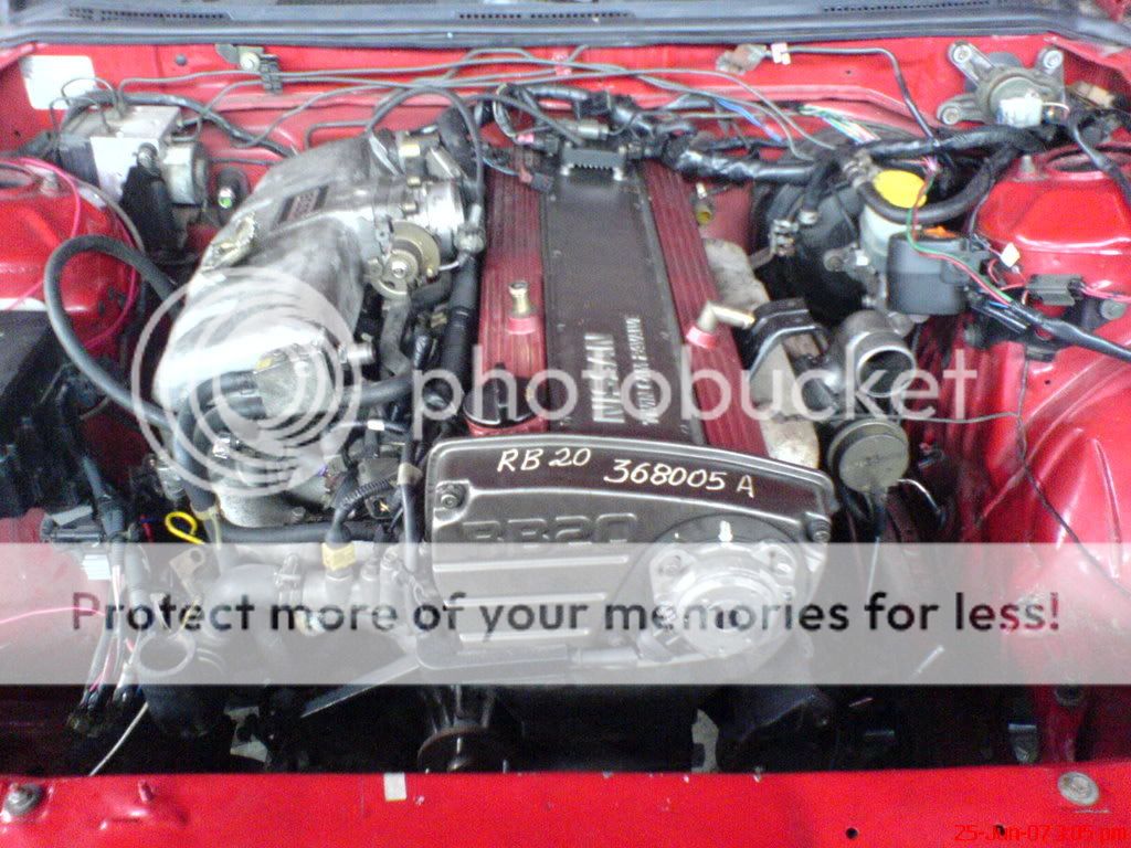

Hi, im the one who swapped a RB20det on my s15 spec S.
As I said on my old post, i was first looking for a RB25....Ive allready found it and swapped it allready, ill post pics when i can....it was the same as fitting the RB20, has the same dimension, etc etc, no firewall was cutted....I had to upgrade my brakes to Evo 7 Brembo...because of the engine weight.
My car has the next upgrades.
Rb25det from nissan skyline r33 from 1998
20002 R34 gts-t Gear Box
HX35 Holset turbo at 25psi
GREDDY R33 Intake plenum Manifold
100mm throttle.
Header.
850CC SARD inyectors
forged wiseco pistons
rb26dett rods
Nismo suspension.
it will get out from the garage in about 1 month.....i will post videos and pics of the swap...hopefully i will get 550 hp at 25 psi or more
