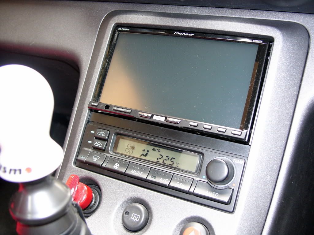

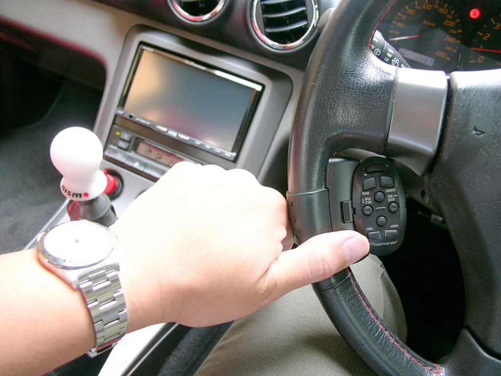

1. Replaced the Pioneer PEH-P9450 with the Pioneer AVH-P6850DVD with CD-BTB100 Bluetooth adapter.
The double din LCD provides a flushed OEM look to the Silvia's interior. My next installation will be the HKS CAM II to hook up the HKS F-CON V Pro vital information display on the LCD screen. I also intend to display the exhaust temp, oil temp and oil pressure on the LCD screen after I install the CAM II.
The bluetooth adapter allow me to answer and dial calls from my Nokia N95 mobilephone and play tunes stored in my phone when it is placed in range other than the standard iPod connector for iPod/iPhone playtunes only.
Pic of Pioneer AVH-P6850DVD in my car
Pic of Pioneer steering wheel mounted remote control

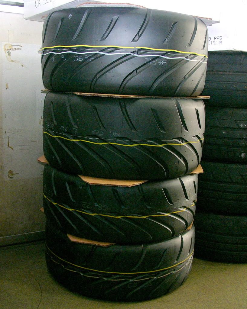

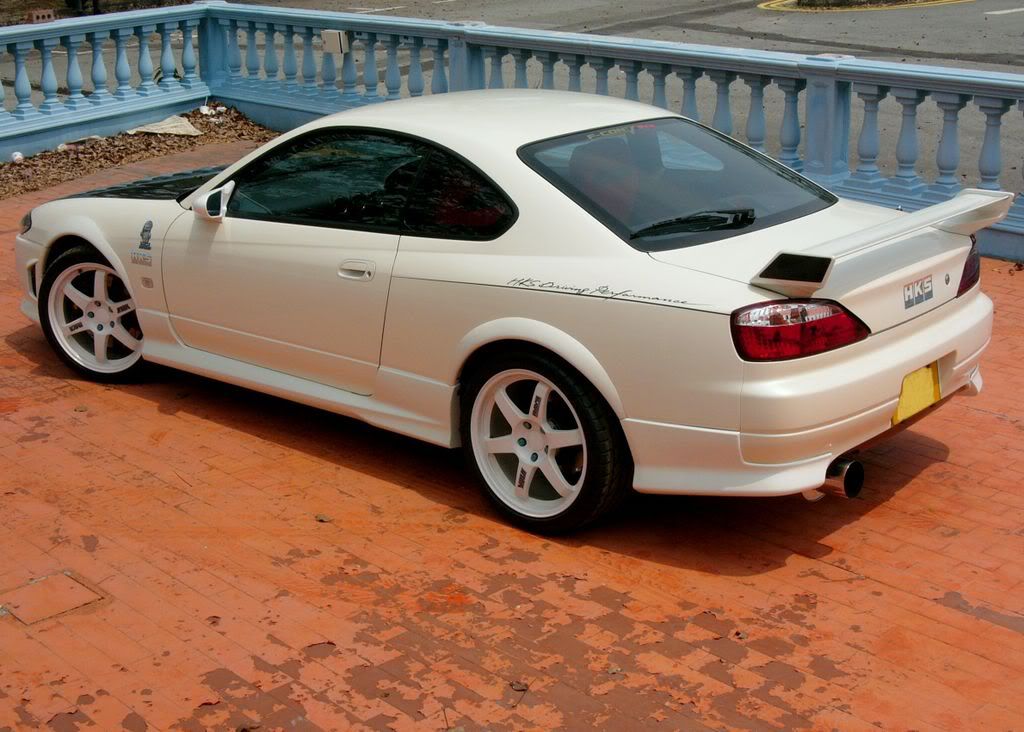

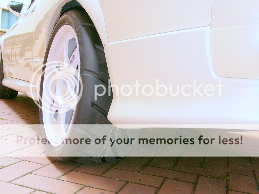

2. New set of Volks Racing TE37s (White) with Potenza RE55S
Front: 7.5" x 18" (+30mm offset) with 225/40/18 tyres
Rear: 9.5" x 18" (+35mm offset) with 265/35/18 tyres
After the installation and test drive:
1. Pros: My wheelspin problem on 1st, 2nd, 3rd >5000rpm previously encountered on my street S-03s disappeared....so I do not need to consider installing a traction control system anymore.
2. Cons: I get more rolling noise now...sounds like I've installed another supercharger in my ride, hehee.
Pic of RE55S before installation...look at those threads!
Pic of it on my ride1
Pic of it on my ride2
View of my ride

Thats one sweet upgrade. I knew I wanted to ask you this but always slipped my mind... the wheel arch extension bulge, how is it done on your car? Did they cut and weld the extensions on to accomodate >255 tyres especially at the rear?

The rear wheelarch extension hides the rolled rear fenders and careful calculations on the wheel width and offset.

The front and rear wheel arches are plastics material universal arches offered by "Chargespeed" japan and custom fit by my bodyshop after triming and spray painting them.
The rears are relatively easy to trim as the original fenders are flat, just measure the required fender extension and edges.
The tough ones are the front ones as you can see they are contoured to fit the round off stock fender near the edge between the fender and bonnet joint. There is no wheel/fender extension for my front wheel. I fitted the fender flare to give my ride a fender flare look since I've chosen to mod it with motorsports theme visually.
