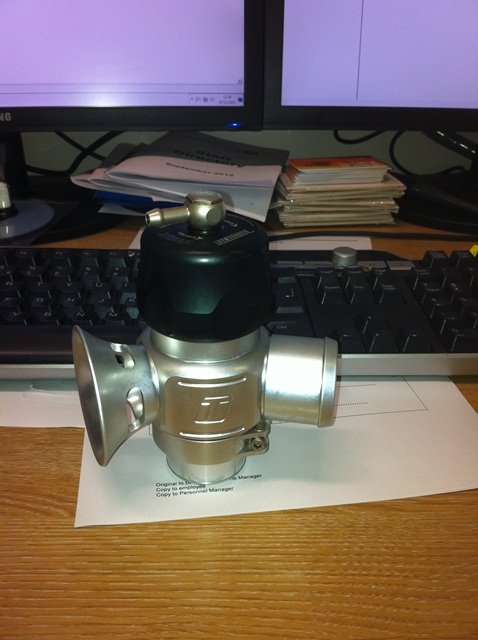

This arrived today to complete the front mount installation.
Turbosmart dual port valve. Can be used in 4 different ways. Full recirculation, Single trumpet, Dual Trumpet or Half and Half.
Very weighty and seems good quality. Picked this up at a rediculously good price. Was a mistake on their website but they honored it to can't respect that enough.

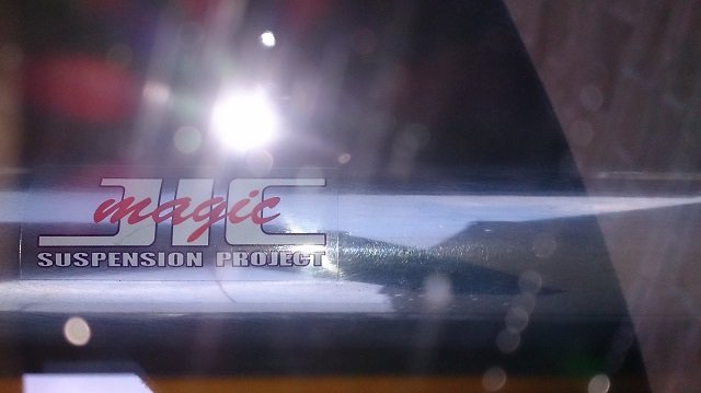

Spent the afternoon fitting this. Looks pretty good and hopefully tighten up the rear. JIC01.jpgJIC02.jpg Haven't driven it yet but looks good.
CMR
22 August 2011
417
Yorkshire, UK
They do make a fair bit of difference, mine has a Nismo one and I removed it temporarily and noticed the back of the car didnt feel as tight.
18 September 2011
726
West Midlands, England
i was in two minds whether to bother fitting my rear brace, will definitely now you said that!
Car is looking good dude!

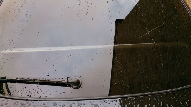

I also cleaned her today and have a headlight cleaning kit to reduce the yellowness. Would have done this to but the drill battery was flat.

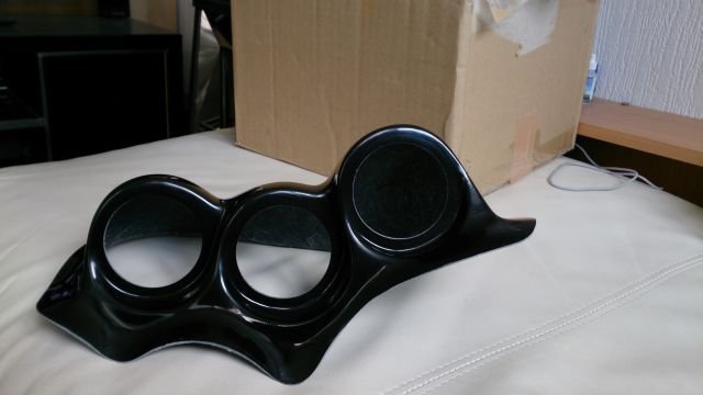

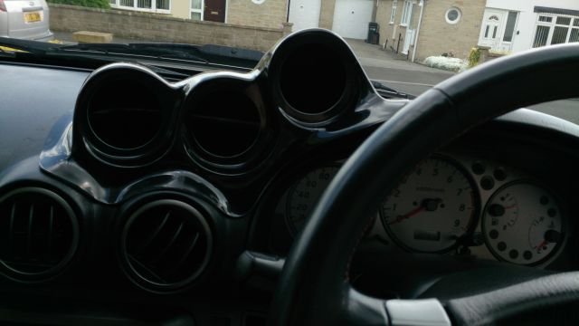

And possibly just as exciting a part I ordered was delivered today. All the way from Japan.
Uras Gauge Holder.
I'm thinking to look more subtle they need to be blended into the dash somehow. I thinking about looking into getting the dash flocked with these blended and flocked too. Any thoughts on this?
