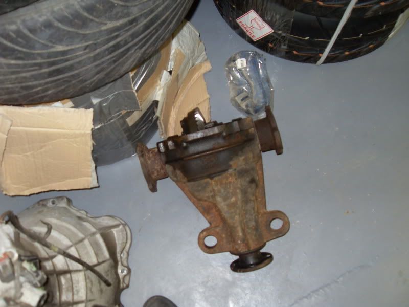

Picked these up today
and
i know it just looks like a crappy diff but inside is a 4.6 ratio :D thanks stevo

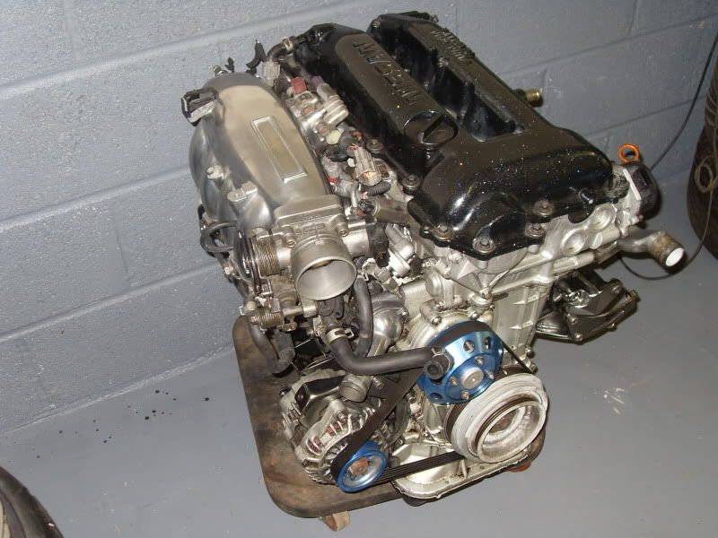

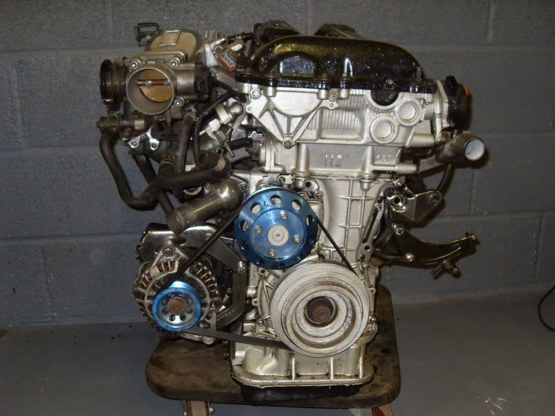

anywhay the engine spec is
Engine spec:
• Arias Piston Kit
• Eagle H Beam Rods
• ARP Head Stud Kit
• Brian Crower Stage 2 Camshafts (IN 264 and EX 264)
• Brian Crower Uprated valve springs
• Cometic Metal Head Gasket 1.6mm
• Lightweight Aluminum Pulleys
• SARD 850cc Injectors
• Head ported and matched intake and exhaust
• Polished greddy pletnum
• Polished water in and out pipes
• Poweder coated black chrome mounts and bits

Isn't that diff ratio much higher than S15 one which I believe is around 3.7?? Or is that the usual ratio to match with RB box? Nice to see it all coming together... any idea on where's best to get those bling bling coloured ali pulleys from??
Cheers :)
sx-si
7 June 2008
654
3
hampshire uk
ok the diff ratio is not stock matched at all
5speed r33 gtst ratios are very simerler to 5spedd sr20
reason ive gone for a shorter ratio is quite simple, im after as much tourqe and power at the wheels as i can as its not very oftern i go stupid fast so my plan is make the car spin up the wheels for skidding and also quicker out the corners gripping
the way i see it is if i can have the top end at say 120-130mph then thats plenty, seriously how oftern you you hit 140-160 on a track day?
the only problem with changing the ratio's is my mph guage is going to be miles out

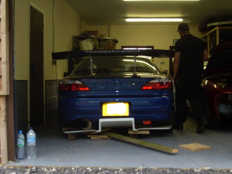

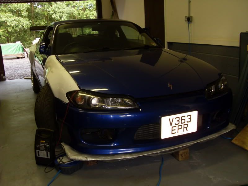

small update
starting to get into the whole gt style now so heres a bit of a teaser
i would show the pics of the rear archs being tubbed but polo aint sent me them yet
and before i get slated i know the bgw is too small (and low) but its only a 1600mm so need to sell it for a bigger and roof hight one
the splitter isnt near its final position and needs a fair bit of work
waiting on 30mm rear spacers so i can get car aligned then final wheels made
but its been 2weeks and still nothing from jdm garage :( so if anybody has some spacers please let me know

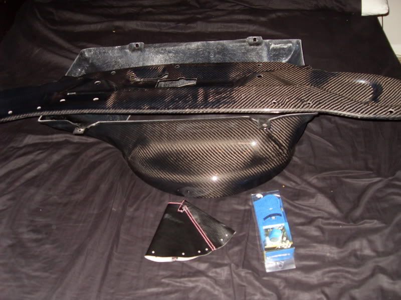

wow 3 months later and this project has changed a little
recived these bits today
genuine mission fan shroud
yashio gear gator
weds sport powersteering sock
s15oc damaged carbon slam cover
