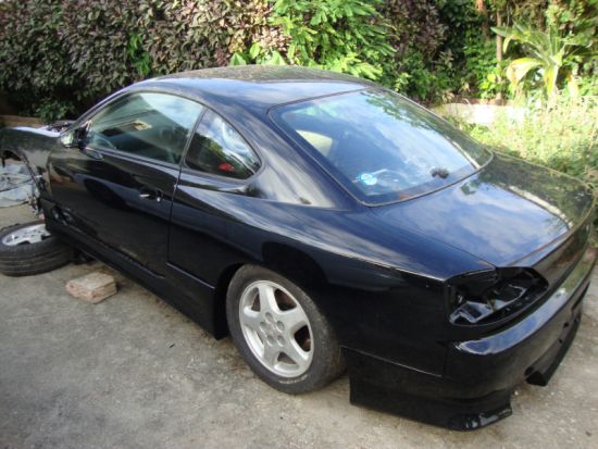

Well it has been quite some time but here is an update of this car after a long conversion. Money was not available so it was parked for a year or two until I got the parts and the right person to help with it. Turned out alright from a before and after, note, I will never attempt this again.

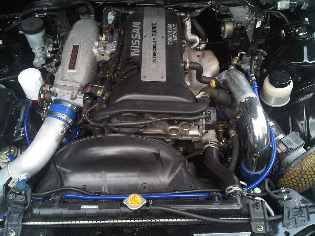

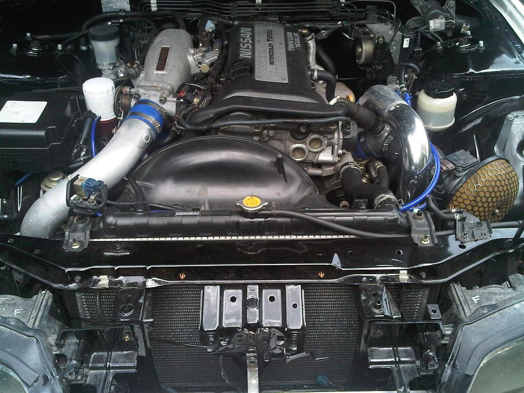

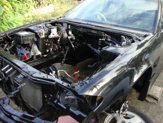

Engine Bay Shot,
Side Shot,

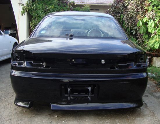

My Favourite, the Booty!!!

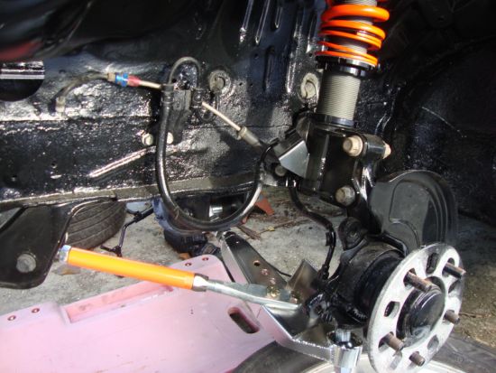

Front Suspension - Driftworks Tension Rod, SPL LCA and Driftworks Coilovers

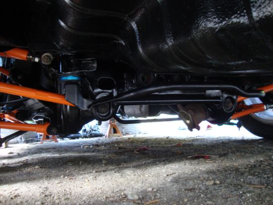

Rear suspension - Driftworks RUCAS, LCAs, Traction Rods, Toe Arms, Aluminum Collars, Reinforced Subframe and Driftworks Coilovers

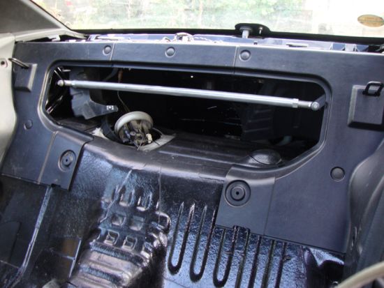

Cusco Rear Strut Bar,

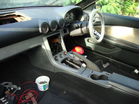

Interior

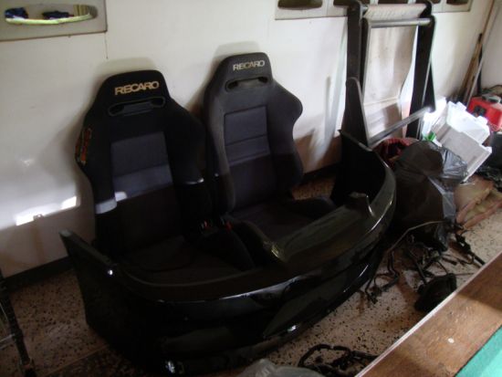

Recaros and Front Bumper

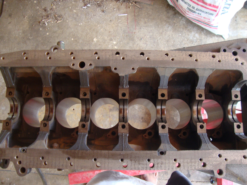

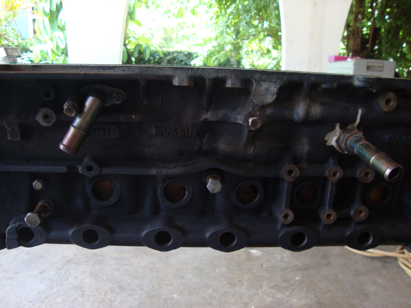

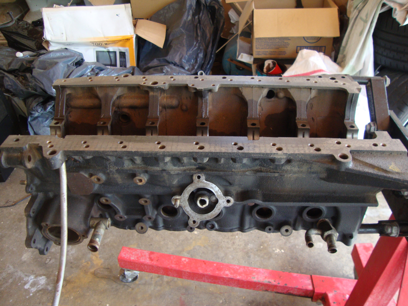

Yeah well the car went to three different shops that attempted the conversion but in the end I found one person that did a nice job and to my standards of course. Now some updates. Cleaned the RB block last night, damn after the skimming of the block for straightness it sure left a lot of gunk everywhere throughout the block. I removed all the water and oil jackets aka welsch plugs and soaked the entire block with purple blaster and left it for half an hour to really get into the grease and old oil. Came back with the pressure washer and round one began. Lots of swarf that was stuck up all over came off. After washing I further inspected and found some more stuck on the inside of the block so I soaked again and washed again. The entire inner walls are now clean. I blasted the oil and water galleries but I want to go over everything again today just before engine assembly with some soapy warm water. That way it can penetrate and then once washed with warm water as well will disappear and not collect anywhere. After that I will need to spray the oil galleries with some WD40 and then blast them with the compressor to clean properly.

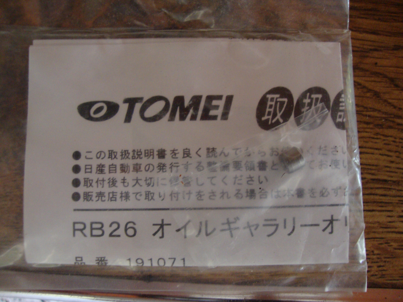

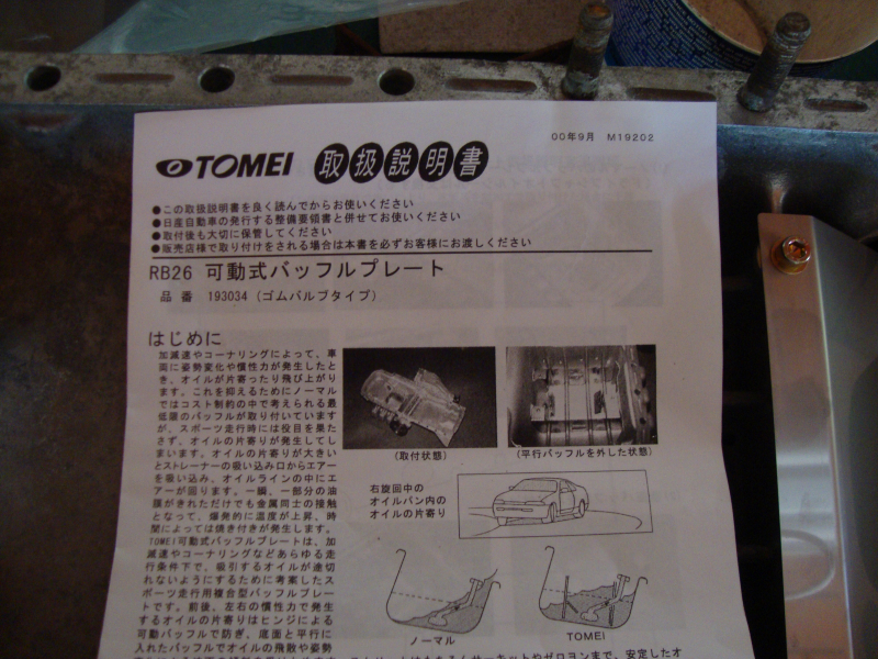

I will fit the Tomei oil restrictor and also begin cleaning the stock 'baffling plates' that attach to the girdle as they are oily and didn't want to clean them as they would have surely rusted. I am going to also clean up the water galleries on the block to allow a better flow around the cylinder walls. I have already widened the stock oil drain holes in the sump as specified by Tomei for the installation of the Tomei Baffling kit so Sump will be cleaned thoroughly with a wirebrush and some purple blaster and then blasted as well. I forgot to add the aluminum fitting for the oil drain back on the sump so I will get it attached today before final assembly starts. Bought the Redline Assembly Lube from tuner Imports for assembly so everything looks like a go.
First assembly will be the block, CP 86mm pistons, Stock GTR Rods with ARP connecting rod bolts, Cosworth Rod and Main Bearings and ARP Main Studs and also Tomei Oil Pump and all new seals and gaskets. Cranks has alreayd been checked and is A ok so assembly on the block should be fine. Was thinking as soon as the block has been washed in the warm water I will prime it and paint it same time in black lacquer paint and reattach the new water and oil jackets. The warmth of the block will help the paint hold much easier. I will get pics of the block today, I was quite please with the outcome this morning. Cylinders were oiled so that they would not get rust or oxidize while left unattended, so too were bearing grooves. On finall assembly the groove will need no oiling but a thorough cleaning and some thinners to dry the area for a proper seat with the bearing. also have all my torquing specs for all studd new and old waiting, some a five step torquing process and other three and other two. That's it for now

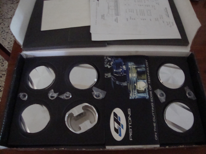

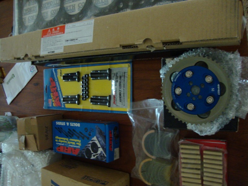

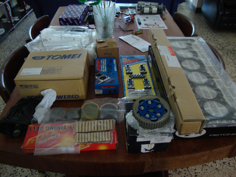

Well finally took some of the parts from of the shelves in my room,

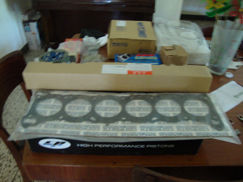

CP 86mm Pistons
In pics below,
Cosworth Bronze Valve Guides, Greddy Cam Gears, Greddy Timing Belt, Tomei Oil Pump, Tomei Fuel Rail, Cosworth 1.5mm Headgasket, ARP Headstuds, ARP Main studs, ARP Connecting Rod Bolts, Cosworth Main and Rod Bearings and water and oil jackets. Things missing are Tomei Metal Gaskets, OEM Nissan Gasket Kit, OEM Nissan Tensioner and Idler Pulleys with new studs and nuts.

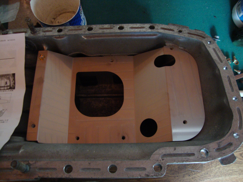

Tomei Baffle Kit fitted to RB Sump,
Tomei Oil Restrictor,

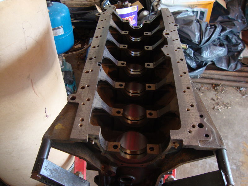

The Victim, still needs a final soak with some soapy warm water before final paint and welsch plugs/fluid jackets are added,
Engine was soaked with purple blaster and left for half an hour and then blasted with a pressure washer

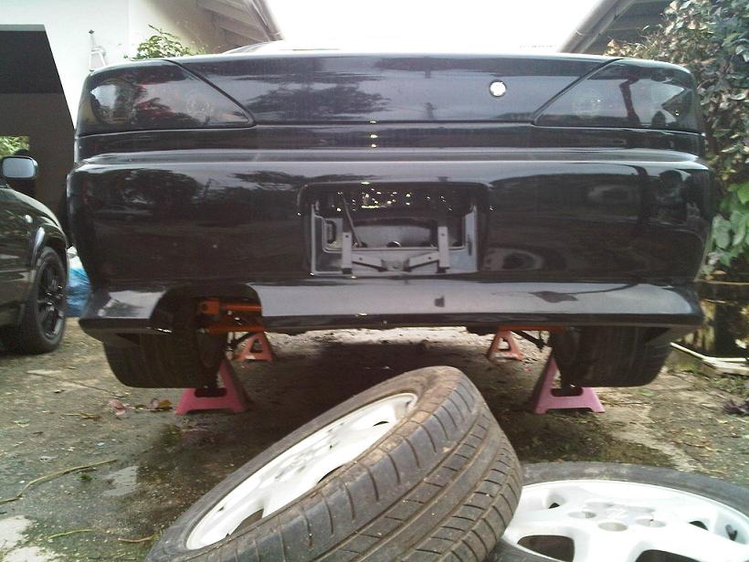

Rear end shot, was still waiting on diff and engine and drivertrain setup,
Got my Auto R33 Viscous LSD, what you said 4.364 ratio (yikes)
My reinforced rear subframe and R33 diff with ABS sensor installed. Oh what is that, yes Driftworks suspension bits :D

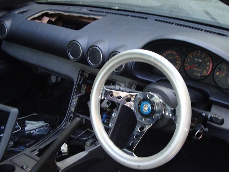

Nismo Instrument Cluster (check), steering wheel has since been replaced with a factory S15 wheel but is being kept as backup

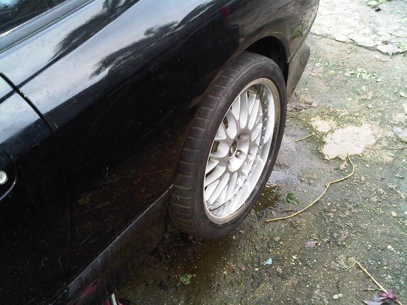

Fitted some VS-XX 18X8.5/9.5 +31/+45mm, front needs spacers,

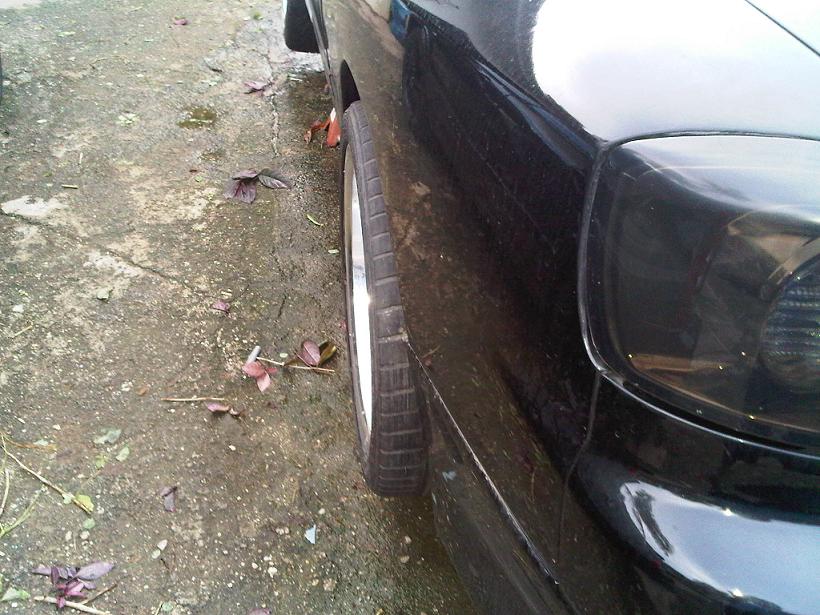

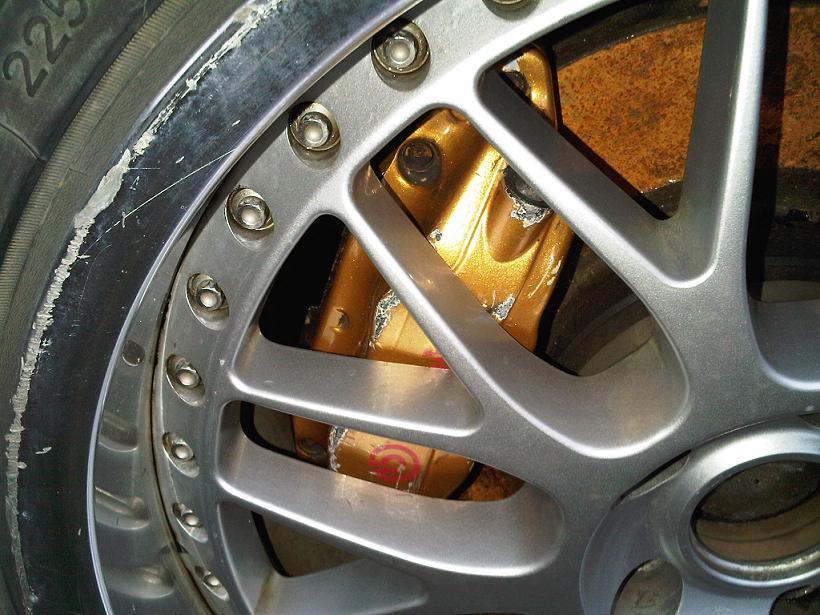

Front wheel rubbing on Brembo Caliper. these are R34 GTR Brembos and no they came in that condition, still to be painted. And they are going on the ER34 GTT and the GTT brakes on the Silvia.

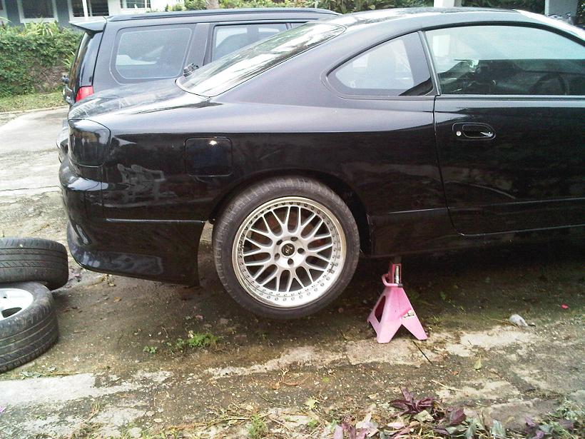

Wheels fitted,

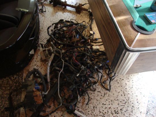

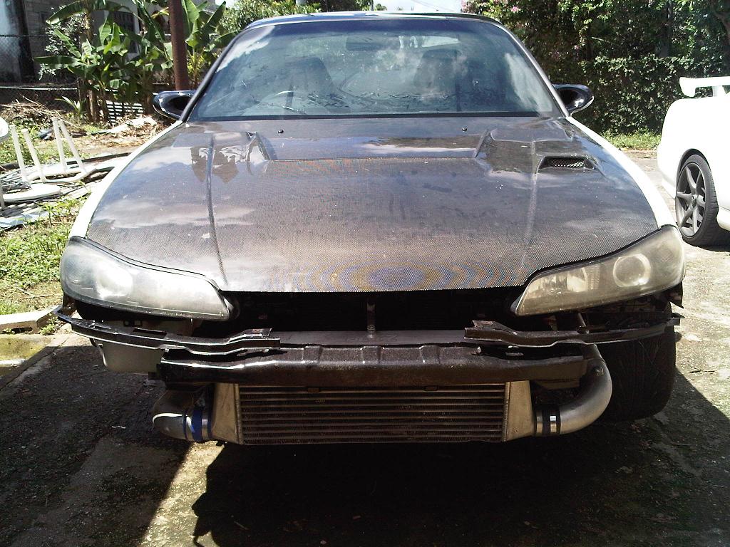

Engine has since been started after five years of not having nothing in the engine bay and all done by myself in my front yard. Was a proud day to hear her rumble on a first try after swapping an entire S15 wiring for engine/interior and trunk interior. Since then I have ripped out the front fibreglass fenders as they fit like crap and fitted OEM metal ones. I have a couple of fitment issues but it will all get sorted I am sure. Front Origin bumper has been fitted along with my Nismo Quad vented CF bonnet and DRFT tailights. The engine has a couple of addons added by myself namely, Greddy Intake, Greddy Sump, HKS Intake Pipe and Filter setup, Blitz FMIC and custom piping, Apexi Power FC L-Jetro, 3" Downpipe and 3" J-pipe. Things to go on still are 740CC injectors, Z32 MAF, Koyo Radiator, 3" Exhaust and then boost controller and a final tune. A couple of pics with the bumper fitted (Origin Kit BTW).

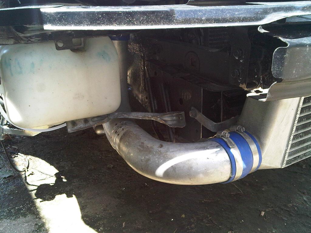

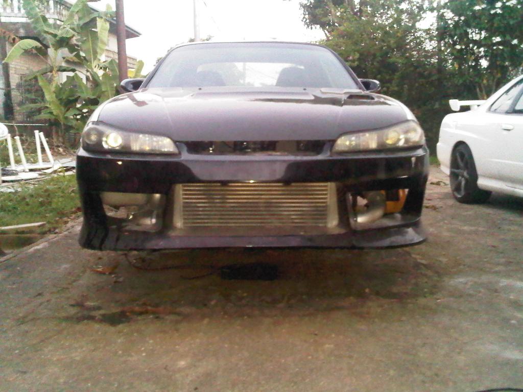

Intercooler fitted,
Clearance made for Washer Bottle, I may either have to run the pipe above the bracket or relocate the wahser bottle to the trunk if the fender shield does not fit.

Thanks for the encouragement guys, tyres in the rear are 265/35/18. Well not much to update. It so happened that today I decided to fit my exhaust I picked up yesterday. Only problem I encountered was that collector pipe to the back of the turbo I had was screwing the entire setup and also that one of my exhaust hanger bolts snapped. Problem with the collector pipe is that the length of it was off and was dropping the downpipe too low and not allowing it to bolt direct with the gearbox bracket. Well I bit the bullet and decided back in with the OEM collector for now until I decide to begin upgrades like a nice top mount turbo setup.

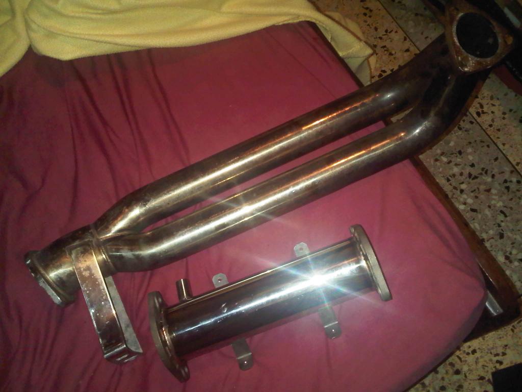

Picked up these two bad boys, go the decat lastnight and the split downpipe for low riders tonight, hopefully everything fits like yam.
Gonna have to hunt for a Tomei/Greddy/HKS Collector/J-pipe to complete the full 3" exhaust or otherwise will order one.
Well I could not wait so I removed the 3" collector pipe I had and 3.5" gutted catalytic converter and fitted the split downpipe and it fits pretty decent, only problem is that the bracket that it has sits in line but just earlier than the location. I will have to get a flate plate and make four bolt holes to line up the bracket and the downpipe, no biggy.
Tomorrow I am gonna pickup some star type lock washers and some high grade bolts and nuts form Lotec to button up the exhaust and put that to rest. The downpipe is hardly visible underneath the car now, really sweet. I mocked up the decat and it looks spot-on. I may just widen the metal 2.5" gaskets I have to 3" and use them if I cannot find metal 3" gaskets. Tomorrow this will be one less chapter.
