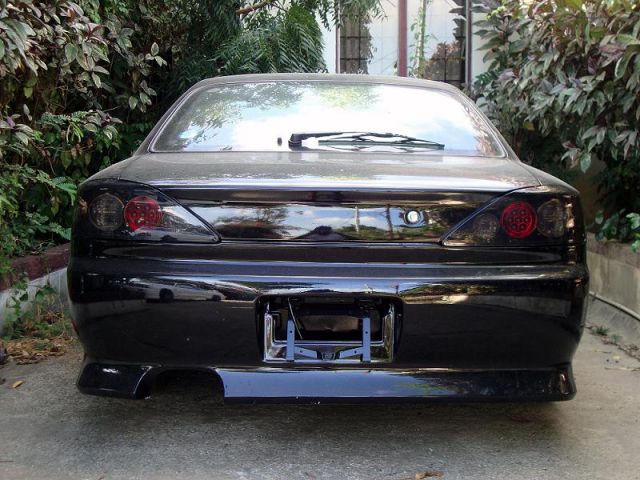

This is how my rear is with the Origin back bumper and my DRFT tails,
When it was on my Spec R S15, oh how I miss her
