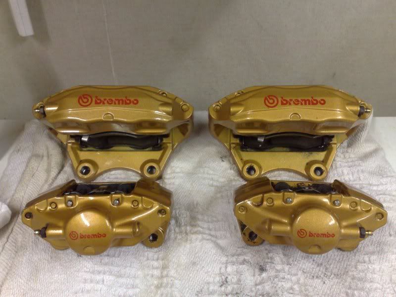

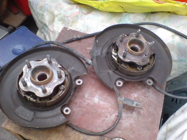

Update fitted my R33 rear knuckles poly bushed, Goodridge brake hoses, new brembo discs, ds2500 rear pads and r34 rear caliper...
While i was doing the work i fitted my Uras poly gearbox mount.
nt forgetting the Z32 BMC to gie the new setup the correct bias.:thumbs:
