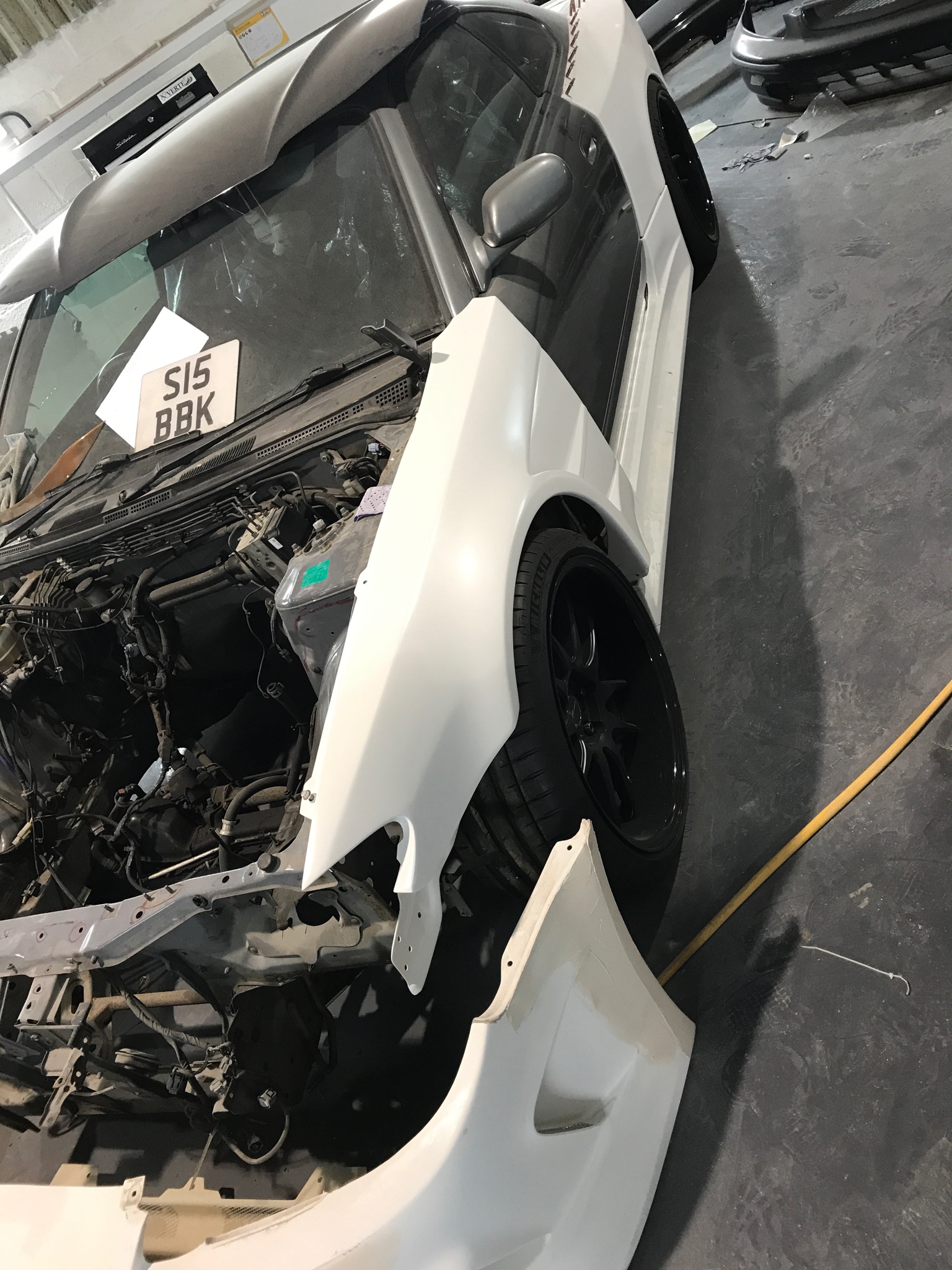

Some progress is better than none ! Primered my front wings today
Hopefully start painting the panels soon so I can at least get an idea of how it's going to look

I made some time to have a proper look over the car this week and have decided to go full nut and bolt rebuild now : there is some rust starting to come through so I feel I would be stupid to not address this now .
In the mean time I will continue to do bits and pieces like this !

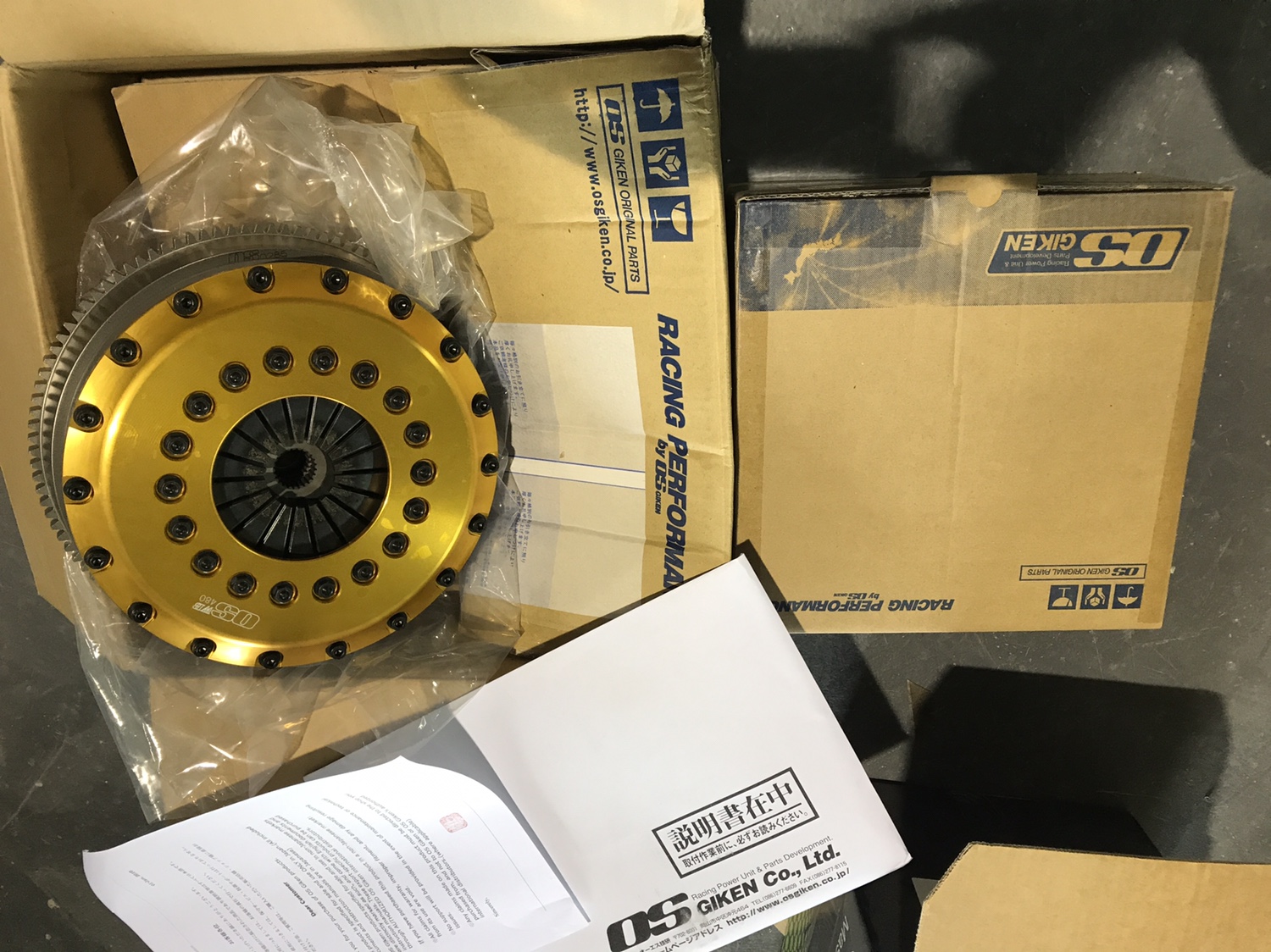

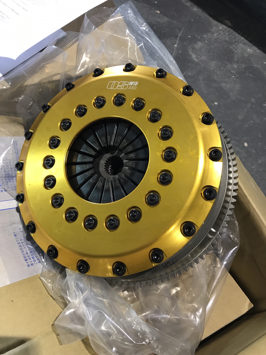

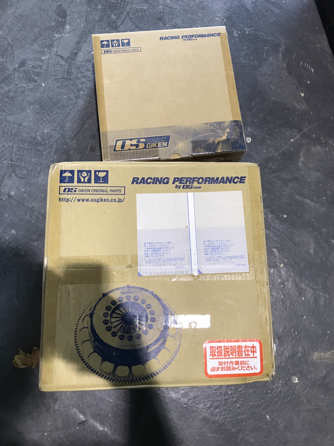

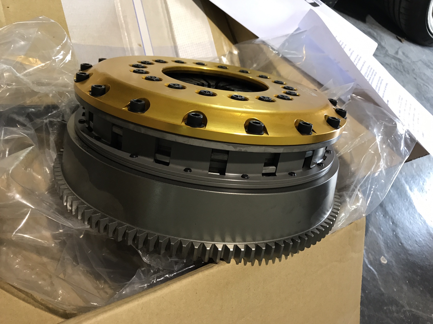

Finally my clutch has arrived ! Originally was sent the wrong one so had to be sent back to japanland then the correct one sent , luckily I wasn't in a rush for it
After a lot of research I ended up going with the os giken TR2CD , good for 700 odd hp so should be more than comfortable with what I will be running
4,638
44
Interested to see how this clutch is to drive with. Does it have organic or paddle plates?
There isn't actually a lot of info available for the clutch so I'm taking a bit of a punt ha ha but from talking to people with giken clutches and speaking to giken themselves the clutch shouldn't be that bad to drive with , from their description "The billet aluminum cover provides a more direct clutch pedal feel, but still maintains its street drivability due to the unique leverage mechanism of the diaphragm spring which reduces overall pedal effort"
It is more directed towards track but then most at this power level are

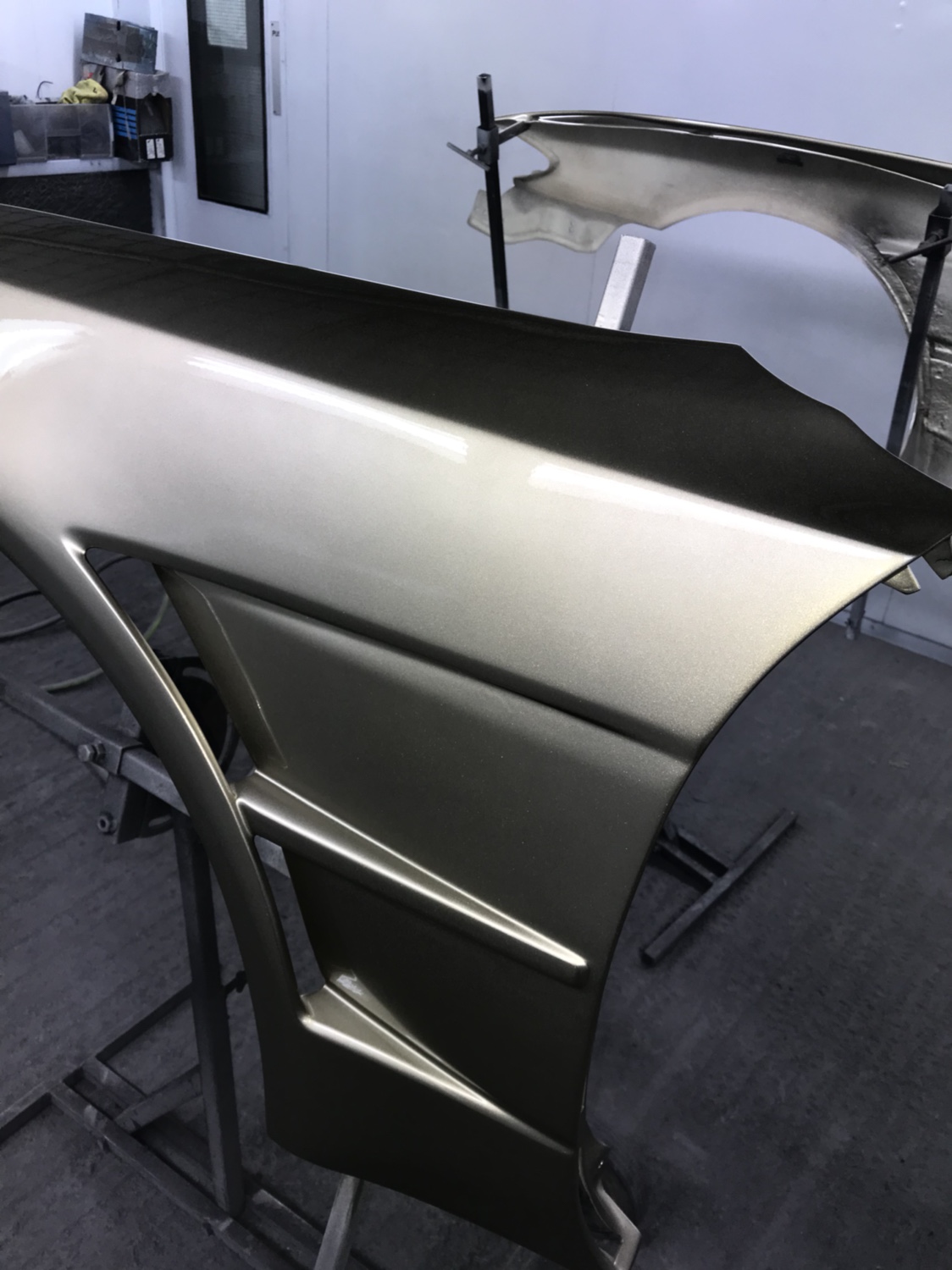

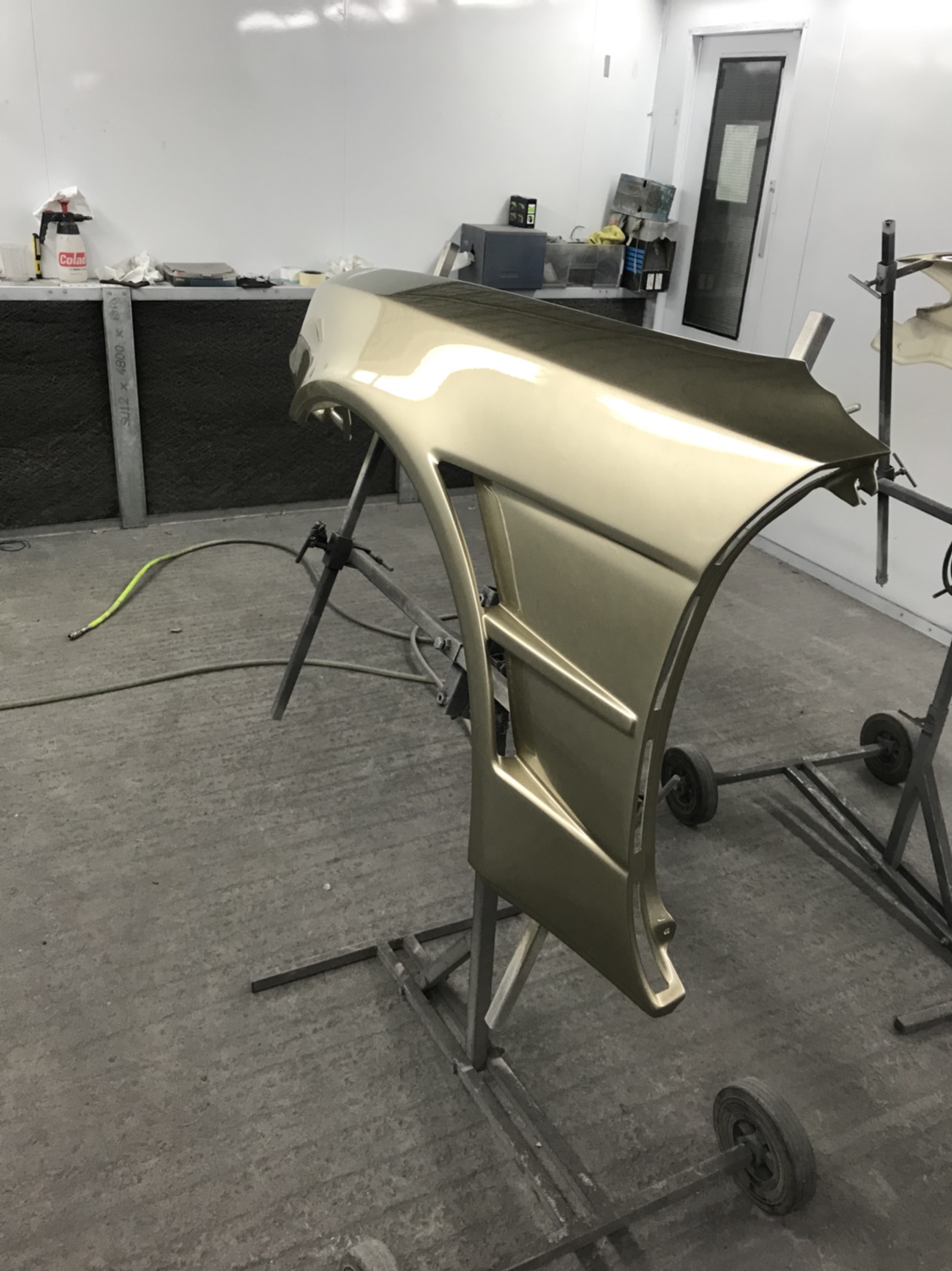

Painted the first parts of my car mainly to double check I was happy with the colour
I think it’s going to be bloody awesome
Car should be paint jan Feb time and back together for next years shows hopefully
