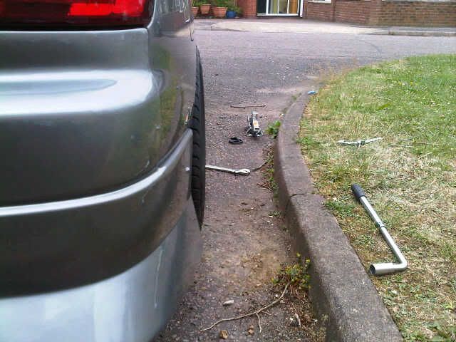

right got some pics,proper weird what happening here lol
put the rears on now too and the back pass sideis stickking way out compared to the drivers side,think i may need to get my allignment done,hopefully that will sort the issues i am having. fingers crossed!
Do you have a lot of clearnance on the fronts normally at et30?this is literally mm at the most lol rears there is a load of room

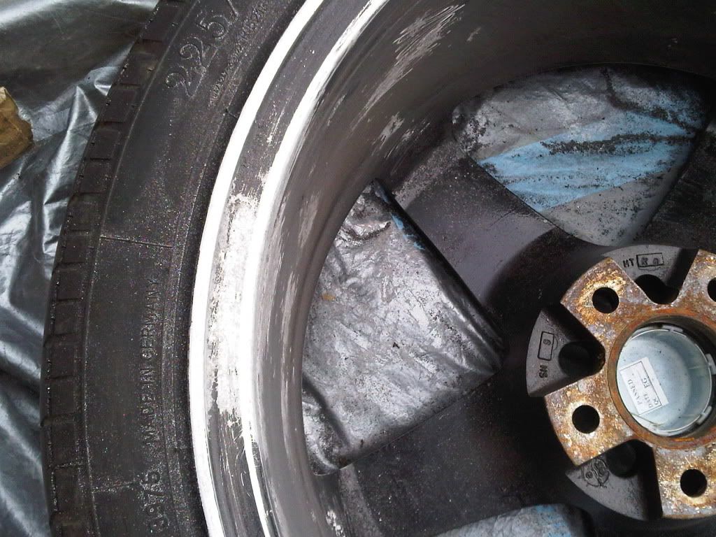

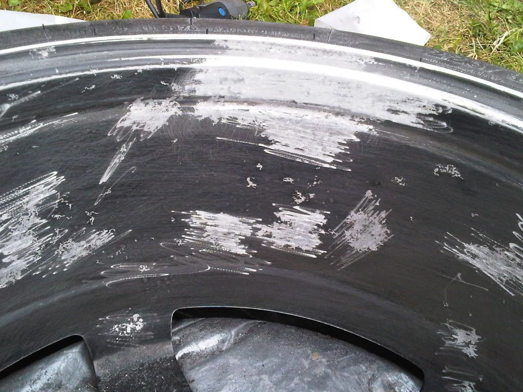

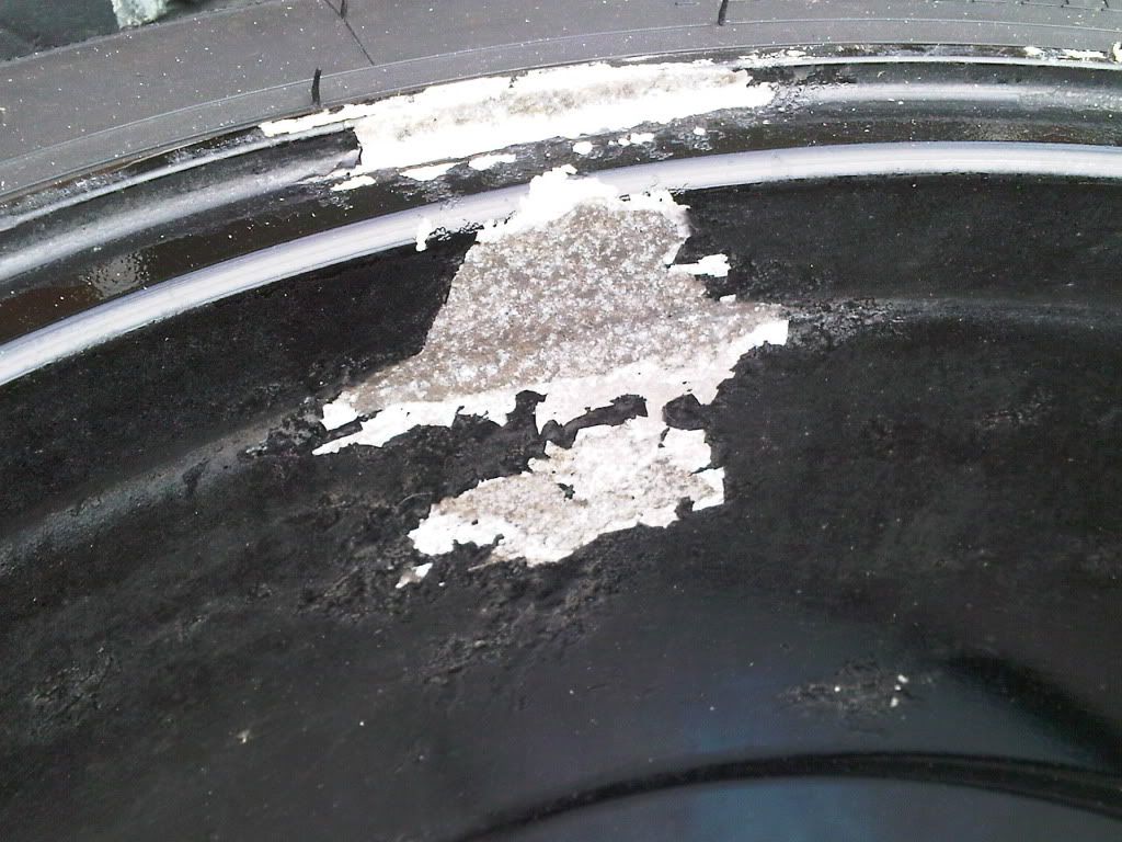

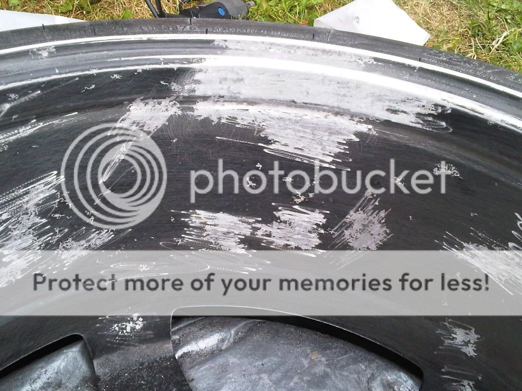

so anyways,this was what i was confronted with when i went to do a little touch up,
the paint was all peeling away so instead of a quick touch up decided to get stuck in

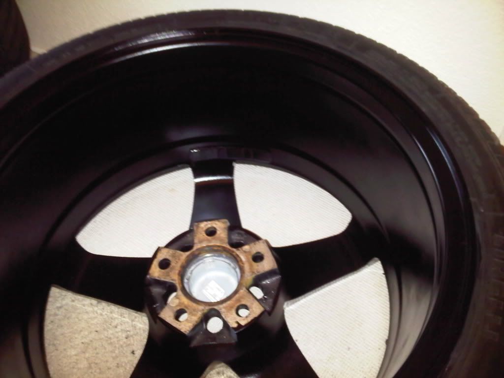

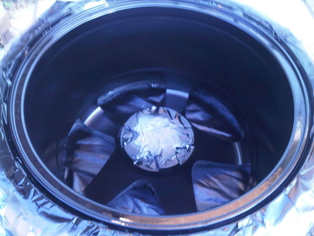

then gave them a quick prime and painted them gloss black again for now,will redo them in the near future when i have decided what colour i want them
was a bit of a mission but was worth it they came out alright

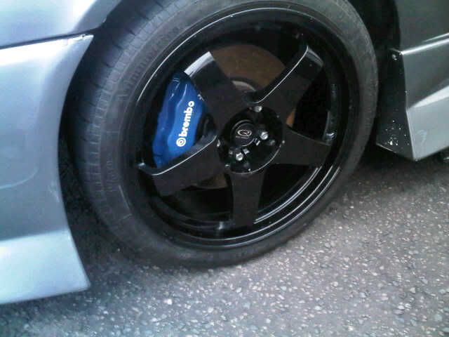

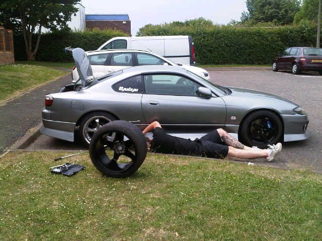

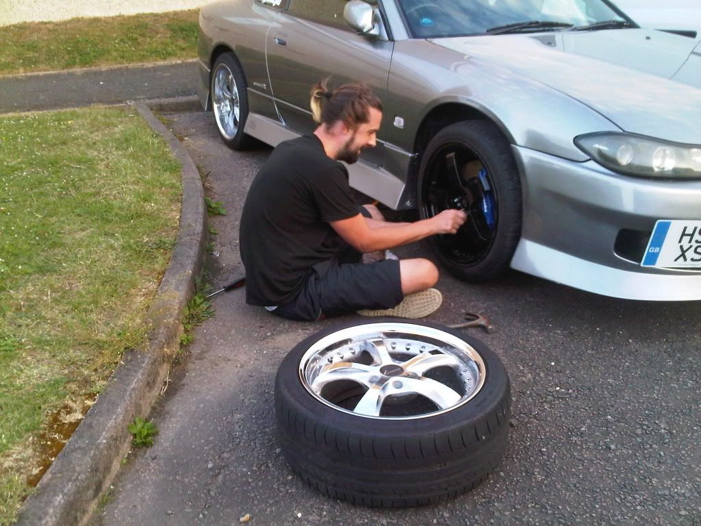

then came the fun bit ,or so i thought till i got em on there:wack:

8.5 et30 normally leaves you with about 5mm on the front with the teins - i know they do with mine....go for the smallest spacer you can get away with or you'll be scrubbing out the tyre top edge on the arch lining. can't see the pics as i'm at work but progress sounds good :)

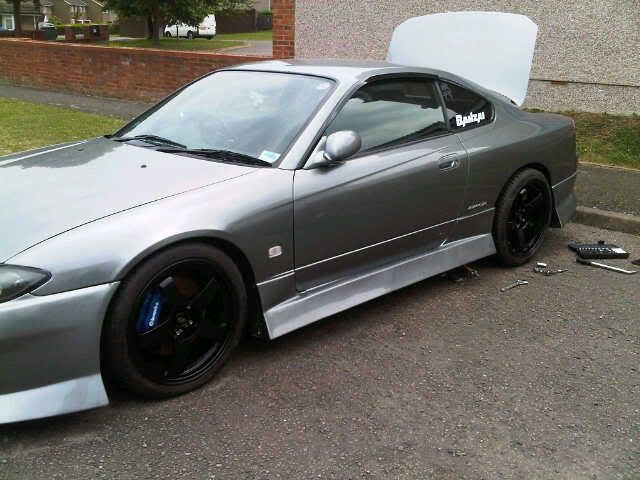

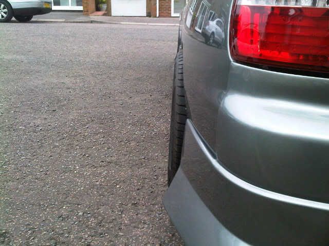

as you can see the left side sticks out a lot further than the right hoping that allignment can help if i tuck em in a bit.....

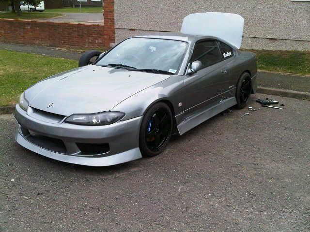

can see the pics now - those wheels suit the car much better and once the alignments all sorted and they're on then it'll look great :)

Black on grey ftw :D!!
The car is looking good, mate.
