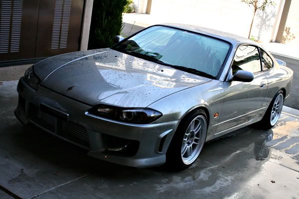

Latest UpDAte:
New Track wheels and Aero front Bar... Take a look :cool:
:thumbs:
Stay Tuned
S1Five
damn that looks hot RE30!!!
thats a very aggreesive offset on the fronts but looks good
thinkg i hav to get them too for track now! wot size are the wheels?
P
Paul2x
Thanks for the comments Guys,
Not the Volks , they are Enkei RPF1's
Front: 17x9
Rear : 17x9.5
right now in street trim (street tires) , b/c I have my R-comp' tires on another set of wheels and the R-comps won't clear until my new front fenders come in.
Had to rock the aggressive offset up front to get the "concave" face up front, but it's only way to run them IMO. =)
Running 255/35/17 Nitto NT01's Front and Rear, mabye 265 in the Rear if I can.
I wanted the same set-up "MCR" uses on their shop S15.
I contacted them , then made a few changes to their set-up and their you have it. =). :thumbs:

Paul2x
Thanks guys,
Like mentioned, these will be my track wheels mainly b/c their really light for the price.
I threw them on the scales too before i mounted them.
Front : 16.2 lbs
Rear : 16.5 lbs
Thanks again for the kind words.
Stay Tuned, More to Come :)
:thumbs:
-P
