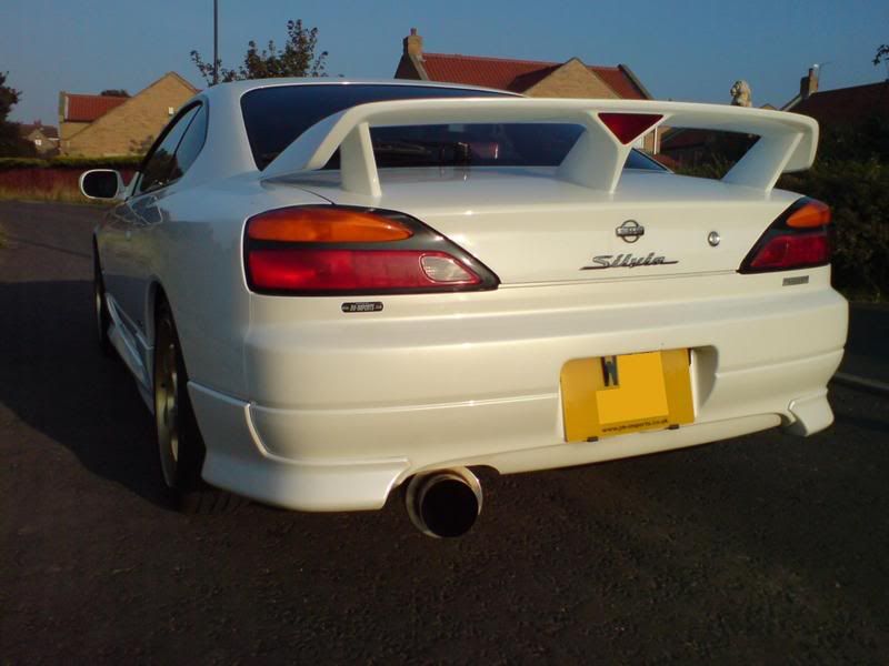

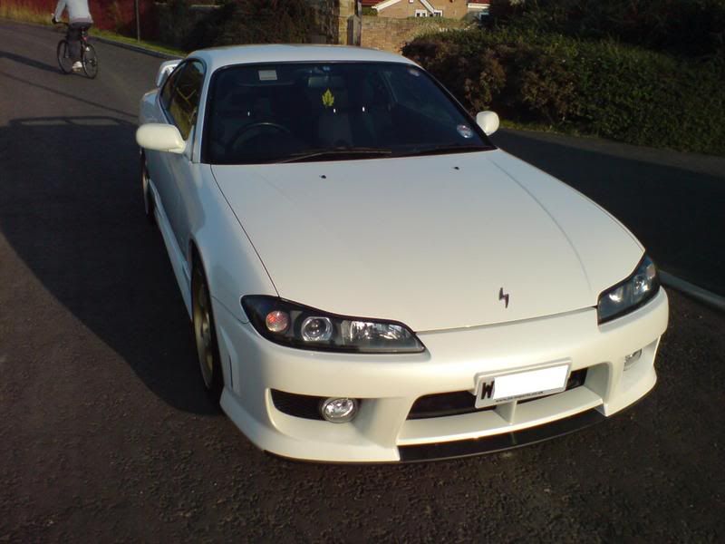

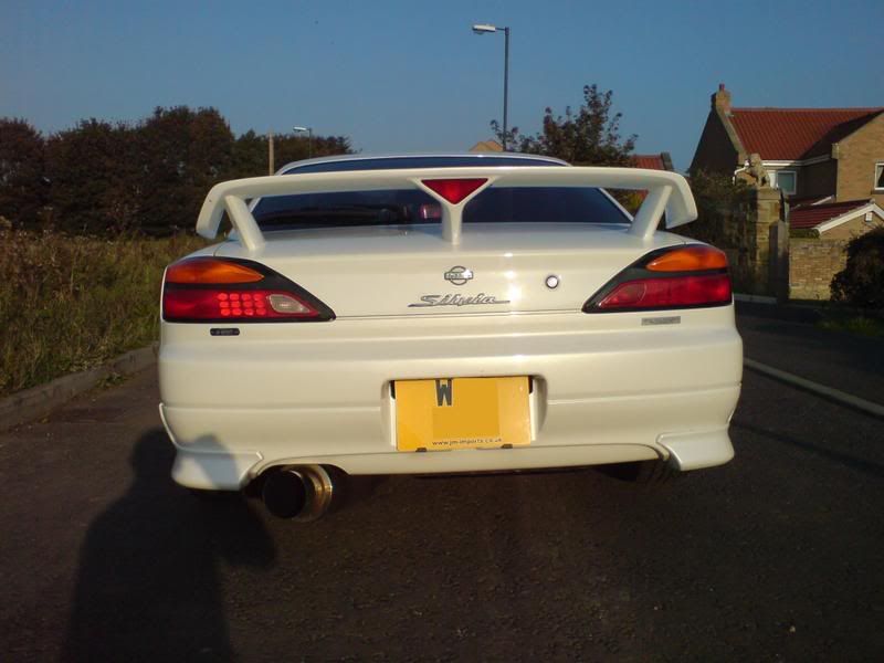

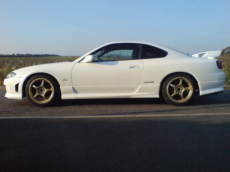

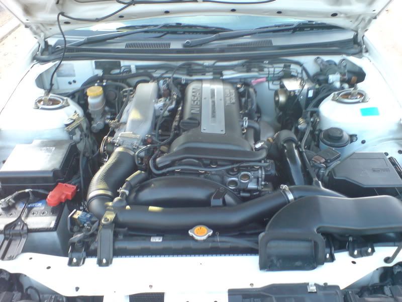

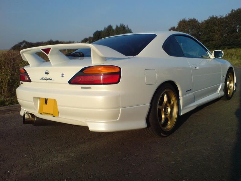

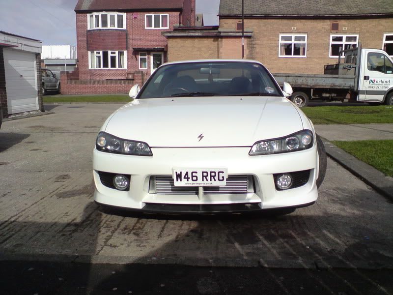

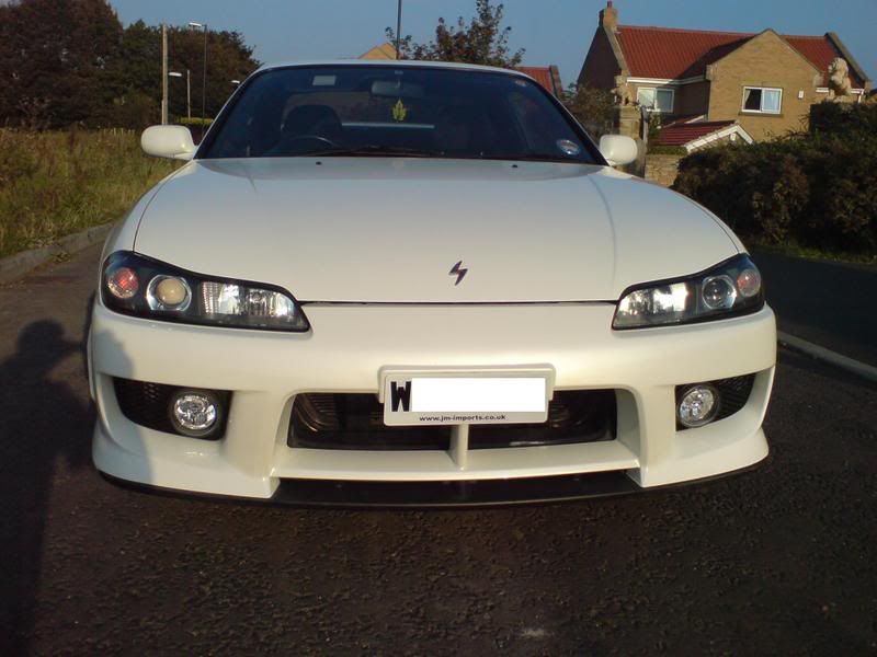

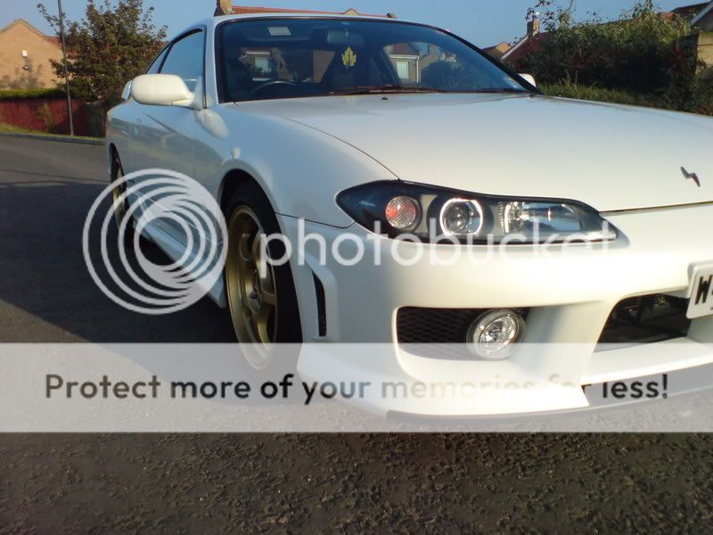

Here's some new pics of my car after a long day cleaning it!!!
Spec...

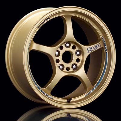

Rays wheels 17inch
Kei office coilovers
unknown make exhaust m/secion and b/box
HKS EVC

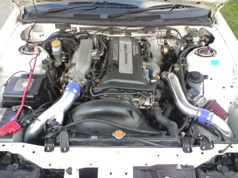

Fitted New coilovers on wednesday night. It took me 2 hours in the dark which was alot quicker than i expected!
I decided to go for the gen 2 apex fast road with 6/5 springs and all i can say i wow!!! The ride is still firm but rides the bumps really well, definately the best ?500 i've spent definately recommend them.
Or and fitted an apexi intake which makes my car flutter now, shame its still quiet

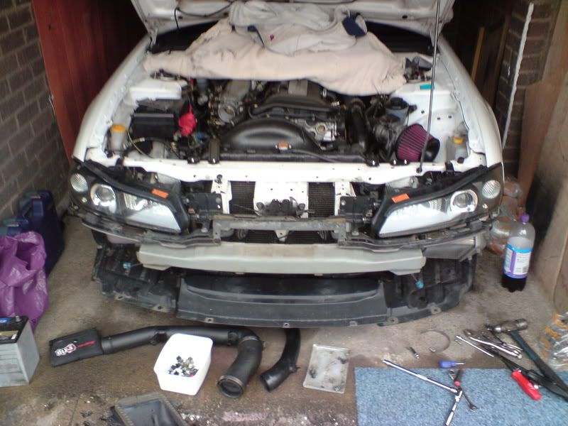

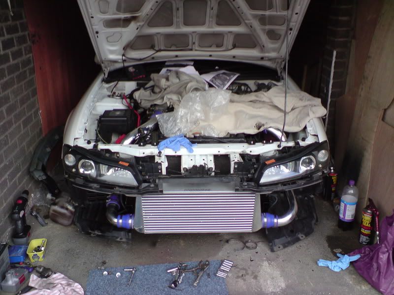

Here's a few pics i took when fitting my fmic its the autobahn88 one. Anyone thinking of using the clamps that come with it all i can say is don't!!! Im ordering a dif set then gona get them fitted instead.
The parts i had to modify was the undertray and cut the hole in the battery tray. I trimmed a tiny but off the front bar for piece of mind but it didn't really need it. I managed to lengthen the +ve battery wiring in the fuse box and use the original battery in place aswell :D
One thing i did to keep the fogs was to fit enough washers to lower the intercooler 1 1/2 inches and it fitted first time.
The only thing thats worrying me a bit is that the aero bumper is touching the pipes near the fogs.
I still need to pull my amp cable back through so i can reroute it properly in the engine bay
