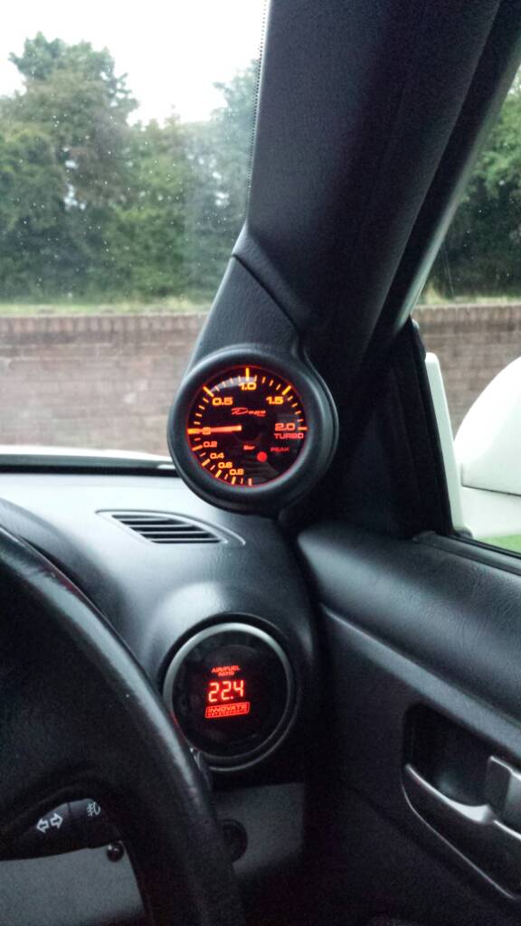

A pic of the new gauges fitted them myself then sent it to slide motorsport to put the sensor in the exhaust.
Afr is around 11.2-11.5 on boost so all is good

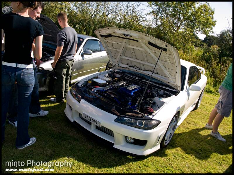

Googled my reg and found this from a JAE meet 7 years ago! Anyone know who the owner was?
